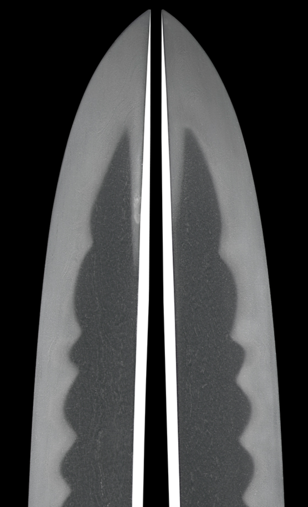

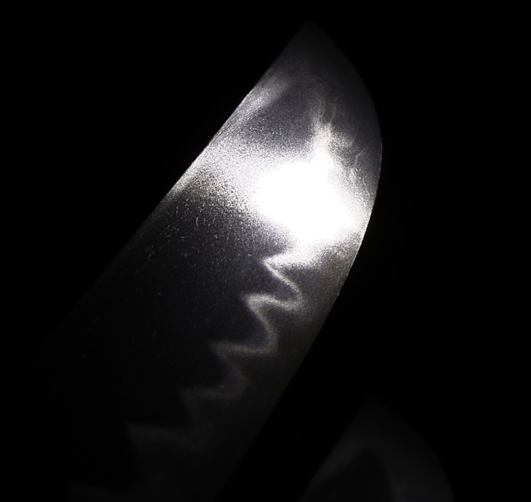

I also struggle to shoot swords but one thing I've noticed is that to "see through the hadori", you need to shoot the sword sideways.
The hamon is the whitest when shot this way.
While shooting sideways will show more details of the hamon.
Pictures from https://www.aoijapan.com/wakizashisunnobi-tantoise-tamaru-junin-fujiwara-nagatoshi-saku/
Edit: I'm thinking that maybe the first picture is not a photography but a scan of the blade. I know Aoi's photo setup has been discussed before but I forgot what was said.

I was thinking about scan too but it' very strange as the work is perfect, and not blurry, most of times, scan are ok with flat piece close to the glass, but as there is relief, 3D shape, as you get away from the glass, it's getting blurry.
So my guess is more a photography.
I saw their 7000 px long pictures are in fact 3500 px long pictures, far easier to take, I will make attempts, it needs a high light box with a hole on top to the camera, a black background under the blade, and some white and black reflectors, whote for mune to put it visible, black for shinogiji to put them dark, that was the process I made for my blade, also not put the blade parallel to camera, but a very bit off, so the hamon gets lighter through the hadori, and also, much easier to get the black shinogi ji, as the camera and black reflector are not exactly on same axis.
most easy would be light box, with white walls and completely black roof and floor, mains issue is the focal lenght, if I use my 180mm I have to get about 4,8m away from blade for a full picture, and using the 85mm I still have to be about 2m away, if I use the 50mm, the shape will be really off.*In this specific cas the eos remote function can be very useful!

I found the post: here. The 7000 px are apparently made possible by the use of a very high resolution camera (Hasselblad).

I took a look at 100% on the aoi Japan,one pixel is four pixel, making the real size half the actual file size.
Easy to see when displayed at 100% you can see large pixels, and once you make a 50% display, you get full resolution.
Btw the informations on your link are very interesting.
