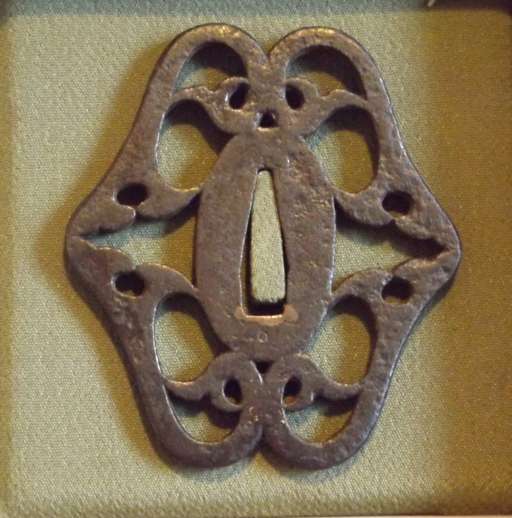

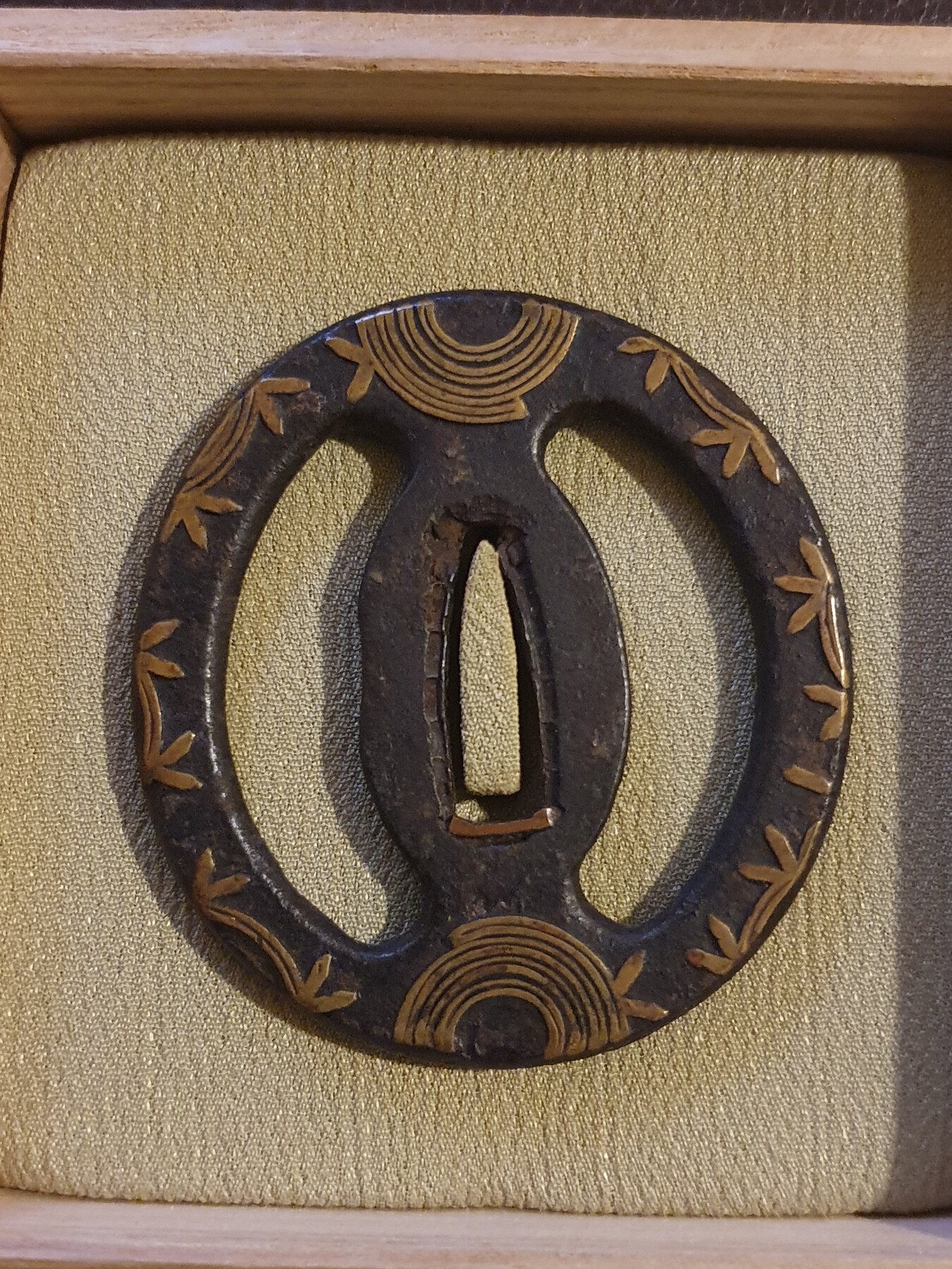

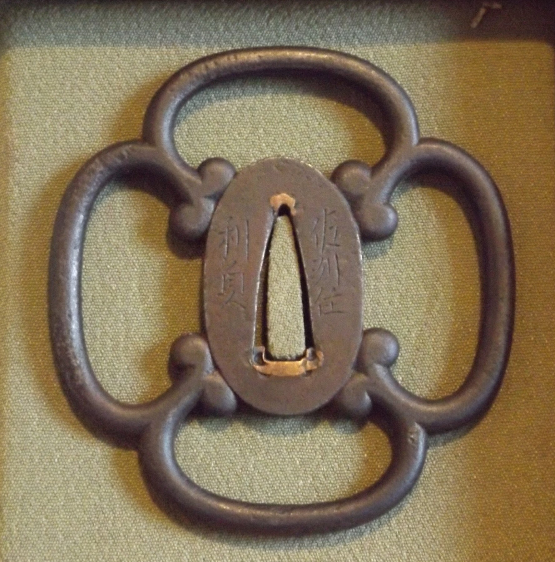

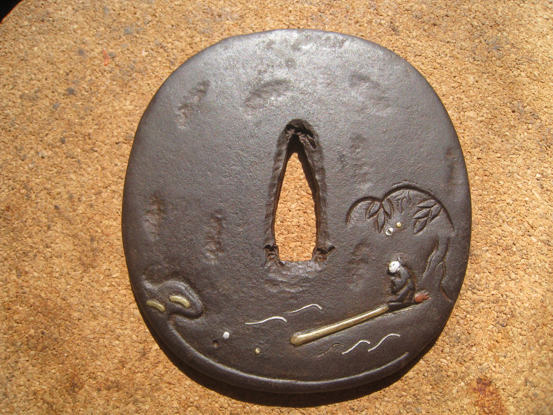

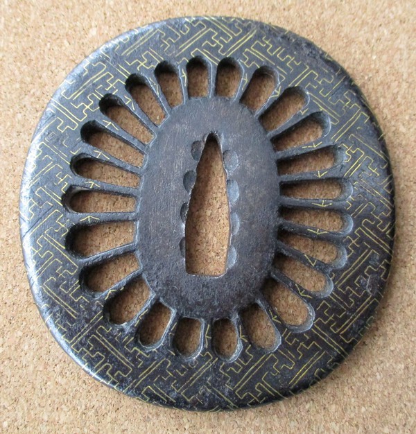

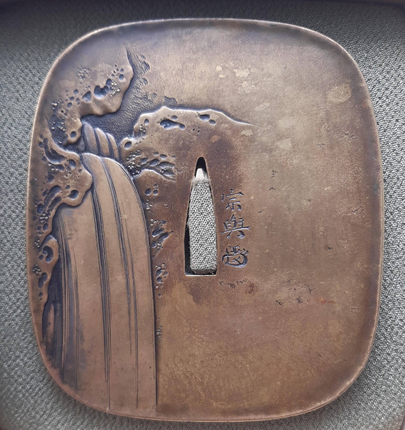

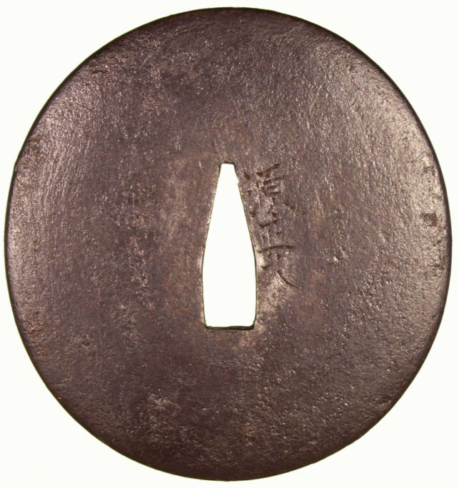

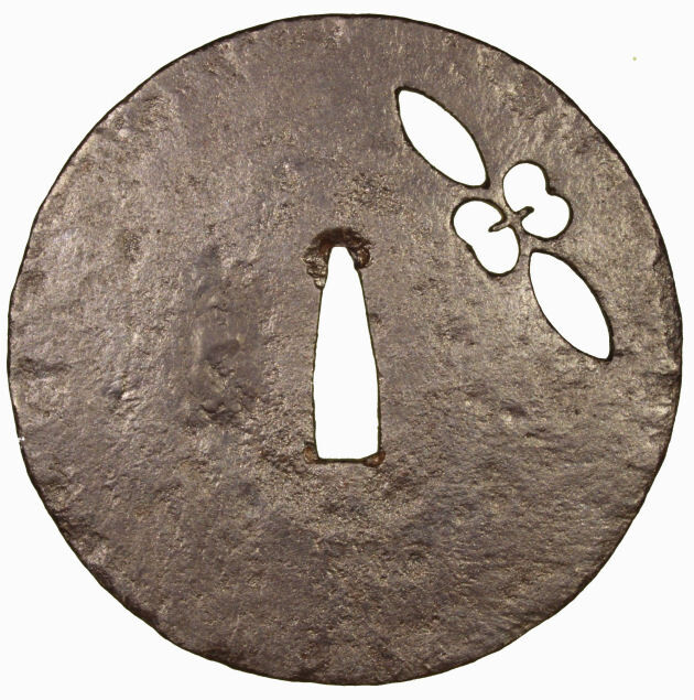

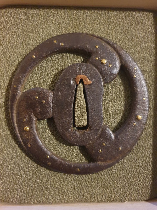

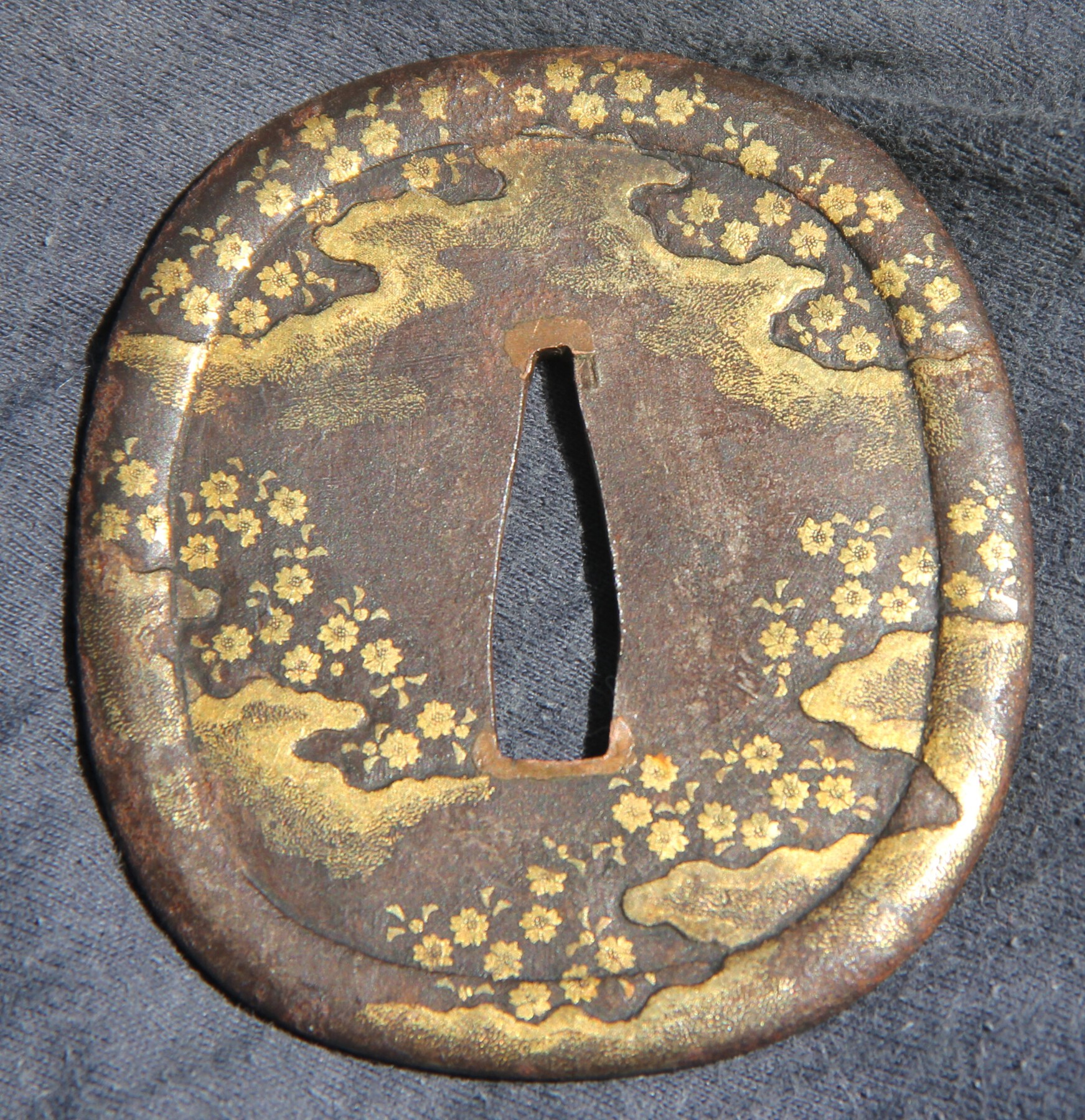

mu-hitsu-ana tsuba in my collection:
1 kawari-mokkō-gata signed sandai-me Myōchin saku
2 Daruma zu tsuba signed Enjuken Hirotoshi sei, possibly Meji/Shōwa jidai
3 dragon in katakiribori, signed Jakushi (?)
4 karakusa-mon sukashi tsuba, with NBTHK attribution to Myōchin
5 kasumi zu (fog), Heianjō-zōgan
6 karakusa zu, Heianjō-zōgan

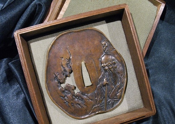

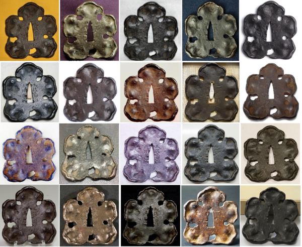

I see a few cast pieces and modern reproductions being posted, Daruma in his cave comes in lots of fake patina colours. As does the 'Tosa Miochin'  post-2065-0-14924100-1563143714_thumb.jpgimage.thumb.png.6af3076f3ee79a37d8d6d211d55bb2f9.pngpost-3006-0-08417200-1563136992_thumb.jpg

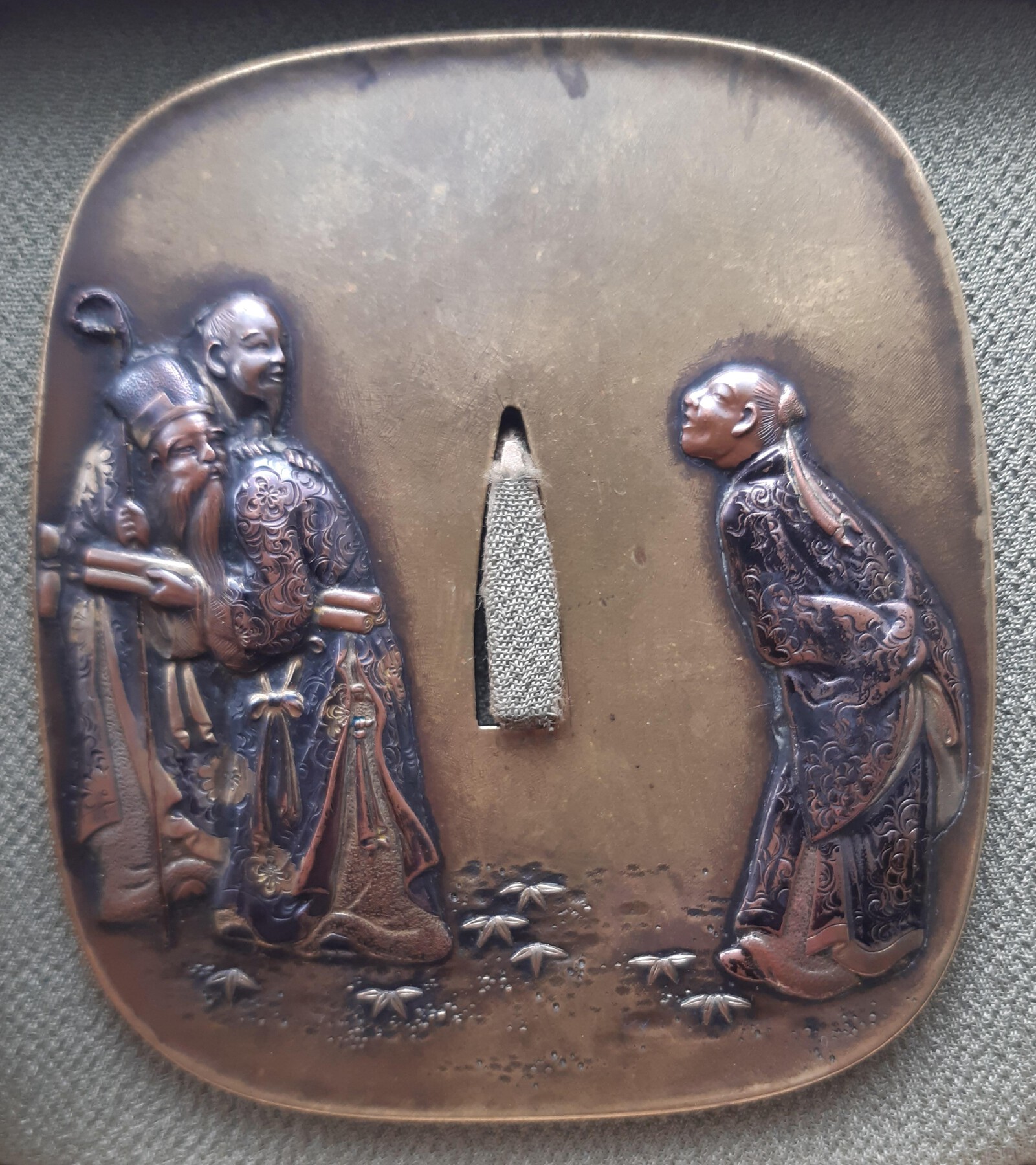

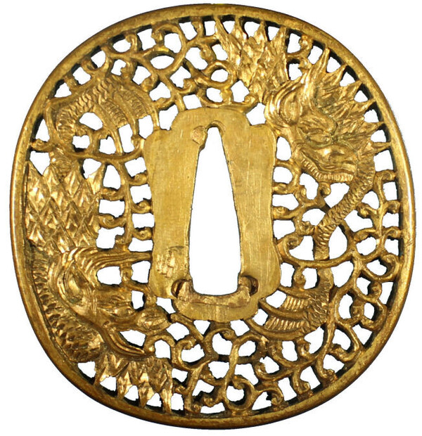

the copper seven god tsuba also looks suspicious to me.
The imgur link I just see some code and letters .I really like the nanbam tsuba.
This one I have is very strange, two holes on each side have different patina on outer side, easy to see some metal piece has been attached, like ring or chain maybe, very strange.
Share this post
Link to post

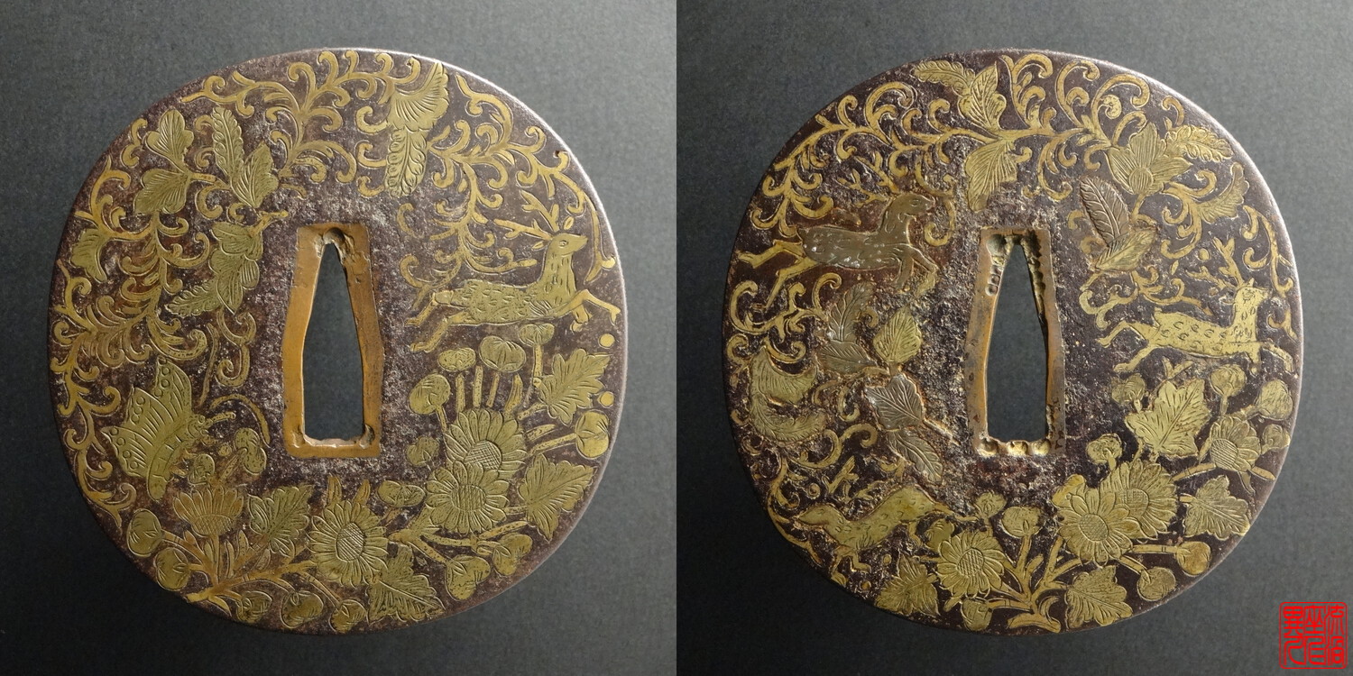

makes me think of many high level casts we see sometimes here and there, what is suspicious is the black and gold color process.
I saw some meiji era cups, trays and other high quality engraving like this and the gold silver and other color are always solid inlays or foil plating process or at least mercury gold plating, and that tsuba has nothing like this on it, very suspicious.
I remember such a suspicious cast some month ago on the forum, some said it was legit, ford included, I didn't put a comment, s it's not easy to put comments of that kind here.
But some weeks later maybe, I don't remember,  I found the exact copy on yahoo, signature every pinch detail exactly the same, so I put a comment.
I also saw a rooster tsuba on ebay, looks the same, electroplating, patina on copper base, like used on modern iaito fittings (except gold plating)

Setting problems to one side there are none the less some really nice things being shown.  I am particularly drawn to No. 4 from Mauro, that lovely Namban and not a few from Grev's post, not to mention the original selection from Patrice..
Of course the Daruma tsuba is a casted piece, as most if not all bronze tsuba, and it's quite modern in age. Does it mean a  "fake" tsuba?
