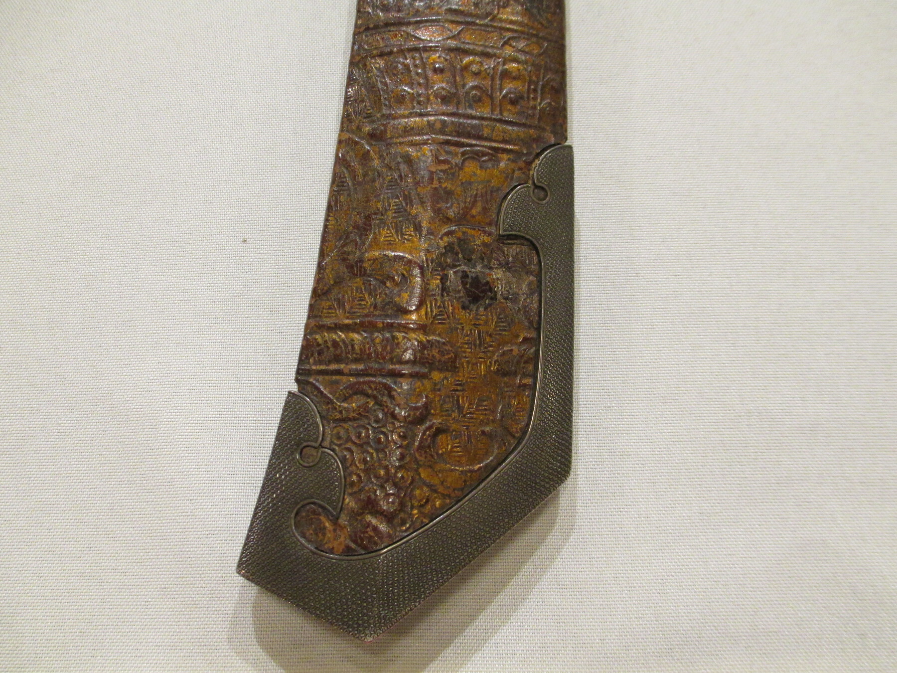

I will attached an image I have been permitted to attach to this discussion. This is a snippet, but it really looks to me like it was not made in Japan

Firstly - the whole leather situation. Japan was in fact a large user of leather despite the fact that the raw skins and the leather workers were regarded as unclean. Several native sources were used including deer and horses but the supply was totally inadequate and hides needed to be imported. Quantities of buffalo skins came in from China and SE Asia that was converted into rawhide or nerigawa. Sakakibara  Kozan states that that produced in Nagato and Suwo were best. In 1604 and 1635 it is recorded that some 250,000 deer skins were imported from Siam and Cambodia (Yoneo Ishii,  www.asjapan.org/web.php/lectures/2002/04). Large quantities of rawhide, including that made from buffalo skin, when suitably lacquered, was used in the making of armour. as did deer skins. It seems that when processed into something it was no longer defiling. A softer white leather was a speciality of Himeiji. Deer skins were first washed in the local river and then dried.The stiff rawhide was then treated by trampling with rape seed oil for hours to give the soft white leather. This was then usually treated in three ways: firstly by smoking to give fusube gawa. This involved fastening the skin on a drum above a small furnace in which was burnt either straw or pine needles. The former gave yellow colours, the latter browns. The leather could be patterned by folding, binding with cords or pasting paper cut-outs on the surface.  Fusube gawa was mainly used in situations where rubbing could occur such as the linings of armour. The second method was by stencilling to give e-gawa, often in patterns involving shi shi lions amid peony foliage in blue with flowers in red. The third method was to dye the leather.A common pattern, shobu gawa, involved rows of stylized iris leaves and flowers in white on an indigo dyed ground. This was done by carving the patterns in relief in wooden battens and binding them onto the leather wrapped around a drum. When dyed in indigo, the wood patterns prevented the dye reaching the leather under them giving a white pattern on the blue ground.
See: 'Leather in Warfare' edited by Quita Mould, Conference proceedings, Royal Armouries ISBN 9780948092763
I forgot the cuir bouilli bit. In reality it was just moulded rawhide. To make a helmet or mask, the hide was stretched over a wooden block carved to the required shape and dried. Where the leather needed to be concave, small nails were hammered in. When fully dry and translucent it then underwent a long lacquering process to prevent it absorbing moisture. For helmets, several shapes were made and nested together, either glued or sewn with rawhide thongs. I have one such helmet which has 4 layers of hide making up the thickness. Provided the lacquer kept the moisture out it made excellent armour, but if cracked, the hide swelled and soften and the piece was ruined.
