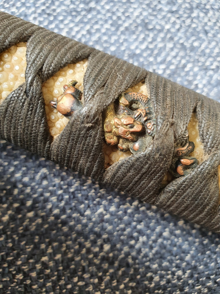

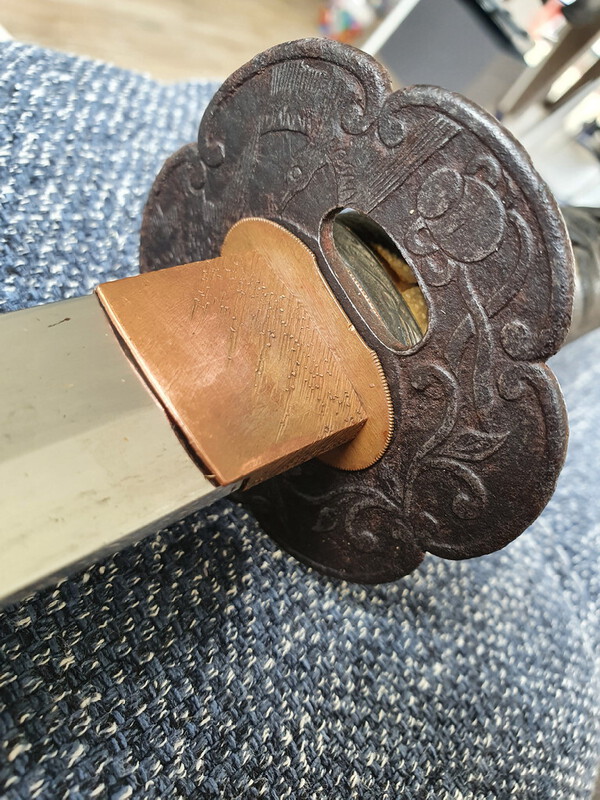

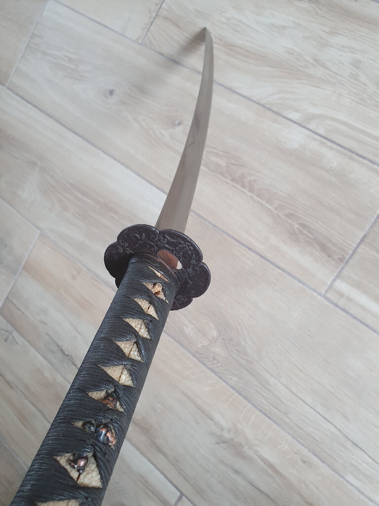

OK it is just about a katana as its over 60cm.

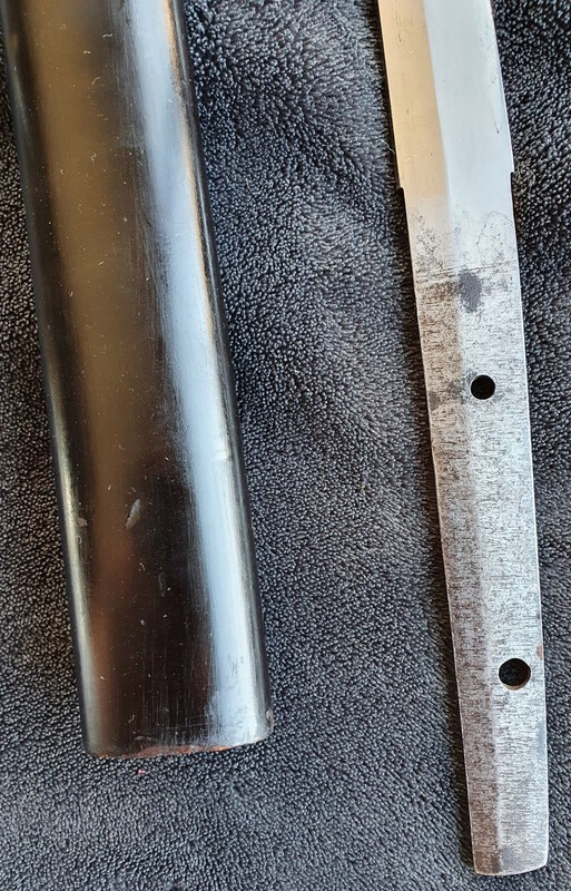

Its been shortened and the finish on the Nakago jiri and the two mekugi ana back this theory up.
It does not appear to be signed.
There is no way anyone can see the hada or hamon in those current images and I worry its been sanded over so all detail is lost.

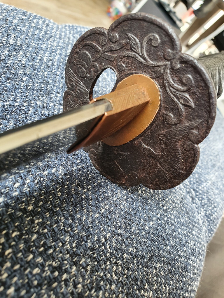

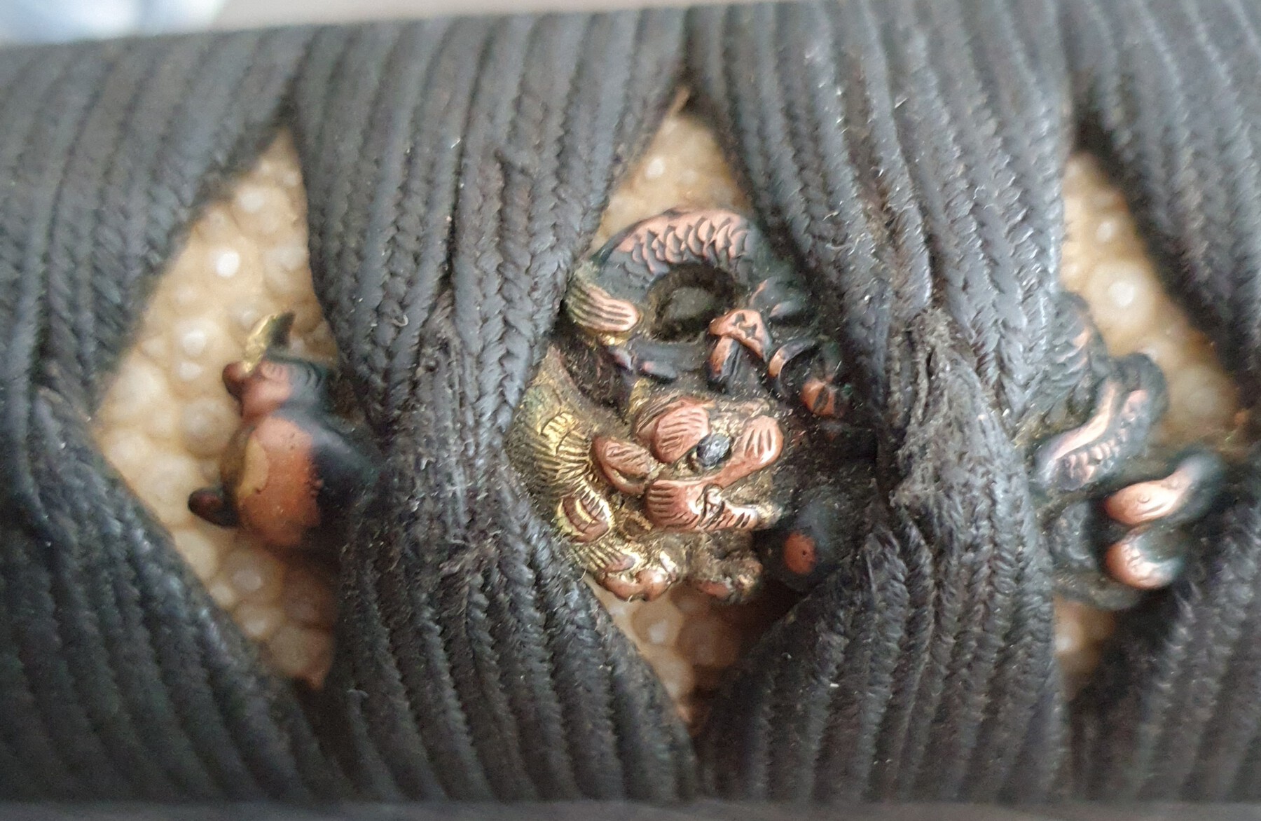

The fitting (and I mean no disrespect) are very mediocre and of relatively low quality when new.

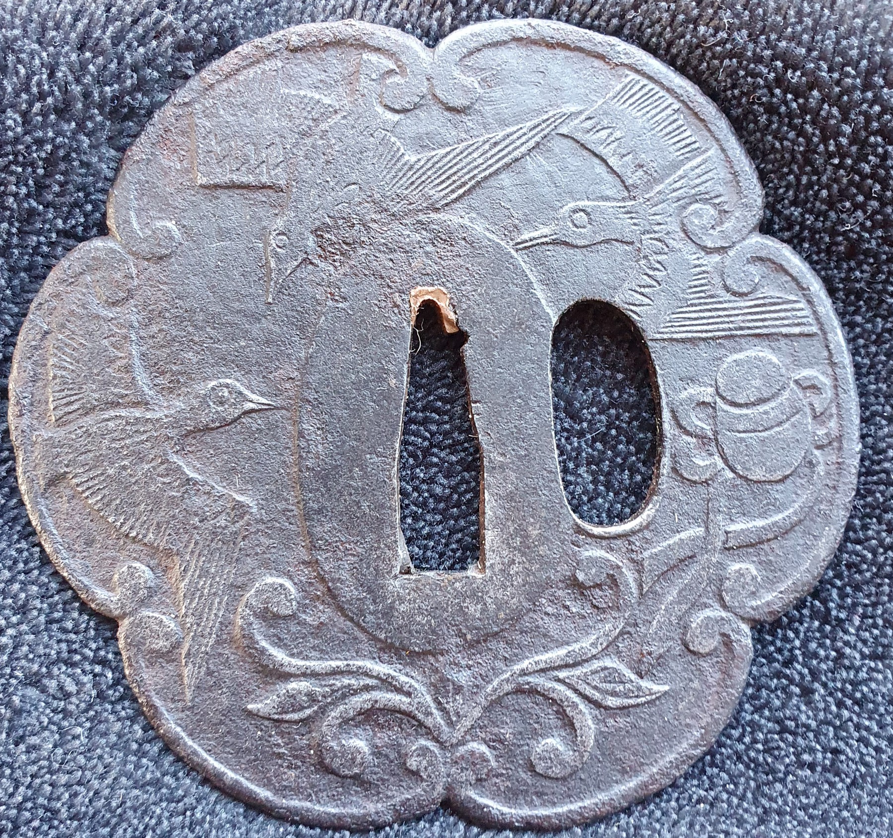

I am not convinced that the tsuba is not cast iron hand finished.
It's really important you take a picture of the blade on a towel on the floor at midpoint so people can see the sugata.

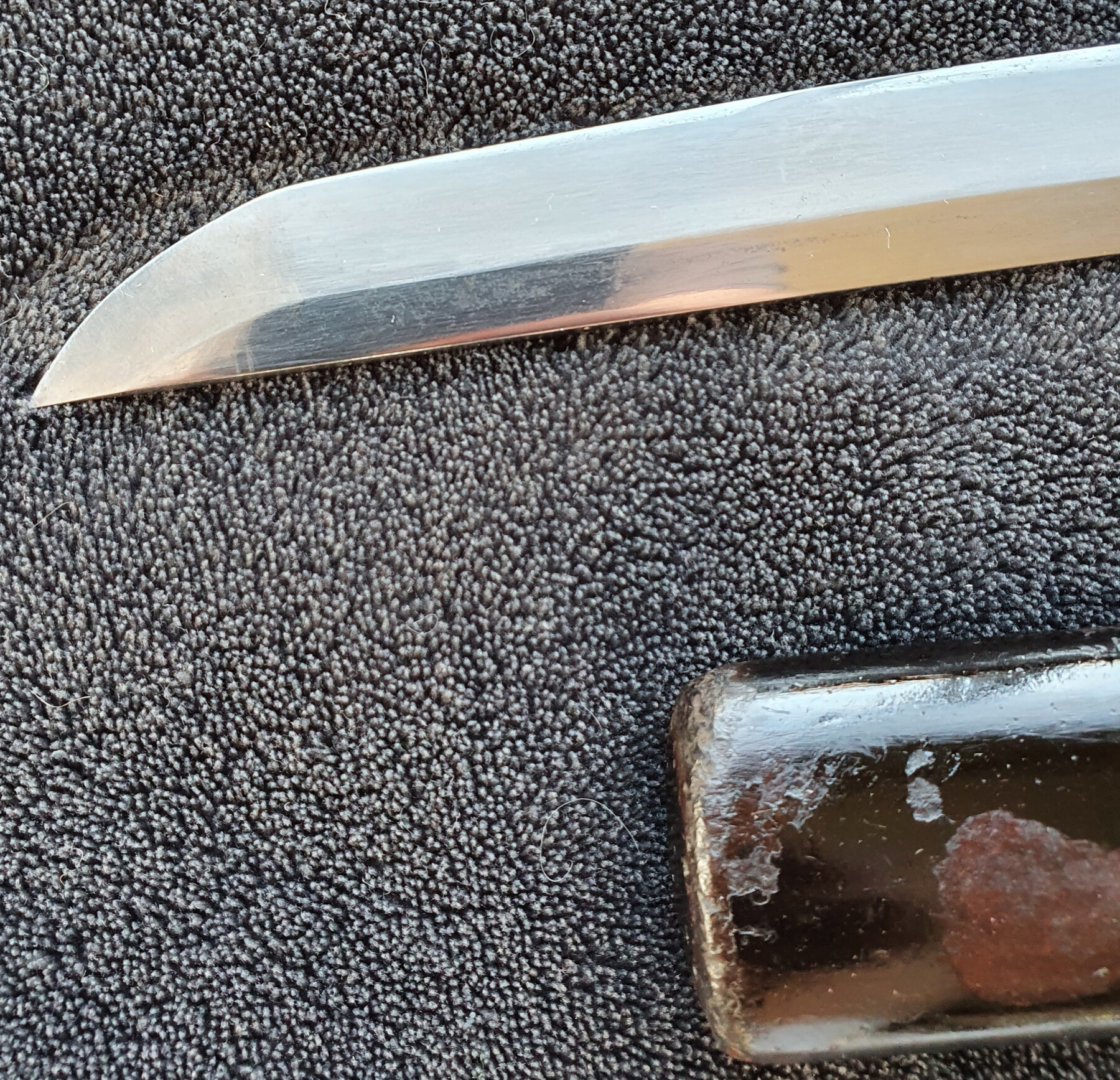

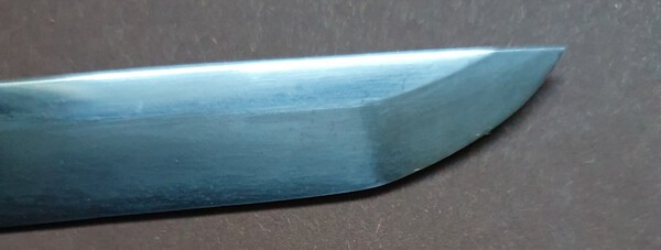

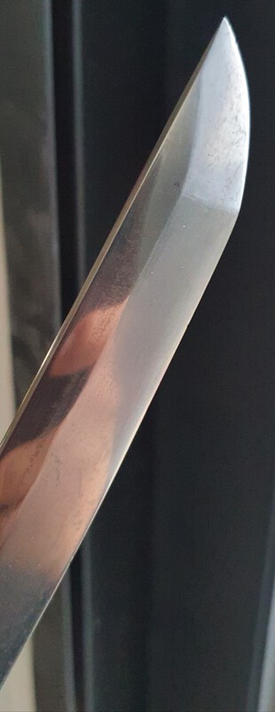

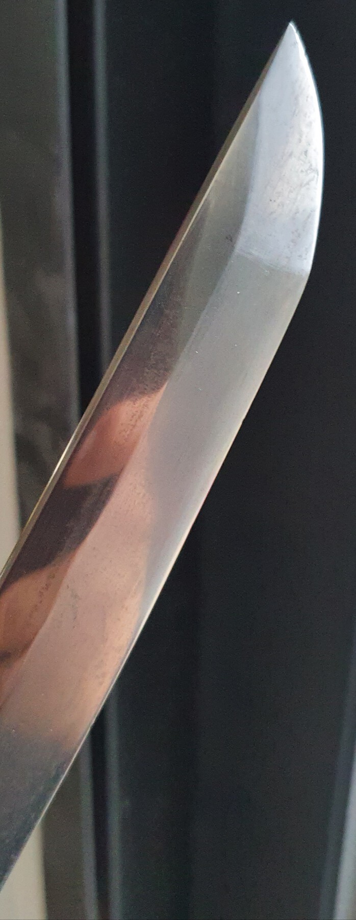

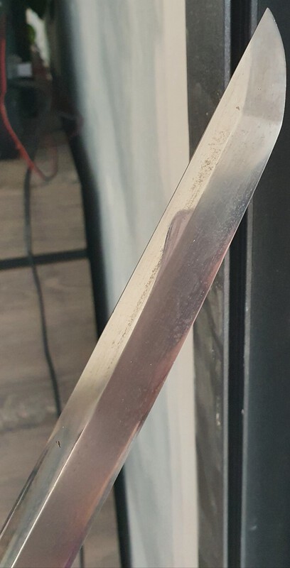

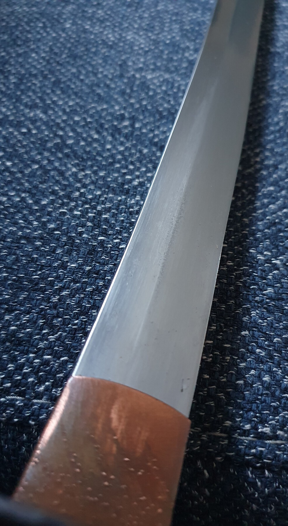

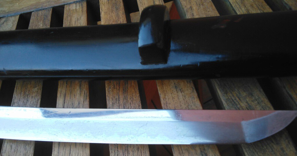

It's still pretty hard to make out any detail. For me, the blade looks like it might have something of a Kanbun sugata (straightish, smallish point, some taper) so that would put it mid 17th century. Beyond that, hard to tell as someone has used an abrasive to "clean" the blade and obscured the detail in the hamon and hada and removed the patina from the tang. That there is no obvious loose grain visible in the pictures might point to a later rather than earllier attribution.
Share this post
Link to post
My initial impression. Koto because of the smallish kissaki, what appears to be o suriage (greatly shortened), and straightness at the top of the blade. The handguard looks like Kamakura bori, although the design is atypical. It is cast - maybe?
Share this post
Link to post

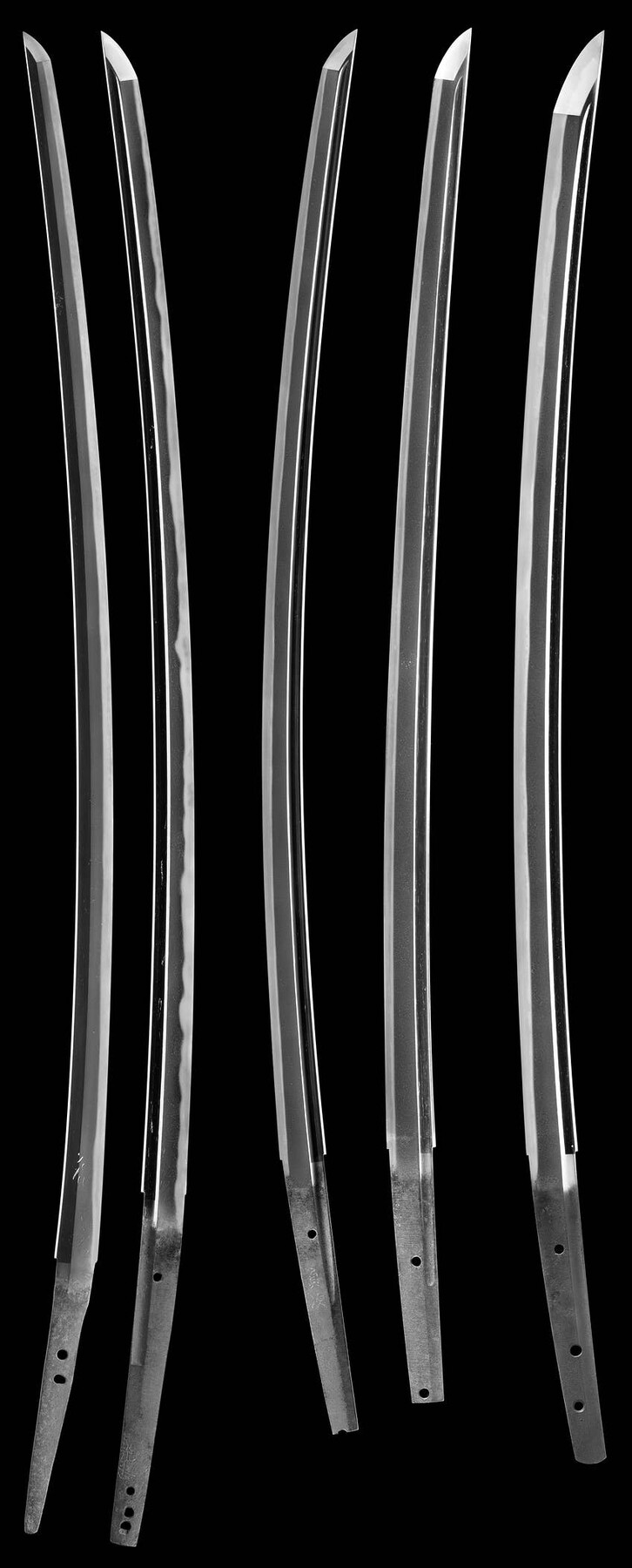

Steiner, seeing a shiny finish doesn't really allow any detail. Take a look at Ray's photography on
Can you see how he controls the lighting to show the blade's hada?

It looks like a midare but it's really hard to see.
Hada you won't see until polish and even then not always.
Share this post
