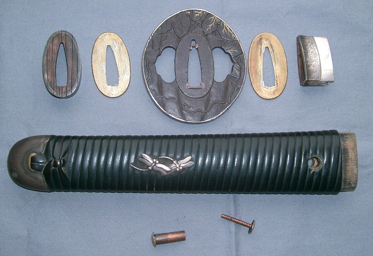

Dear Mike.
If I read your question correctly you want to understand which way around the seppa are fitted.  Usually there is a witness mark, minor denting where one seppa sits snugly against the habaki.  The seppa you show has been adjusted as Dave says, not common to need that much adjustment so it might be a seppa that has been added to complete the mount.  The planishing marks, (the dents)   should fit against the tsuba so that they are not visible, they are not for the habaki to fit.
Here is a picture that might help.
Hope that helps.

Couldn't have said it better Geraint.  Mike, Geraint is referring to the seppa on the right.  You see how there is an outline where it supported a habaki and the habaki dented it?  Also, you can see that some of the tarnish from the silver has rubbed off onto the seppa.  Babu, please forgive me if this is "obvious".
