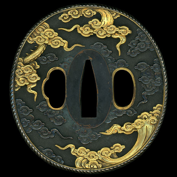

Hello,
I was wondering what people's opinions are on this tsuba, I've seen some poor reproductions of this design but to my (untrained) eye this one actually looks pretty decent and has some nice detail. I know it may be risky to purchase a design that has been copied a lot but there must also be some good utsushi out there as well.

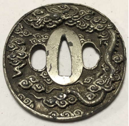

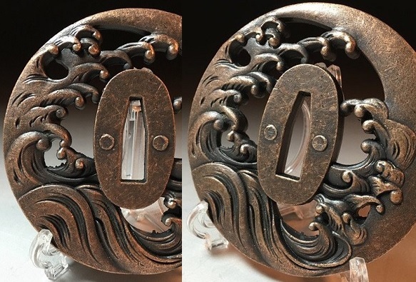

I've attached a couple of images of tsuba with the same cloud dragon design, one is obviously a very poor casting but the other, although still obviously poorer than the tsuba I first posted, is a better quality casting with nanako. These reproductions and castings are based on an original piece and some Edo period utsushi can still be of a very good quality, but do they put doubt onto the original piece I posted? It seems very tricky to be sure.

Yes Tom. It is now on sale at the auction. At first glance, Tuba on the left and right looks different.
However, please note that the layout and size of the patterns are the same in both cases.
Actually, both items are familiar to Japanese buyers. Only the newcomers or agents have a high bid on the left tsuba.
Yas
Share this post
Link to post
Thanks Yas, it's good to see them side by side, I agree the patterns appear pretty much identical but there are still differences such as the rim and in the quality and in the detail of the carvings.
There seems to be a sliding scale of very good to very poor within the reproductions which are all based on an original. Perhaps the left one is a hand finished early reproduction, which explains the price it went for or as you say just a newcomer with a big wallet, I guess its hard to know.

Thanks for your opinions, to me the quality in the carving of the dragon and the rim of the initial tsuba appears much better with a lot more fine detail and the mark on the top left seppa-dia is in a similar location but appears different. If it is indeed a modern casting, which I'm not yet convinced of, I think this highlights just how difficult it can be to identify a quality piece.

Yes, the tsuba in question looks better than the others, but, in my opinion, it is just a better job of copying.  I agree with Yasaka-san that this tsuba is a recent copy made by modern manufacturing techniques.  Consider the following and let me know what you think.
The divot on the upper left of the seppadai looks just like the divots that I've seen when sprues are broken off of castings (sprues are the channels that feed a molten metal casting and when the metal solidifies, they look like thin rods attached to the casting).  Sometimes when the sprue is broken off (instead of sawn off cleanly) it creates a divot (depression) with the center being slightly raised like a reverse volcano.  In each casting, the sprues are individually placed so the sprues may be in slightly different places from one casting to the next.  So that's why it may look different than the other sprue marks on the other cast versions that Tom showed.  Take a look at this picture and let me know if you think it might be the remnants of a sprue.
In many places on the Tsuba, I see what appear to me to be casting or molding bubbles ("positive" not "negative" bubbles).  The nanako appears "stretched" in some places which can happen when using wax and/or rubber in the molding process.  Finally, there appears to be lots of "clean up" from faulty molding (whether cast or stamped). For example see the "blob" in the picture below (circle on the right) behind the tail of one of the clouds (there are about a dozen cloud tails on the Tsuba and only this one has the "blob" behind it - so I do not believe that it is intentional).  If it were carved (instead of being cast/molded/stamped), the maker would have fixed this area.  Instead, they simply painted gold over it to hide it.

I didn't catch that extra gold under the tail of the cloud on the bottom George and admit that it looks fishy.  OMG, I have been trying to branch my study out to tsuba from swords, but this is a little scary.  That tsuba looked very good to me, and I might have bid on it.  Cheers, Bob

Some nice detective work George, I'm not used to looking at sprue marks, it certainly looks a lot less prominent than the marks on the other tsuba but I'd have to agree the extra gold under the tail of the cloud looks odd when all the rest look nicely carved, I hadn't noticed that either.
You're right Bob it is a bit scary if they can make modern casting that look this good. Higher resolution images might make things clearer but from these it certainly looked very good to me as well.

One of the scary things about modern vulcanized molding and wax casting is that it can pick up very fine detail (to the level of fingerprints!)  Fortunately, there are usually telltale signs of this modern process (but they are getting harder and harder to detect on the really good copies).  Gold and silver is particularly easy to cast, so watch out for gold menuki and solid silver tsuba.  Homogenous metal pieces (i.e., without inlay) are much easier to do and conceal.  Look for bad patinas and painted on gold/silver like this one...

Dear Tom, I do not see any signs of modern casting on the tsuba in the most recent link that you posted.
I do understand your feelings that the carvings in the original [cast/molded] tsuba looked better than the carvings in the linked, non-cast tsuba.  However, remember that the modern rubber mold [or stamped] processes can have a great difference in definition and quality (as demonstrated by some of the really bad cast copies shown in this thread).  And, if someone is using one of the very high definition casting techniques to copy a well carved tsuba, the cast copy may look better (especially in pictures) than a lesser carved original tsuba.

George,I admire and honor your observations and knowledge. There is nothing I need to add further. I didn't think I should go any further into this debate.
Because at Yahoo auction, a greedy market for sword fittings, old buyers are the product we already know (there are some old ones that buy at terribly low prices, to resell).
However, I would like to add weakly that I have never commented that it is a "casting". It's probably not a one piece casting.
The two discs were made separately, glued together and crimped with pillars at Seppa-dai. That feature is clearly visible in the third Tsuba posted by Tom.
If it's a one-piece casting, Don't need five pipe holes. For a well-controlled casting process, two pieces are usually enough.
A ring is set on mimi to hide the traces of the joint. For more elaborate products, make a relief separately, paint it, and then paste it.
The disjointed parts were pressed or cast, so the rims remained.
But whether my speculation is right or wrong, buyers don't need it. We need already enough to know is that it is a modern product .
