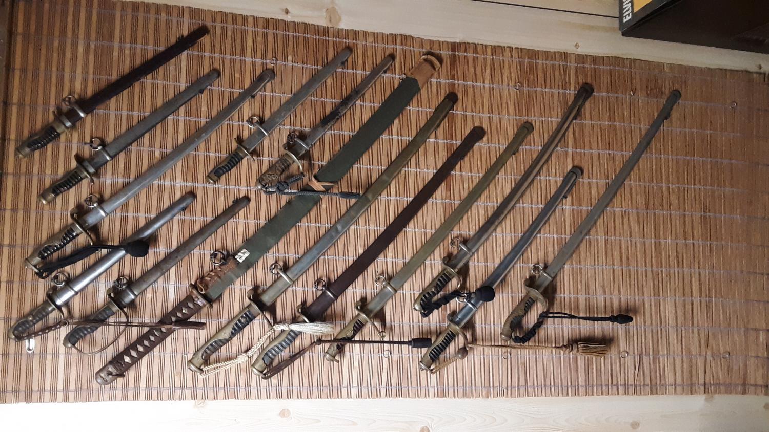

18" !!! So you have a wakizashi kyugunto! Can't say I've ever seen one before!
Hamish, Vajo - ever seen one?
Also, Karen, if you don't mind, I'd like to add your pics to the "Short Gunto" thread.
Short kyu gunto tho not seen often arnt rare. They are around in good numbers but because every ones obsessed with size they don't tent to sell high.
