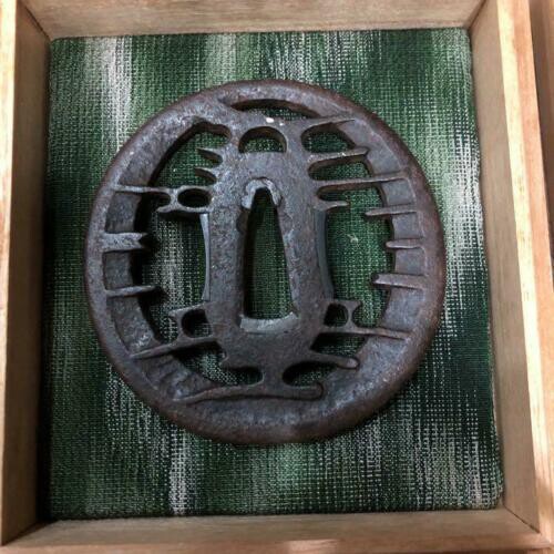

I would have said Akasaka. From the photos it looks a little worse for ware or that could just be a bad pic.

It is an Akasaka design but the 'cloud' lines that run across the tsuba are quite thick and it does look a bit too chunky
Better images would help

Propably Akasaka or Myochin , the same motif : haze ( kasumi )  in positive silhouette at daybreak below .Left to right : Akasaka , Tosa Myochin Ki Toshio and Myochin Nobuyoshi .

When Akasaka Tsuba cuts the inside of mimi diagonally, it leaves the mark of the tagane as a decoration.
Mr. Sasano shows a sample of the 4th generation Tadatoki. It's more regular, not random.
I don't know if Myochin Tsuba is an exception.
四代彦十郎忠時 鋤下鏨
Like this...

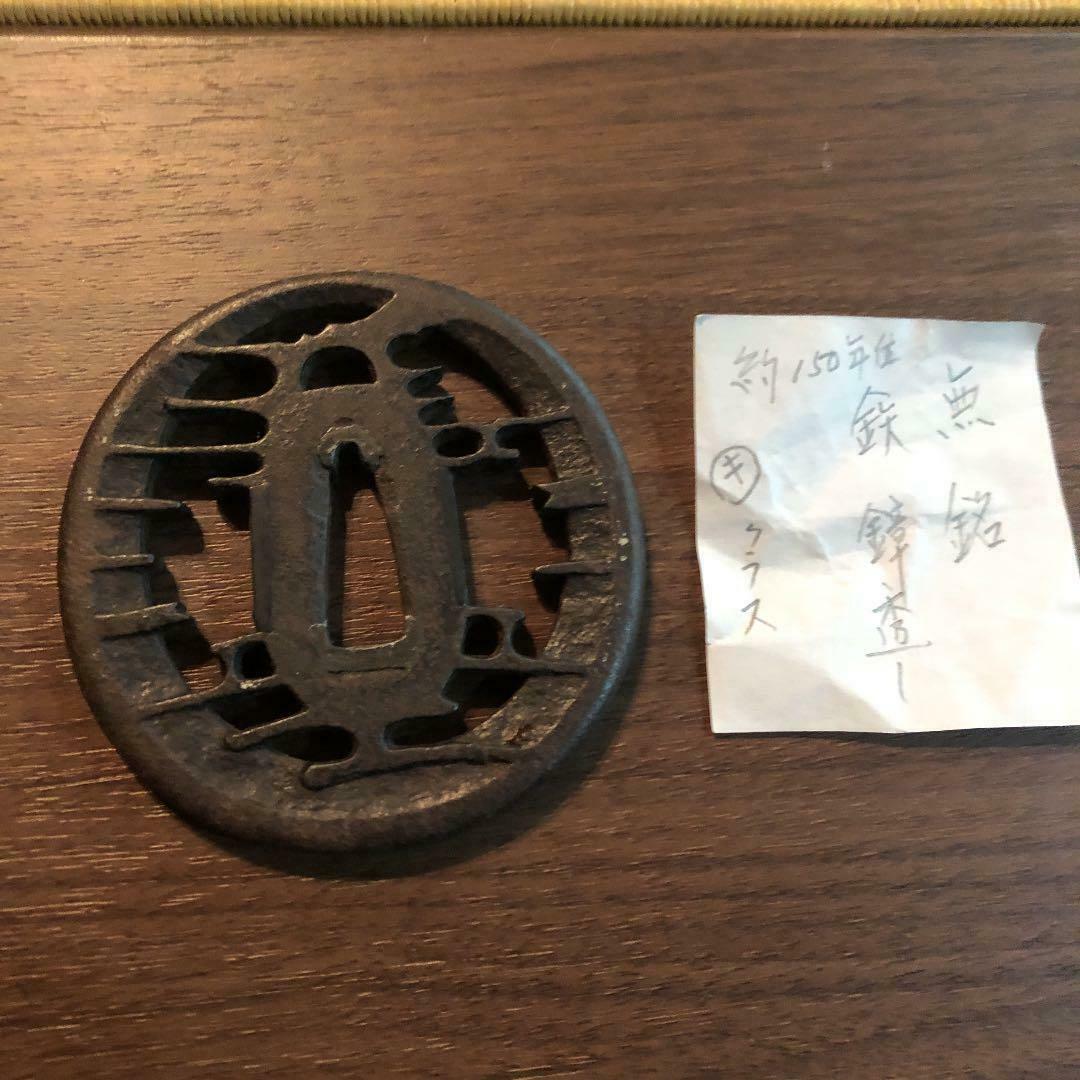

This OP's tsuba or a similar tsuba is on ebay 124198127954 $690 sellers in Japan it states.

The subject tsuba does not have Akasaka quality to me, even the Tosa Myochin were typically more highly skilled.
Tagane sukashi sometimes seen in the rim by the Akasaka yondai is sometimes carved without the trace of tagane, so may be Akasaka school work. The "hidden chisel" by the Tosa Myochin is absent, and so probably not one of theirs.
