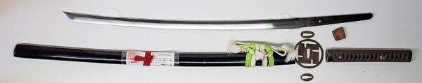

Let me share all the information I have regarding the sword. Indeed, the seller told about Mino province and also mentioned Meiō era (years 1492-1501). The sword doesn’t have NBTHK papers, only tōrokushō. I was provided with the high-resolution photos of the fully assembled sword (attached) but not a bare nakago.
post-5396-0-39946300-1589736006_thumb.jpgpost-5396-0-52752300-1589736031_thumb.jpgpost-5396-0-68806000-1589736050_thumb.jpgpost-5396-0-58330000-1589736071_thumb.jpgpost-5396-0-48814900-1589736108_thumb.jpgpost-5396-0-87747500-1589736089_thumb.jpgpost-5396-0-67873200-1589736152_thumb.jpgpost-5396-0-50270100-1589736172_thumb.jpgpost-5396-0-15801800-1589736207_thumb.jpg
Please do not be confused with the tsuba shape. It is not a nazi symbol but a Japanese manji.

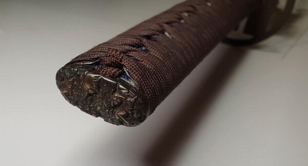

I definitely do like the tsuka and saya designs. However, it seems that both saya and tsuba are of modern production (not sure about the tsuka). But the most intriguing question is a blade authenticity :)
Alexey, your photos are quite good for someone new to this field. Please take a few shots of the completely bare blade, including the habaki. For now, we don't need to see anything else.
The sugata (shape) will indicate the age, the patterns on the steel (jihada & hamon) will indicate the school, & we can see if the signature (mei) matches with the rest of the blade. Even then, without sending it off to shinsa (Japanese evaluation team), we won't know, for sure, but we'll have lots of opinions.
The tsuka has no sign of wear, or body oils, so it's likely modern. Harder to tell on the saya, but probably also modern.

Hi Ken,
Photos have been taken by the seller. I have not bought the sword yet, just intend to. At the moment the sword is located in Saint-Petersburg, so I cannot inspect it in person. I made a reservation, and am waiting for a moment to see it (now it is a bit hard to travel between cities due to quarantine).
Thank you for your recommendations. I'll ask the seller to photograph the full-length bare blade.

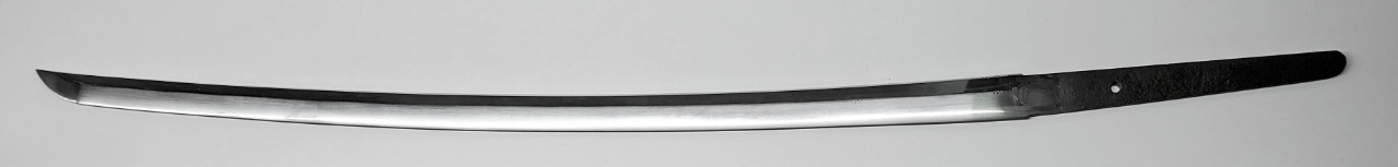

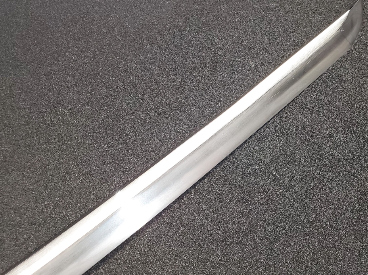

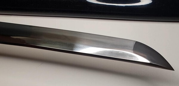

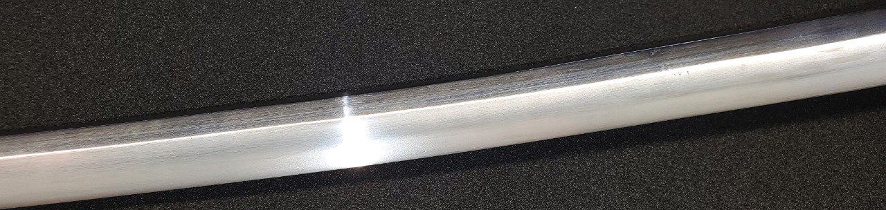

Here are some new photos including those of the full-legth bare blade. I hope this will be helpful
