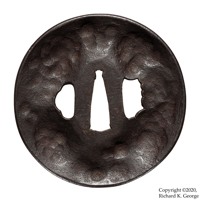

The video is impressive, the first time I've seen uchidashi being performed. That was what the Goto artists used I believe. So seeing this used with this fuchi kashira set by the Nara is quite possible. I've always been fascinated by menuki and f/k because of their typically small size and great detail found on them. Thanks for pointing out the Ford video. I haven't thought about his videos for a long time and really need to spend more time with them. Richard, isn't your tsuba iron?
Ron STL
Share this post
Link to post
Ron,
yes it is (and its actually pretty good stuff - it was folded repeatedly, but I digress).  I don't think I've owned a tsuba formed like this before.
Best,
rkg
(Richard George)
