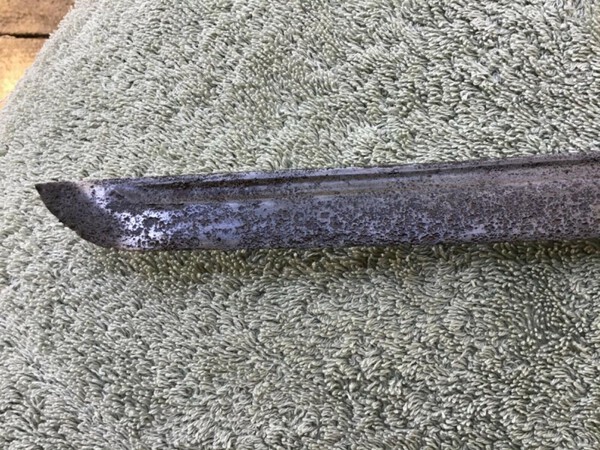

I purchased this sword online, my father did a little bit of knife making and polishing back in his earlier days (all by hand) and said he would like to find a wwii sword that is really beat up and attempt to clean it up. It took me a while to find him one to work on. I ended up with a type 95 that was very heavily pitted.I tried to removed the screw on the sword but due to it being stripped, I wasnt having any luck on it. Anyone else ran into this problem and have any ideas? I am well aware that you don't normally want to mess with these swords, he really wanted to try cleaning a beat up one up so i found him a beat up one. I don't think blades get in much worse condition than this, unless its broken.

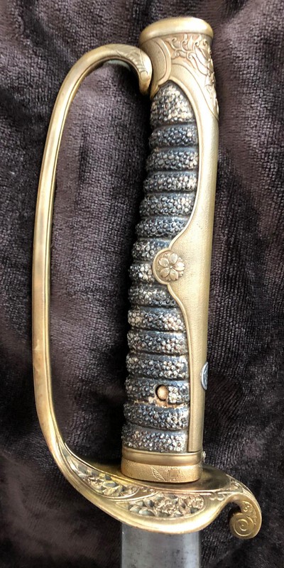

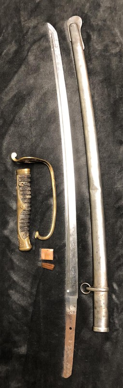

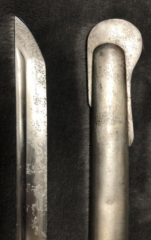

I'll PM you and we can talk about a beat-up kyu gunto. It's got serious pitting on the kissaki (blade tip) and some dark stain on the blade. I was hoping someone who bought it would know how to "fill" the pitting with some sort of steel and re-buff the surface. I have an NCO Type 95 that looks like it was actually field-repaired that way.
The handle is missing the wire-wrap and it's got a post-war copper spacer in place of seppa.
It's not nihonto, but was made in the 1900-1925 range where they were making western-styled sabers out of single steel, and artificialy applying a hamon to the edge.

Mac, great project for your Father. I would use a couple of drops of "Kroil" oil on each side of the stubborn screw/nut and let it sit for a couple of days, keeping the screw wet during that time. Then dry the screw/nut, then take a small jeweler's file with a serrated edge and carefully clean up the screw slot. If you can do the same with the two slots on the nut, do it, it will make the removal process much easier. Make sure your Dad has a nice set of gunsmiths screw drivers and keep the slots dry when your are trying to get the screw loose. The snap ring pliers could help, especially if there is a second pair of hands holding the pliers [ :) ].

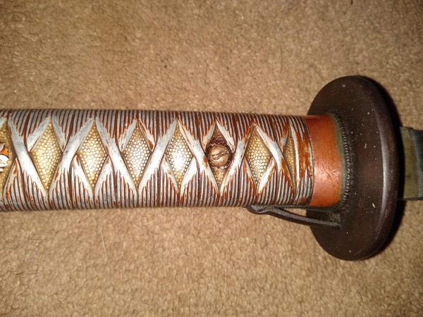

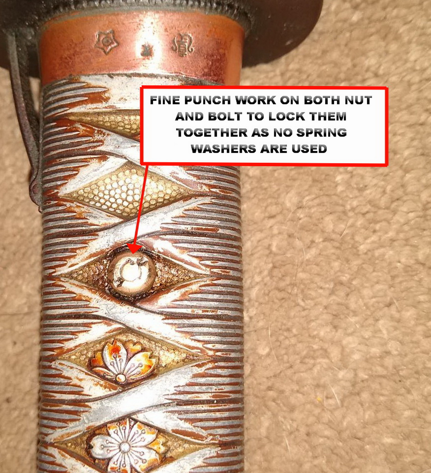

If you plan on going ahead with the removal of the handle, just be aware that the mekugi screws were generally all center punched to flare the ends and lock the thread to prevent the nut loosening from the bolt. This is because no spring washers of any kind are used.

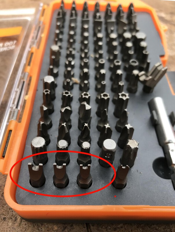

Use 'good' not worn tools which are a good fit into the slot of the bolt and the nut.
You could try with a pair of circlip pliers as bruce has suggested, or try and get a screwdriver bit from your local hardware.
The set i've shown is a cheap set i bought for only $9, but with brass it will do the job.
Your bolt and nut set are punched as i've highlighted.
