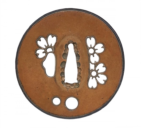

Nowadays everything is digital. Okay, there are some enthusiats out there who use film. But in the end: digital.
It is more ore less a discussion about using Photoshop or not. I am not one of those "one shot and be done with it" guys.
I use Photoshop. And the next question is: how much is okay?
Here are some examples: a Hirata tsuba before and after. Is it okay to cut it out? Is it okay to make a retouche?
It depends on what you want to do with those photos. Are they just for you? Will they be on a bookcover?
And a Gassan.
Uwe G.
