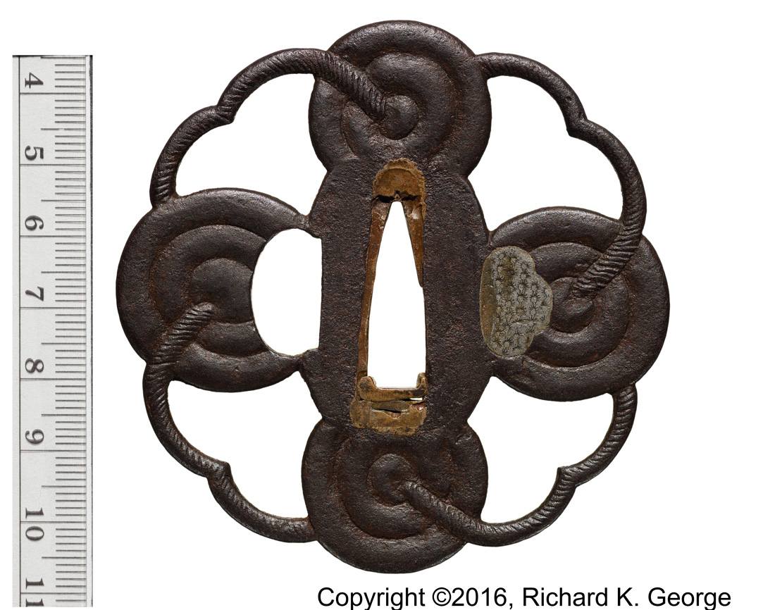

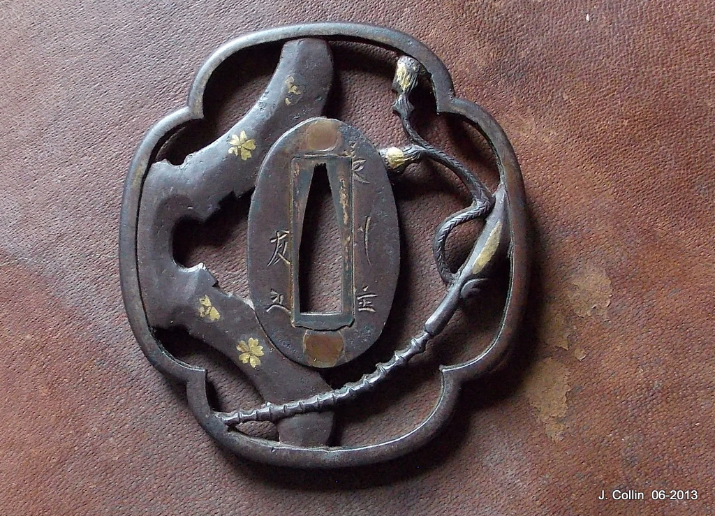

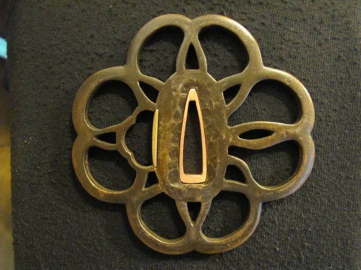

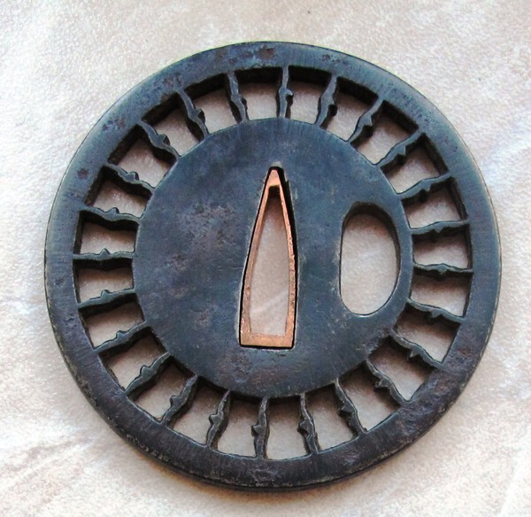

The piece that started the thread sure looks like somebody just used part of a habaki or something.  I've probably posted these here somewhere before, but.... here's a couple of pieces I have with sekigane that surrounded the blade (at least at some point in one case):
post-204-0-80791300-1578766923_thumb.jpgpost-204-0-92173000-1578766983_thumb.jpgpost-204-0-58916300-1578767403_thumb.jpgpost-204-0-62312700-1578767426_thumb.jpg
Best,
rkg
(Richard George)
