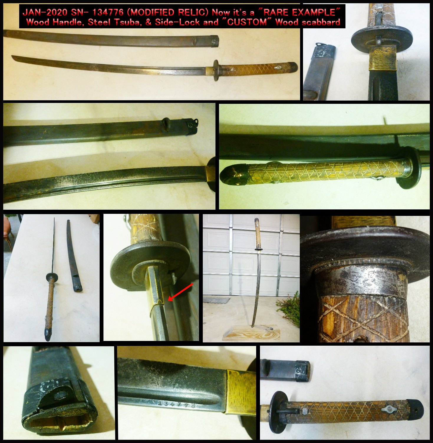

Upon closer inspection of the photos provided, i thought it odd that the blade would have the 'he' stamp, and it is definitely not in my opinion.
The scabbard looked very poor and unusual, i agreed with the seller who stated it was  'probably custom', but not from 1945 i thought.....
After checking some records, i was right, - custom from within the last 3yrs.

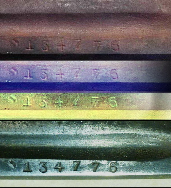

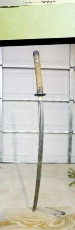

A serial number check revealed that the blade was sold in 2016, as a relic with no scabbard. It also had the remains of an Aluminium handle with the appearance of being in a fire, so was charred and burnt.
Looking for similarities between the old photos and the new, revealed the numbers being identical, and i also marked with a red arrow in the pics, the dent at the front top tip of the habiki.
2016 serial numbers are the top 3, with different filters, the bottom serial number is the cleaned up 2020 one.
I've included a compilation of 2016 photo's , the same of the current 2020 sale, and a comparison of the serial numbers for you guys to check out and comment freely on.
Whether the current seller produced this 'rarity' or purchased it as is, remains a mystery, but this is definitely one to stay away from.

Very well done with the detective work mate. I saw this sword and immediately discounted it based solely on a couple of observations:
- We know that there is a very limited run of pattern 5 with fullers and we know the number range and
- These are all Seki stamped
- I have a proper pattern 5 from Jinsen (unstamped) and it's not remotely similar to this
- I have other pattern 5 with those sort of 'odd marks', which are just poor strikes, so even without the above, I'd assumed it one of those
As always, myself and every serious 95 collector should offer you our sincerest appreciation for keeping, researching and sharing your meticulous records.

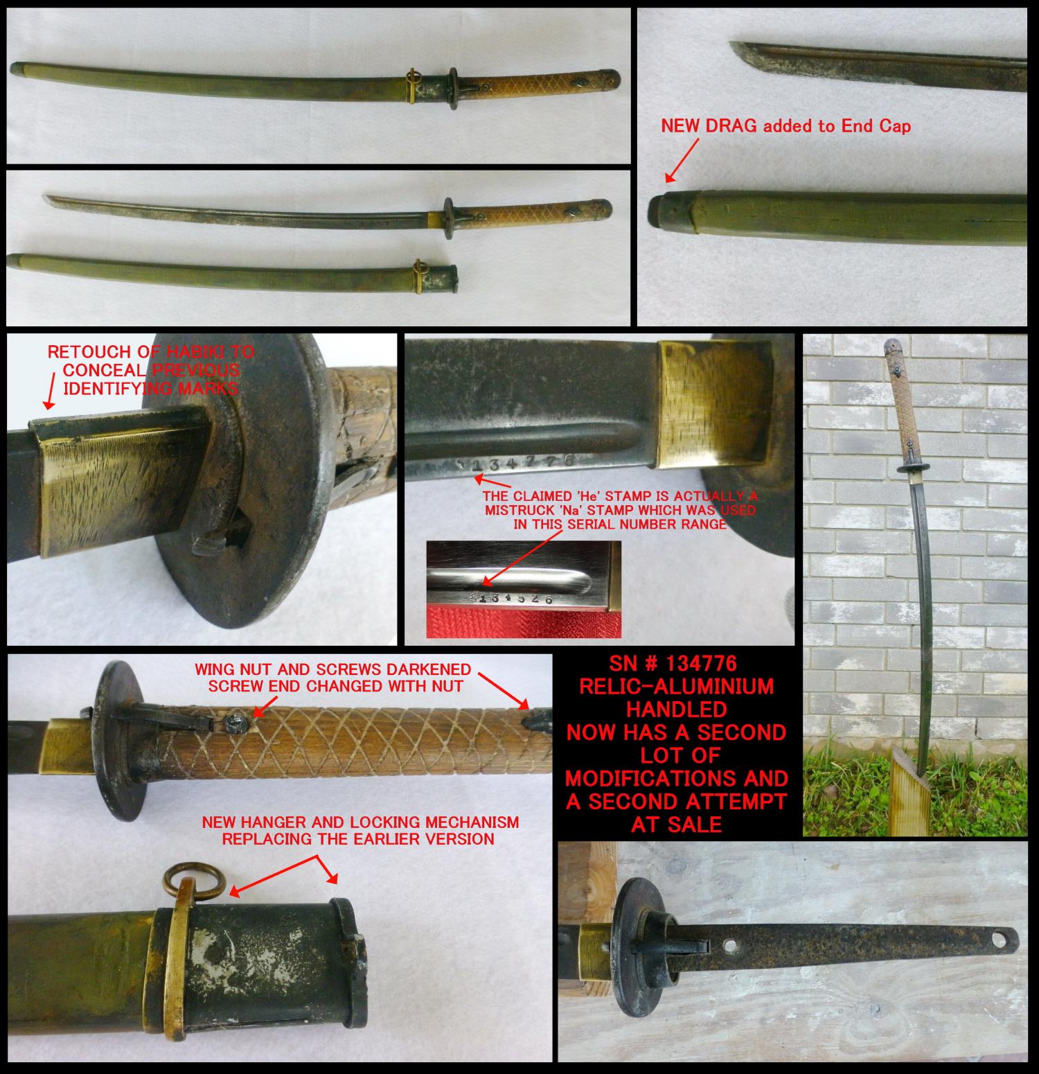

Just for your info...
This guy has done a second lot of mods to this and is re-selling again!
Changed it's appearance, but once you know, you can tell a pig is a pig, no matter how much lipstick you put on it.
Wow, so soon after the first attempt. A lot of front and no shame at all,  NOW we know he IS a backyard scammer 100%

One day to go, and at the moment, assuming sale goes through,  -he has recouped his original outlay in the relic.
Now it's all profit.
