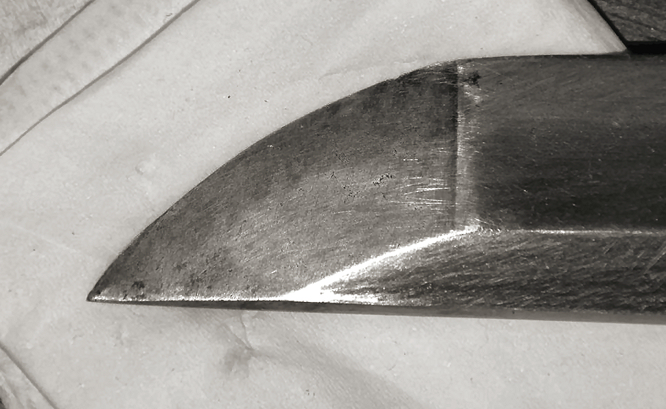

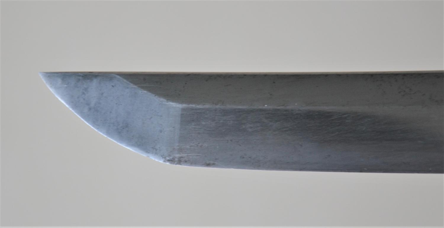

Hello,
I have been looking for information and, above all, for other swords that might match the style of my mumei wakizashi and have wondered whether there might be a remote possibility that this  sword be Hizen and made in the style of Nidai Tadahiro.
Didier
Didier,
My head on the block first!!  I doubt very much that this is a Hizen sword.  Firstly, they are very high quality which your sword is not.  Why can I say this so assuredly?  Look at the polish near and adjacent to the machi (DSC_0066.JPG).  The lines visible are from a burnish polish, in my experience only done on lesser blades to be "done up" for quick sale.  Also the sugata is wrong for a Hizento and Hizento are (nearly??) always signed.  I doubt the Japanese would let a genuine Hizento slip through their fingers.  The only way you are going to get any headwind with this sword is to have a window polished in it and that can lead to an expensive slippery slope.  To add to this I have a nidai Tadahiro katana and I have seen two nidai Tadahiro wakizashi.  I can assure you that they at first sight have a "presence" - of course I cannot have your sword in my hand, so it is a tough call to make any kind of judgement on an out of polish sword...  I wish you Bon Chance with this wakizashi.
BaZZa.
Well, I have tried to look for information using key words such as o-wakizashi, suguha, ko-maru, short kaeri and the like, all of which were, as far as I could judge, characteristics of this sword, and the results I got seemed to point to Hizen and Nidai Tadahiro. Of course, I am what you would call a noob, so you could say that this was some kind of desperate attempt to try and discover where the sword was possibly made and by whom.
Didier,
it is already a good thing to be able to relate a blade to a certain era/period. The polish of your blade (and the photos) do not allow to see the HADA, so to relate it to HIZEN, you should see some very tight MOKUME HADA (or even KONUKA HADA, which is typical for many HIZEN blades).
In contrast to what Barry wrote, there is of course a slim chance that a very good blade once received a very basical polish. On the other hand, HIZEN blades of the famous makers had a MEI in most cases.
MUMEI SHINTO WAKIZASHI are generally not in favour with collectors, as they are often not top of the line, but that should not be a reason not to like your blade..

Looks like a Shinto sword.
A gentleman with some knowledge of nihonto (he sells tsuba mostly, though) and who had the sword in hand did tell me it was Shin-shinto, but I am at a loss as to defining the school this wakizashi might be from.

Hm  Looks like an  very late Shinto or early Shinshintio blade. All the other things  I can not tell. I can see nor the hamon or the Jihada. There is  a hardend portion, but the real hamon, nie / nio , i can not see.
If You want to know what  Yo do have, madoake, openeing a window. Means  polishing a small section of the sword.
This way is much cheaper than a full polish for the whole sword.
Stefan

Sugata determines jidai => Appears to be late Shinto/early Shinshinto
then
Jigane determines where made => You can't see the hada
then
Hamon determines the school => You can't see the hamon, just the hadori
then
Nakago & mei determine the tosho => You can see that, but nakago is generic, & blade is mumei
Just what are you planning to do to extract more info on your "riddle?"
Choosing random - not key - words, like "o-wakizashi, suguha, ko-maru, short kaeri and the like" will get you nowhere. You've listed no measurements, so "o-wakashi" doesn't apply. I don't want to hazard a guess on the hamon, but would bet it isn't suguha. I can see what might be an o-maru boshi, but I'm not sure, & the kaeri is indistinct. This isn't a riddle, it's a blindfolded guessing game, in the vast ocean of Nihonto possibilities!
