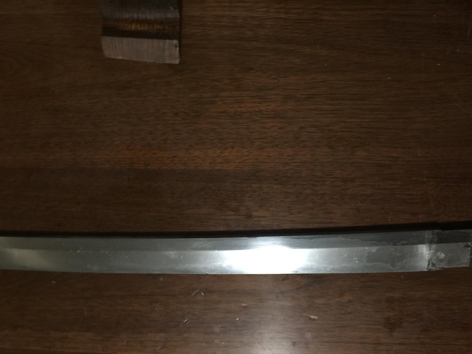

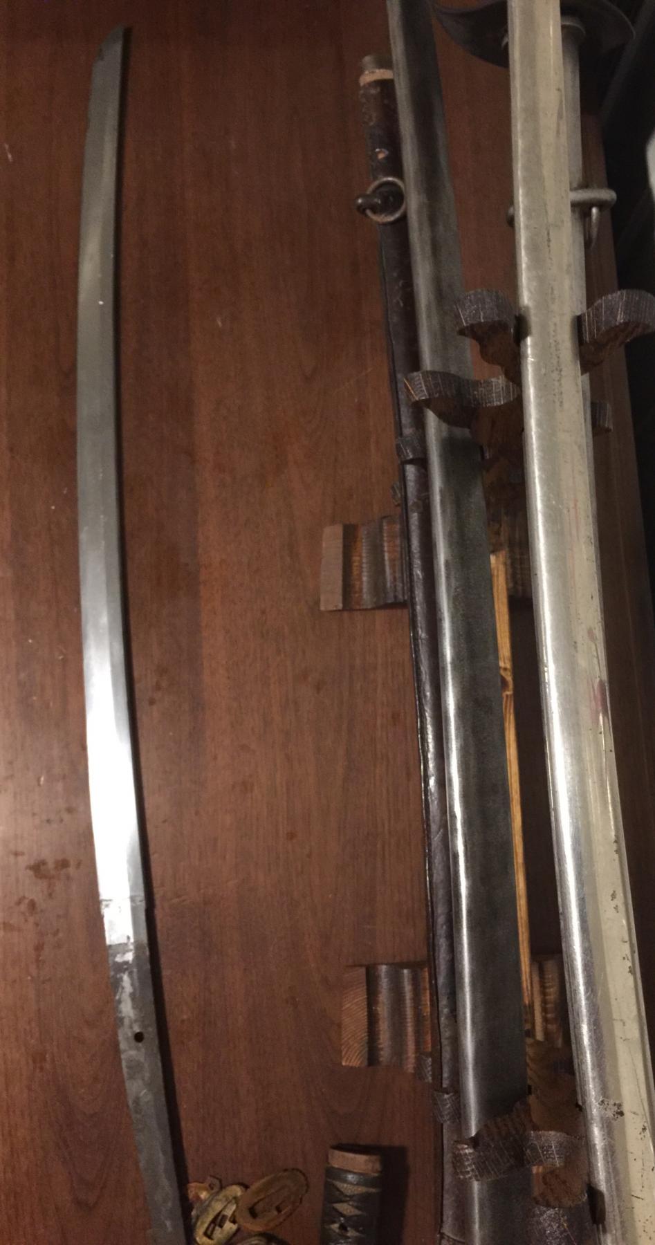

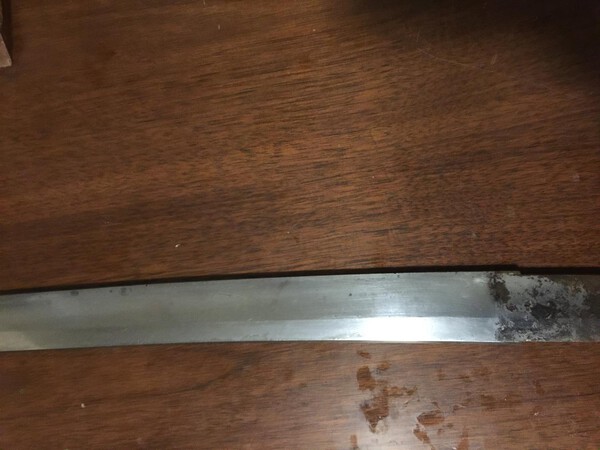

Two mekugi Ana, one that’s been filled, looks like an older blade to me, but please post pictures of the entire naked blade for the sugata and try to get some picture of the Hada, the Hamon (if you can see them) and a picture of the nakago jiri.
Totally guessing, pre-showa, but not by more than 100 years, just going by the yasurime and how proudly they still stand even with all the corrosion nearby. interested to see what the seasoned folks think. kinda a hard call with the blade being out of polish. And we never get much to go on. still a shot in the dark a bit. maybe zooming in to see if the metal has big/small/no grain.
Maybe some resident vets miss the post with the words Showa (bless their souls) in the title, but you can look thru a few posts and see some folks that are excellent at translating whatever missing characters you need, and send them a pm. That would be a surefire way to get help with translating.
I will post the entire blade later, thank you.

A clearer picture of the tang might enable one of the better linguists to read the inscription. Given the length of the inscription it might be higher quality than the usual Showato or maybe even a Gendaito.
I don’t know, John. Looks older to me, probably shortened to conform to length regulations and tested during Showa as you can see that the tang around the inscription is shinier. Inscription looks more recent than the rest of the patina.
I won't disagree: I'm a bit thrown by what I think is corrosion and that the last two kanji are obscured. So we have some corrosion, some original patina and part of the inscription that has been cleaned up?
Yes,Can't be sure what's the last two Kanji .I think 試切or試刀 kind of make sense.But also could be other character,like 武力。。。
