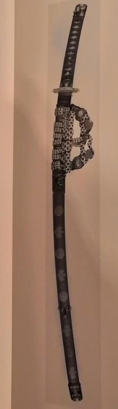

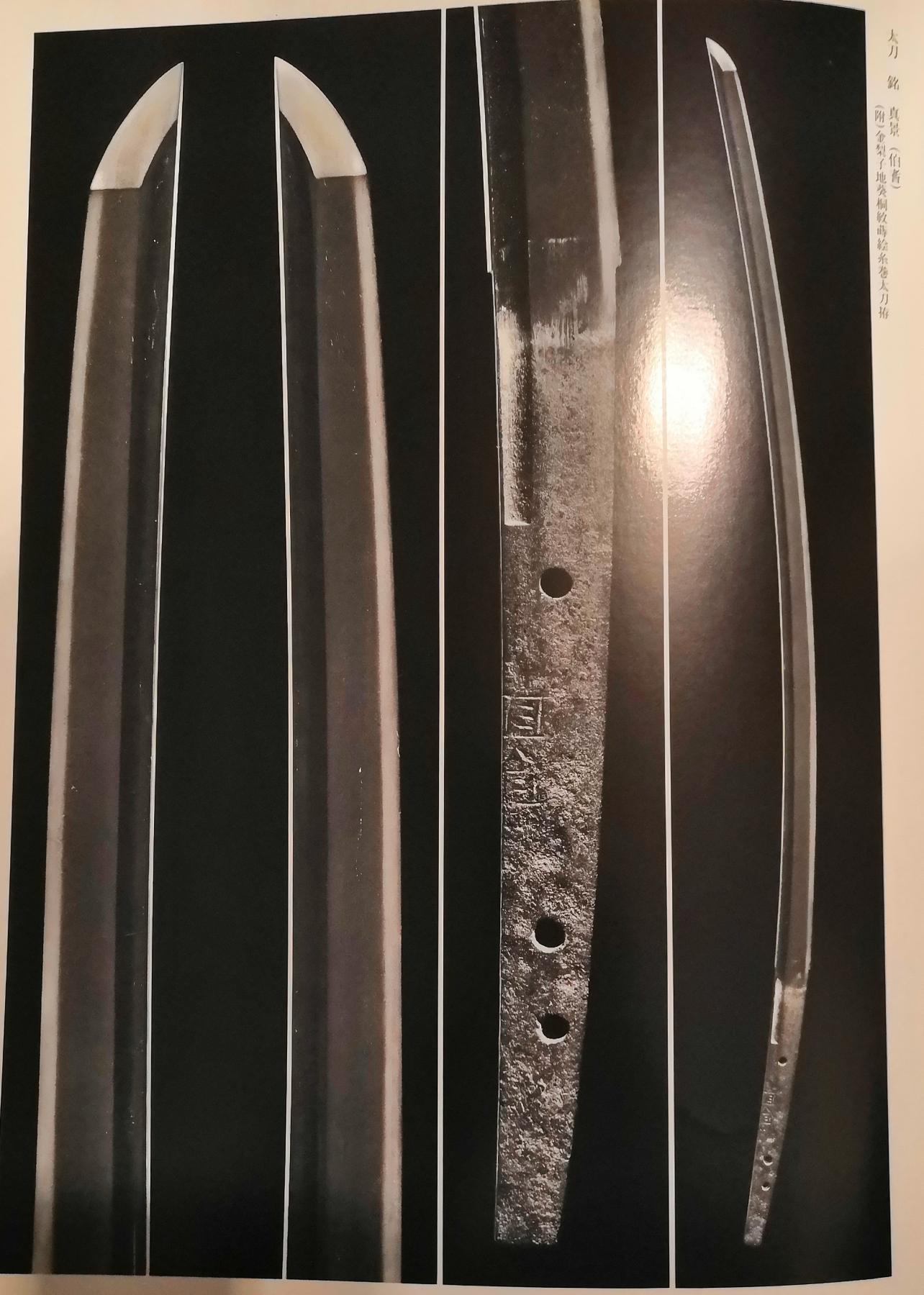

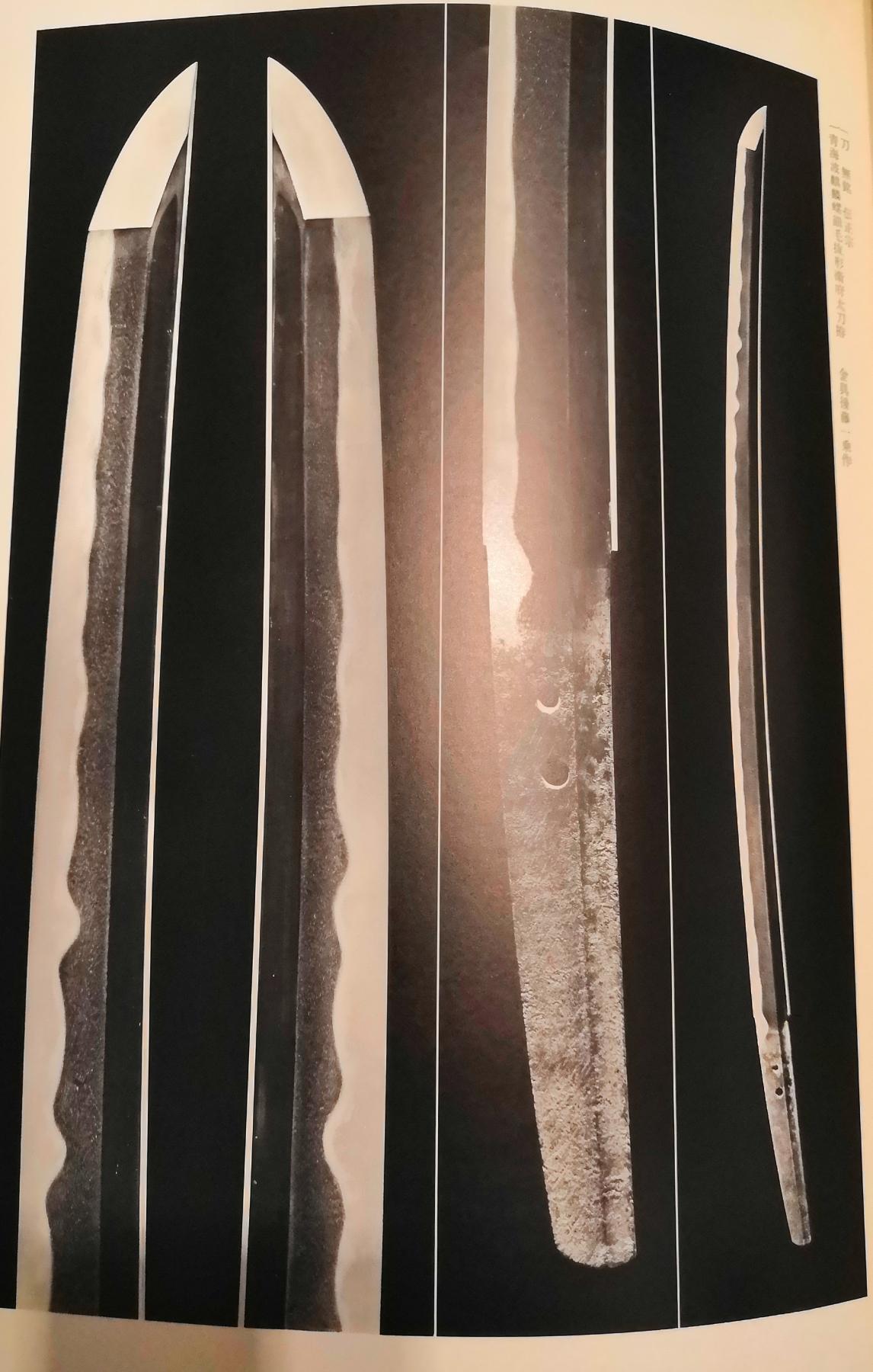

I was doing nightly browsing of the Tokubetsu Jūyō books I have and there are some incredible swords passing some of which feature koshirae. Here are few interesting ones. Sorry about bad pics but it is the middle of night in here. Yep we have midnight sun in Finland during summer but still bit darkish at my apartment. I chose few that I found interesting.
Long tachi from Heian almost 77cm, Hoki Sanekage and tachi koshirae
Signed Hōshō tachi by Sadaoki and koshirae it has
Meito tachi Mutsu Shintōgo Kunimitsu and koshirae
Katana attribution den Masamune and I believe this papered together with the tachi koshirae it has
It is rare occasion that sword papers together with the koshirae for Jūyō or Tokubetsu Jūyō but it happens sometimes. Of the above 4 I think the den Masamune sword is only one to pass with koshirae in paper while the koshirae are just mentioned for others in the entry. Latest to sword to pass Jūyō with koshirae seems to be mumei Rai Kunitoshi tanto in session 50. Sword & koshirae passing together was definately more common in early shinsa yet it was still rare even back then.
