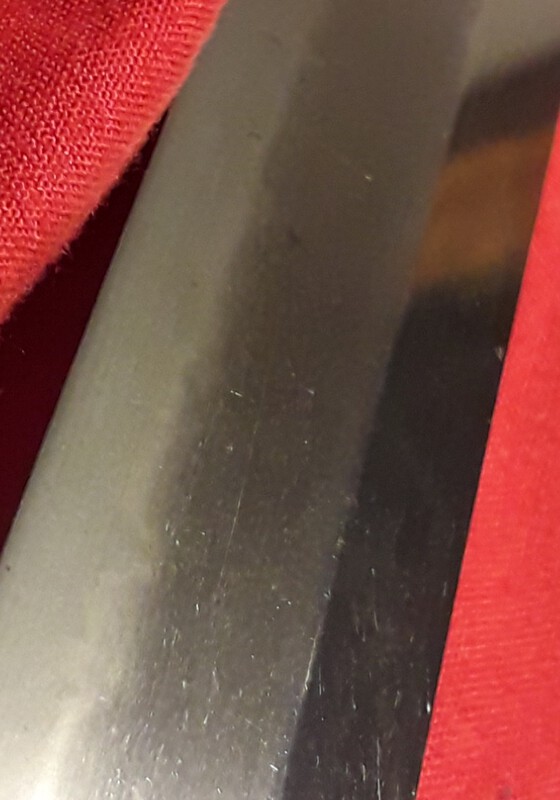

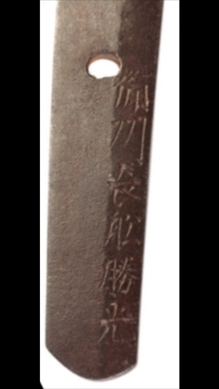

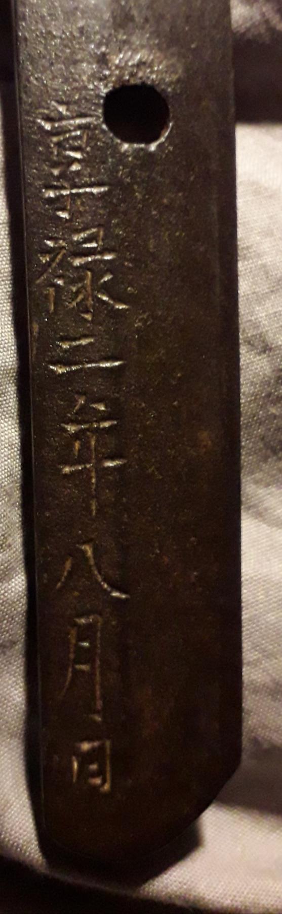

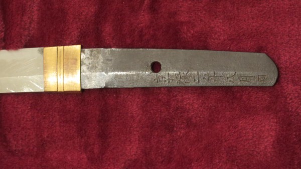

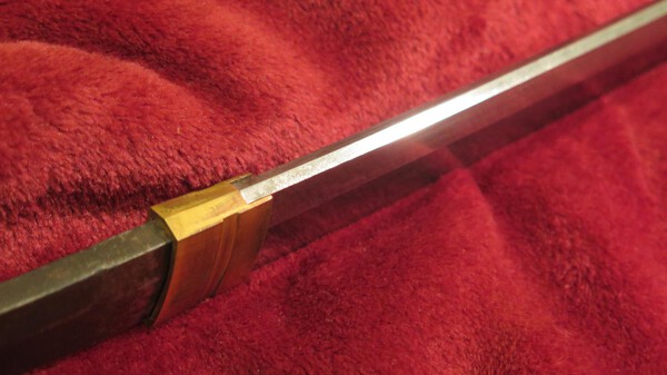

I think you'd need a new polish in order for this sword's charms to make themselves apparent. On the positive side, it looks to be in good condition, ubu, and it has what looks like a nice hamon. I'm curious as to the length; the sword itself looks like it has katana-length, but when its next to the saya it looks shorter, and the saya looks like a wakizashi saya.
On the negative side, its scratched up, its got a couple of (minor) hakobore, and it needs authentication. If its a wakizashi, I'll also include that on the negative side of the ledger - with reservations. The saya is, unfortunately, a write-off, but nothing to lose any sleep over, and it should be considered separately from the sword.
Yes - the usual refrain. If you are looking at the finances of this, I would sell it (or keep for yourself and enjoy it) as is.
I don't know much about Katsumitsu (or, I should say the many Katsumitsu smiths). I wouldn't write the blade off as kazu-uchimono, but from what I see here; an out of polish, unauthenticated wakizashi, in distressed mounts...it feels like it would be a stretch to make a profit from a restoration project of this sword.
