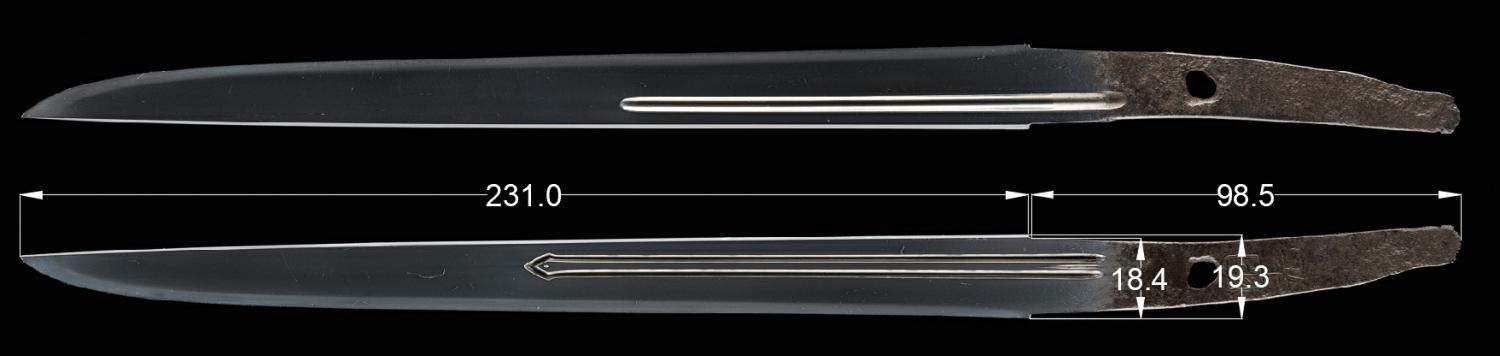

Recently i been studying some Juyo papers and i found out something odd, it seems that NBTHK considers the measure of motohaba from the ha to the base of the mune, not like i've always been told, from the ha to the top of the mune. In some older paper it appears to be as mine, but in last years seems something changed.
Did someone else notice that too? Or have an explanation?
Actually also in the bulletin by NBTHK  it seems that they apply this method of measurement. I checked the last Shijo Kantei To No. 742, the same one released in October 2012, in which the oshigata are in 1:1 scale, in both it is reported "Motohaba: 6 bu 9 rin (2.1 cm)", measuring with the caliper we understand that Manuel is right..

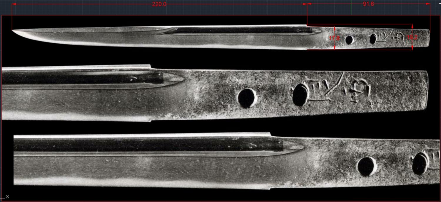

Sorry for the late reply Jussi, i was looking for a good example.
This is a famous tanto by Ryosai, it's also been proposed as kantei by NBTHK with the following dimensions:
Type: tanto
Length: 7 sun 2 bu (22. 0 cm)
Sori: slight uchizori
Motohaba: 5 bu 6 rin (1.7 cm)
Motokasane: 2 bu 1 rin (0.65 cm)
Nakago length: 3 sun 4 rin (9.2 cm)
Nakago sori: very slight
This is what i measure from the scan took from http://www.sho-shin.com/sai.htm
Even considrering a conversion approximation and a possible parallax error from the picture the difference is too obvious for me, especially the other dimensions are much closer to what NBTHK states
I have that tanto also in the Tantō book and it is listed with following dimensions there
Nagasa 22,0 cm, motohaba 1,9 cm, motokasane 0,6 cm, nakago 9,0 cm
And Sho-shin website seems to have
Nagasa 22,1 cm, motohaba 1,8 cm. nakago 9,4 cm
While these are miniscule differences in the big picture they are troubling me a lot.

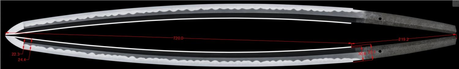

and another one, this one is a katana from https://www.aoijapan.com/katana-bizen-suke-fujiwara-munetsugu-saku30th-nbthk-juyo-paper/
Aoi's measures:
Blade length(nagasa) : 72.0 cm or 28.34 inches.
Width at the hamachi : 3.20 cm or 1.25 inches.
Width at the Kissaki : 2.50 cm or 0.98 inches.
Juyo paper's:
Nagasa: 72.0
Motohaba: 3.05
Sakihaba: 2.2
here's my measure from the scan:
Now appears clear to me that they measure from ha to the base of mune, not like i always been told from ha to the top of mune
