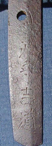

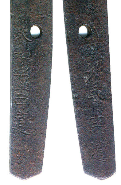

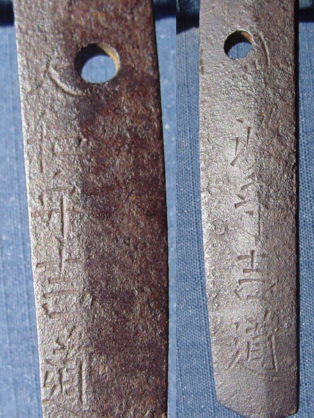

Here's my own (supposed) collaboration wakizashi. Tanba (no) kami Yoshimichi and Yamato (no) kami Yoshimichi. Blade isn't in a good enough polish to verify the details, but my research leads me to believe that it is gimei on both counts. Maybe someone has some further info.
I guess a double gimei is much harder, but obviously the temptation is greater to pass it off as a work by both smiths. The look of the nakago leads me to believe that if gimei, it isn't a modern gimei though. Some of the strokes, particularly in the michi kanji, seem to go the wrong way too?
Brian
Share this post
Link to post
Brian,
Yes, there do appear to be a lot of inconsistancies in the mei. The condition of the nakago looks a bit more deteriorated than I would expect for the age of the sword too. Perhaps a bit contrived adding to the deception? Look at the crispness of the nakagoana edges and walls which don't really evoke the same deterioration level to me. The work in the blade is the important factor though. Gimei can be remedied with proper and judicious removal. If the shape and condition look like it might have some promise, have a window put in it and see what it has to offer. Might be something better, who knows. :dunno:
