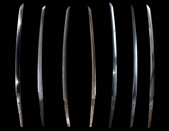

I wanted to see how different the shapes of my gendaito are. So i put them together in a picture. It is very interesting for me to see the difference between the wartime swords.
I never notice that when i have them in hand.
From left to right:
1. (Kinoshita) Yoshitada 吉忠
2. (Kosaka) Masayoshi 正義
3. (Yuki) Munemitsu  宗光
4. (Fukuoka) Morimitsu 盛 光
5. (Yamagami) Akihisa  昭久
6. (Taguchi) Masatsugu 正次
7. (Tamijo) Hisakuni  久國

Good thinking Chris, it's an enlightening photograph....perhaps another photo comparing only the tang forms and details.

No Hamfish. I have unfortunately not such a sword in my collection.
Edit: I wrote the names under the picture.
And maybe another with just the kissaki?
