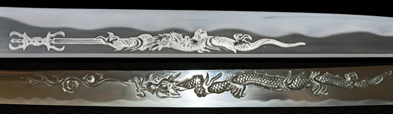

I'm such a neophyte, I am almost embarassed to ask this question.
There is a Kotetsu being offered on ebay Japanese SWORD KOTETSU CUTTING TEST WITH PAPER VERY GOOD...$7500 by fwic2803 in Tokyo. His ebay rating is 100%. Now, I heard that a real Kotetsu would go for $100K plus, and I can't imagine a Japanese sword dealer would knowingly offer such a sword starting at $7500 with no reserve!
It comes with a BNH Ninteisho papers which probably is as worthless as the paper it is written on.
So for my education, what is your opinion on this?? It has to be a fake because it is too good to be true!

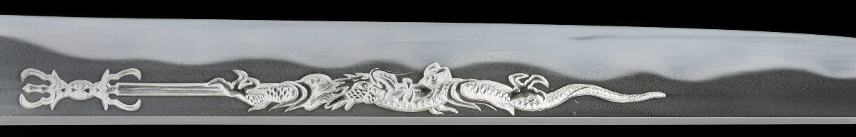

There is at least something of value to be gained form the images of the horimono though.
The evidence of the chisel marks in the outline of the dragon is a very reliable give-away that this is a very recent addition. The authentic style of carving, and finishing, will have no trace of the chisel marks. This is not Kata-kiri bori :roll: The sloping inner face of the outline should be polished and burnished smooth...but that takes a long, long time. :roll: The dragon is also just very poorly drawn and shaped in general. It all seems very basic.
So this particular horimono is an excellent example of what a carving in a blade should not look like.
I make this comment because it seems to me that we are seeing more of this sort of thing ( carvings and mei being added ) and they may easily fool the unwary.

never the less, I won't be surprised to see this sell for 10's of thousands of dollars :crazy:

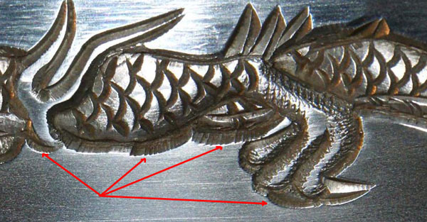

Hi Ford,
You are refering to these "carving marks" that have been left?
They do appear very rough and close-ups don't do the horimono any justice in this case. Would this be by an amateur horimono carver, or by a metalworker that doesn't have experience with Nihonto, or just a total faker?

Hi Brian,
it's not utter crap in terms of general metalwork, after all it does take quite a bit of skill to get to even this standard....but on a Japanese sword it simply does not pass even at the lowest level. My feeling is that this is the work of a deliberate faker. An amateur horimono carver would, I think, at least make some effort to do it right. His lack of skill would be the give-away. In this case it's very clear that time was the deciding factor in how far the finishing was taken.
That image you've posted is a great example for us all to study to try and understand the difference between this sort of fake and the real thing.

I've been looking at this sword as well and as has already been pointed out, the horimono is naff, and glaringly so.
That, to me, doesn't prove a fake or a gimei straight away. It looks like a recent addition so that suggests it's covering up a flaw, although I'd rather look at the flaw than that horimono...
So with that said, what else about the blade suggests gimei?
Ignore the horimono.

While I can agree to a point with the comment that this blades has been judged a fake on only circumstantial grounds I think that this was simply done because it is all so very obvious. If we take the time to actually look at the blade then you can in fact find ample evidence to support that judgement, and that's without even going into the details of hamon hataraki and hada, as the images make that impossible.
The most glaringly obvious of those clues is the yasurimei. They are really very poorly done. Compared to the genuine article the difference is chalk and cheese. If you look closely at the area where the yasurimei meets the machi area you can see clearly how the original surface as left by the maker of this blade has been filed into leaving a rather abrupt line. Yasurimei are cut before the polish, in this case it is clear that these file marks are added after the last polish. On a shinto blade one would expect at least a little softening of that area. The colour of the tang is far too fresh, raw, bare, new...and the nakago jiri seems far too hard edged compared to genuine examples.
The boshi looks nothing like that of Kotetsu, which is actually very characteristic This hamon is pretty sad looking to my eyes, a bit wishy washy, if you know what I mean. Kotetsu made powerful blades, and they look it.
