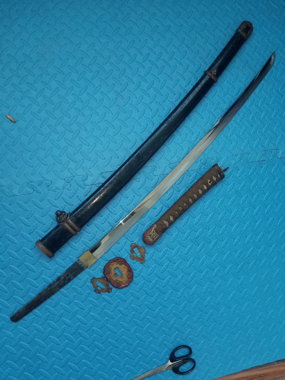

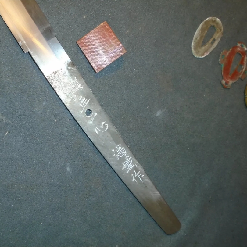

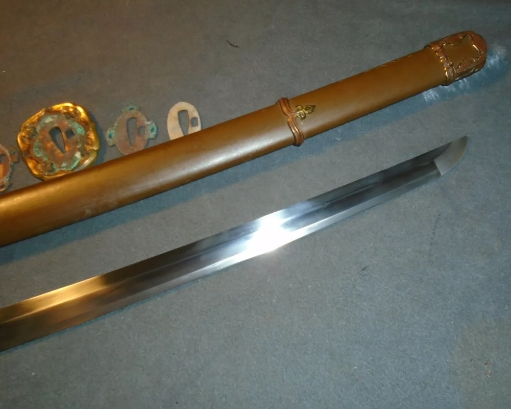

Just added a '39 Koa to the collection and study! It's in combat saya and has the "Kite" or "Airborne" sarute. Serial number ロ(RO) 270, our 2nd RO. Blades in good shape, but the saya looks like it was worn by a really short guy who litterally dragged it on the ground everywhere he went, and he must have covered some miles! The bottom edge of the leather is completely worn through. What puzzles me is the missing sarute, the metal bands mid-way down the saya (you can see the imprint on the wood and the bulge in the leather where they used to be) and some sort of metal end-cap on the wood (can see the imprint on the wood). I'm guessing the G.I. that brought it back must have disassembled it and failed to put those parts back together.
The leather at the top of the cover is fragile and broken where the snaps come around.
Nice fuchi and kabutogane with extra gold coloring at the edges.
I have some pics now, and will post more when I can. I bought this to re-sell .... but I don't think that's going to happen!!!!
Share this post
Link to post

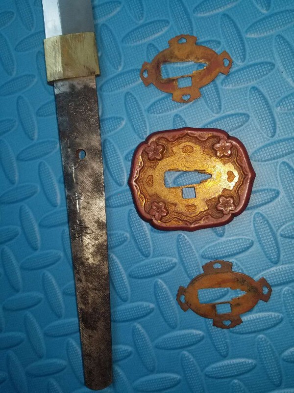

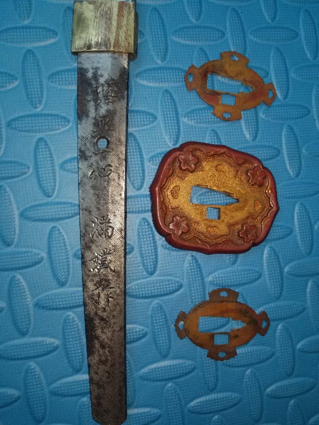

More pics. Odd there are no boar’s eye seppa. Handle is snug so there wouldn’t be room to add them.post-3487-0-20305800-1586568028_thumb.jpegpost-3487-0-16941600-1586568050_thumb.jpegpost-3487-0-96683600-1586568077_thumb.jpegpost-3487-0-73086400-1586568100_thumb.jpeg
post-3487-0-72853900-1586571018_thumb.jpgpost-3487-0-33945300-1586571049_thumb.jpegpost-3487-0-71767500-1586571071_thumb.jpeg
Interesting way the liner maker joined the end of the two halves together:
Share this post
Link to post
Oh my Gosh! I just noticed the Maximum Ugly blossoms on that tsuba! I realize there were lots of variations from shop to shop, but this one would win 1st Prize at the Annual Ugly Tsuba Contest!!!
Well, the rest of the tsuba is quite nice, actually, but THOSE BLOSSOMS!!! AHHH!
A cat-scratch habaki, nice fuchi and kabutogane, then this. It doesn't make sense. Could this be a piece-together?
Share this post
Link to post
Bruce, put together???? You gotta look at the evidence. You have a push button tzuka, but a wood saya with no allowance for the latch. As you said, seppa missing... You be the judge and jury on this.

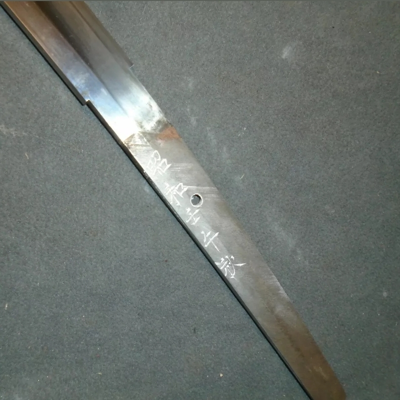

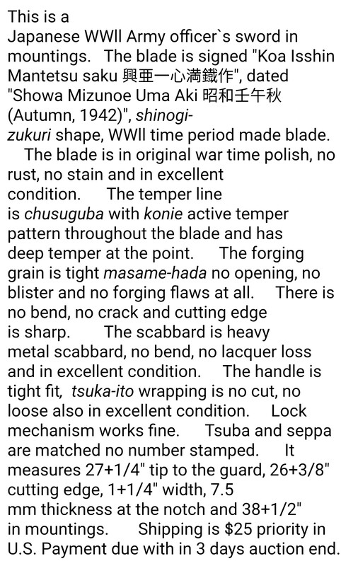

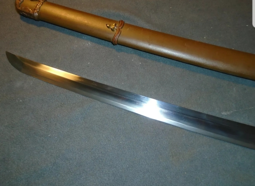

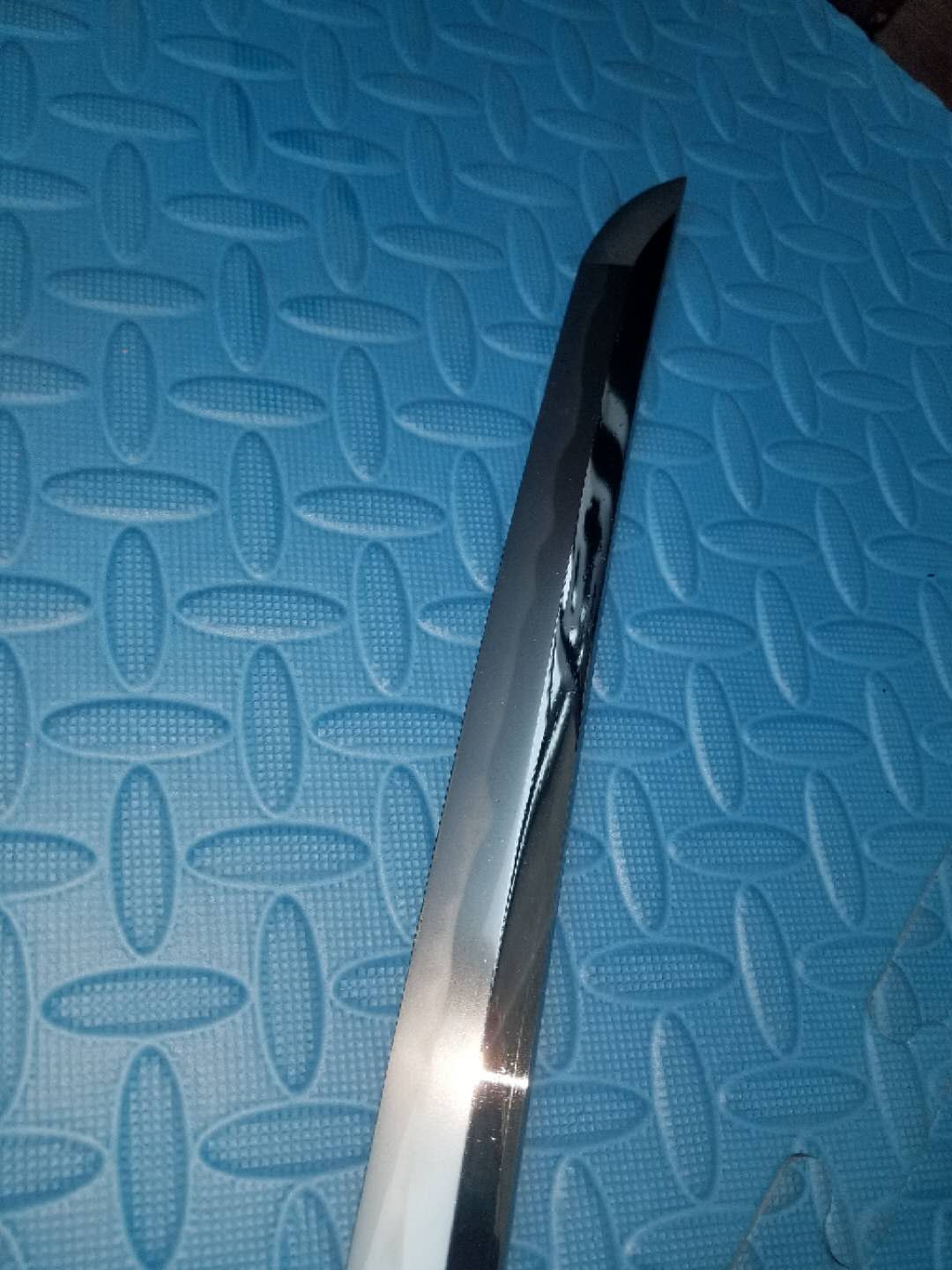

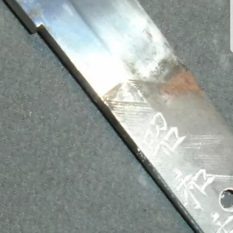

Just read through all of this. I just purchased a Koa Isshin Mantetsu Autumn 1942 off of Showa22 (fingers crossed) that hasn't arrived yet. The mei seems very legitimate after I did a bunch of comparisons as do the file lines, but after reading this I zoomed up to the only picture that kind of shows the mune and it appears to not have any markings. =]:(

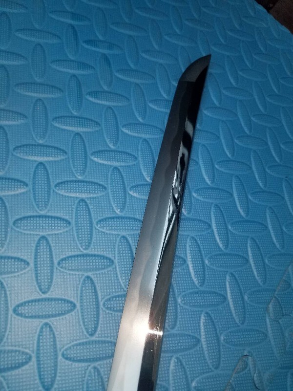

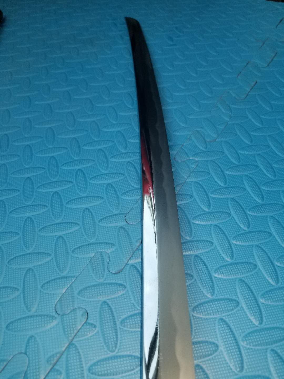

I'm the one who has the Mantetsu with attribution 鷹信焠之 (Takanobu kore o niragu)
This sword also have the "wave" hamon… maybe a missing link to all the wavy hamons ?

Thanks Joe, I hadn't seen the pics of the hamon on this one. I've saved the added pics to the files.
It is interesting that we now have examples of wavy hamon in years '39, '41-'44. I couple of them are in the "suspect" file because they from Japan and sold through Komonjo and both blade and hamon looks gendaito. But, who knows?
