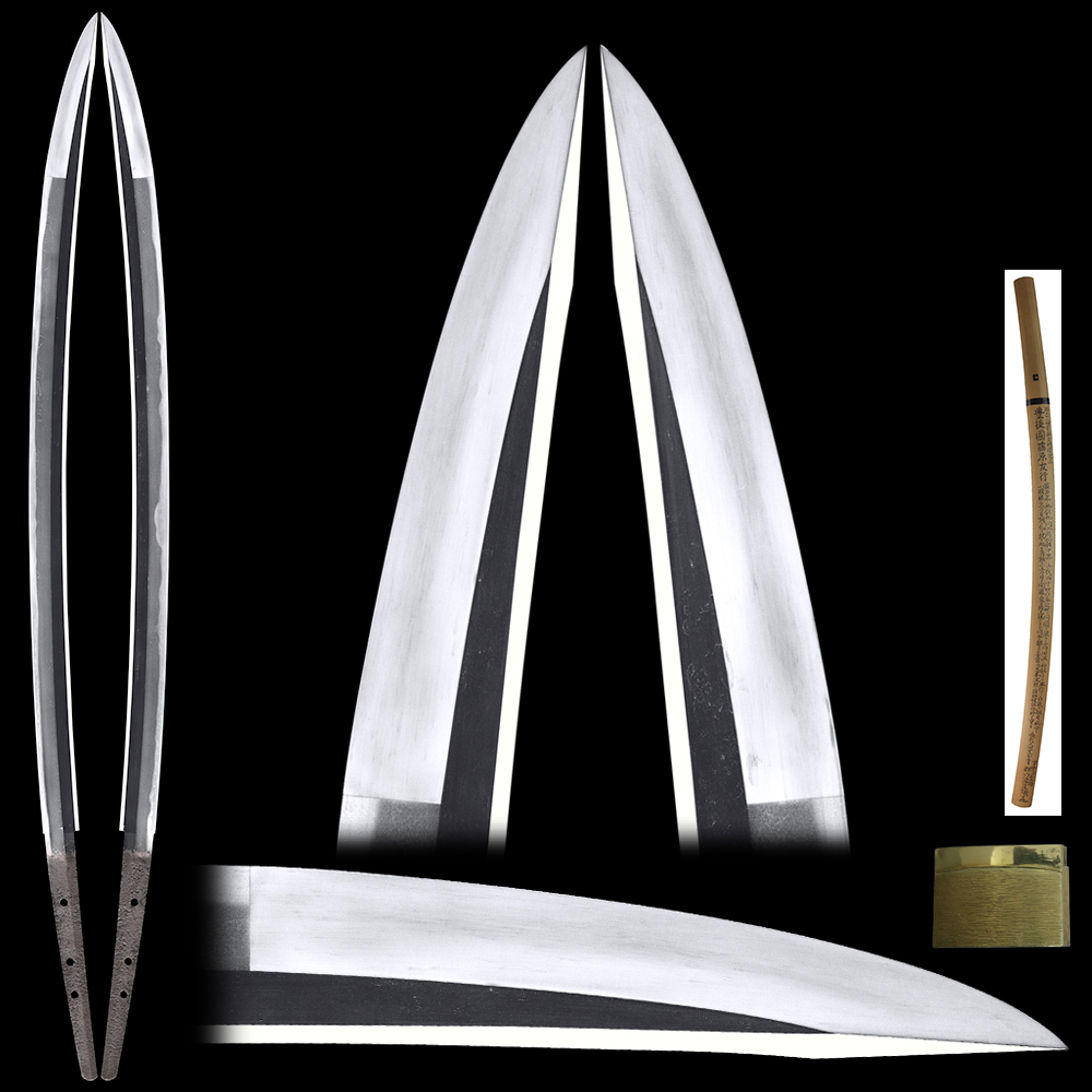

Lukas Posted March 16, 2018 Report Posted March 16, 2018 Hey there, As I'm quite new in the nihonto world I require som advice regarding a wakizashi. Certificate: NTHK (Nihon Token Hozon Kai) Certificate date: 16/7-2017 Signed by: Chief Executive Officer Teiji Miyano Forge: TOMOYUKI Province: Bungo School: Takada Era: Muromachi Year: Bunei 1469-1486 Leaf style: Shinogi Zukuri Iorimune Kitae Itame Hamon: Suguha komaru gaeri Mekugi ana: 1 Full Length: 65.5cm Wakizashi: 63.5cm (sword) Nagasa: 43.5cm (cutting section on the blade) Sori: 1.1cm (curvature) Tsuka: 18cm (handle) It is offered at 1600 usd. I would be very grateful If there was anyone who could give there input. Thank very much. Lukas Gerdin Quote
Ray Singer Posted March 16, 2018 Report Posted March 16, 2018 It looks like a nice package Lukas. There are areas of rust. How serious is it? With rust, it is not possible to selectively polish just that area. A full polish will be needed if you want to address that issue (you may alternately choose to accept and leave as-is if the rust is is not active). If your intention would be to have the sword polished after purchase, then factor in the additional restoration cost which would be more that the stated purchase price (factoring in shirasaya and tsunagi). Are there any major flaws in the sword? https://www.japaneseswordindex.com/kizu.htm http://www.ksky.ne.jp/~sumie99/flaws.html 1 Quote
Stephen Posted March 16, 2018 Report Posted March 16, 2018 Agree with Rayray, nice reasonable package. A togie can neutralize the rust with a burnishing tool if not to extreme (not shown in pix) otherwise just keep oiled. down the like if you really want it preserved send for full polish. 3 Quote
TheGermanBastard Posted March 16, 2018 Report Posted March 16, 2018 Lucas, it is unfortunately not possible to give you a reasonable advice based on these images. Neither can we really say anything in particular about the blade nor do we see the Tsuba or Menuki. It is standard Handachi mounts. Bungo blades are not in high regard on many occasions. A new polish is not recommend. The total cost would be above what this blade is worth. The papers are not a real benefit with such a blade. The asking price is fair. But again you need to ask yourself wheter the blade appeals to you. Buy what you like. 1 Quote
TheGermanBastard Posted March 16, 2018 Report Posted March 16, 2018 To be frank I would not buy it. There are for example some papered Hizen Wakizashis by reputable members like Ray and other up for sale that offer much more bang for the buck even if you will be looking at close to 3k investment. But the quality of the blades will easily stand up to their asking prices. Quote
TheGermanBastard Posted March 16, 2018 Report Posted March 16, 2018 And one last thing: You have to keep in mind that you will face additional import duties / fees when buying a blade from outside the EU. so be prepared to spend an additional 20% on what you pay. Quote
Stephen Posted March 16, 2018 Report Posted March 16, 2018 ON the other hand some do value Bungo and collect them as they were often sought by samurai as reliable blades in battle, Weigh your options for best results. first off more pix of rusty areas and if any more not seen. 1 Quote
Guest Rayhan Posted March 16, 2018 Report Posted March 16, 2018 I think the main issue collectors face with schools like Takada is the difficulty grouping them and classifying them much like in Kantei. Takada made swords for war and for that function they utilized many skill sets that produced swords of varying traits. Example attached is an Okissaki, gunome/notare and choji hamon,itame and mokume hada, length 73cm on the Nagasa. It's a quagmire of skill and function and yes in hand it is a masterpiece (Juyo). Always judge a sword by it's merits for even Masamune had bad days or "yucky-ire". Long live unpopular schools.pdf Quote

nagamaki - Franco Posted March 16, 2018 Report Posted March 16, 2018 Quick 'buyer' thoughts, reasonable price, signed & papered, koshirae, on the short side, out of polish, flaws that will not polish out , looks like hamachi may need to be reformed, *shape based on these images unimpressive imo (collectible swords begin with shape), quality based on these images is still a question. * how and would a new polish change the shape? Quote
Guest Rayhan Posted March 17, 2018 Report Posted March 17, 2018 Hi Jay Did the pictures not show up? More to topic I also think the sword needs work and that will affect the overall investment which may not be recovered in the case of this Tomoyuki. So if you were buying it then it was a purchase on an item you love and will keep rather than to study and sell later. Quote
