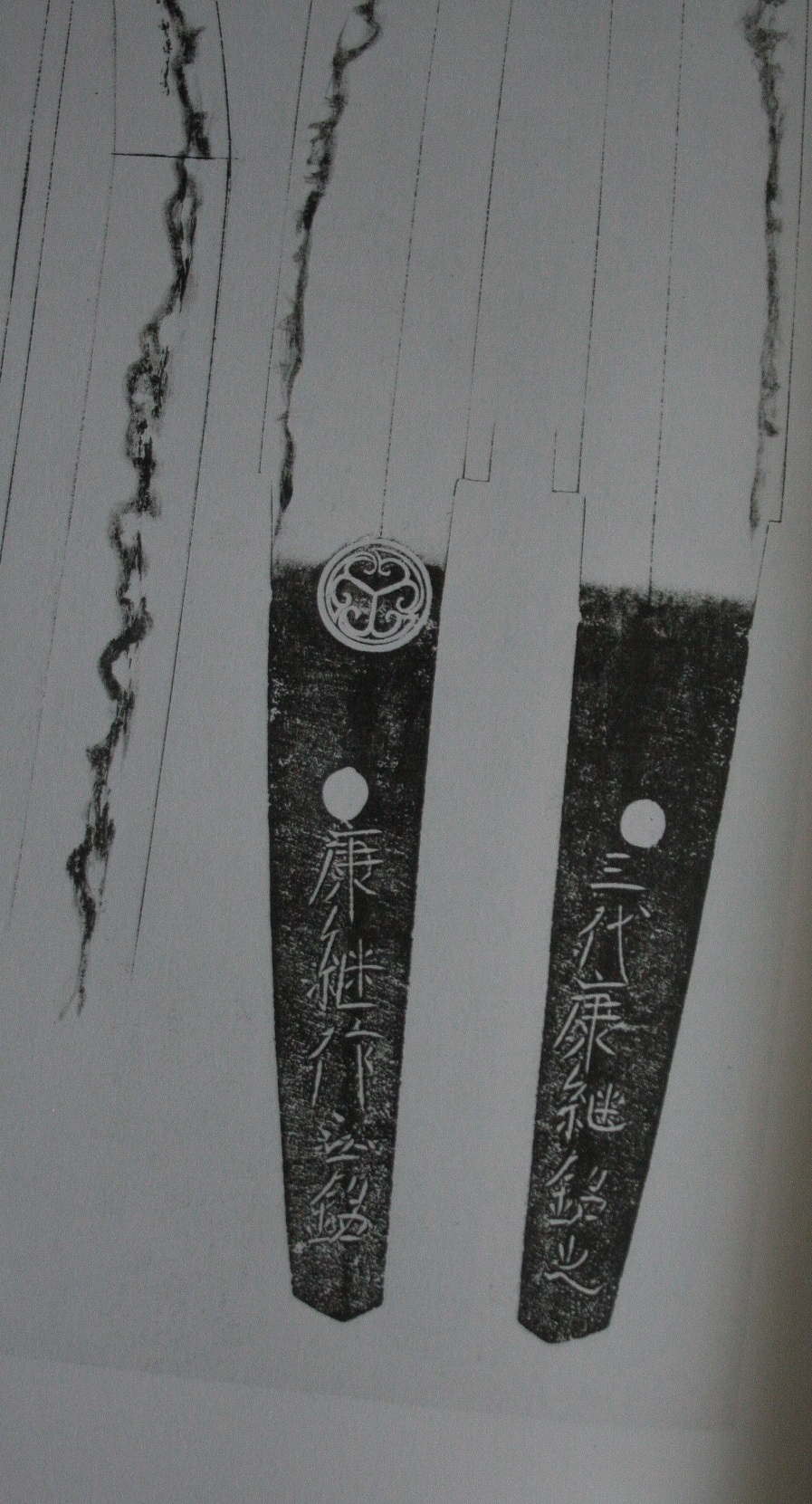

I think the kikumon on the blade on the left has been added. Mon on the right is from a NBTHK papered Wak, 1’st generation Hisamichi. Blade in the left has not been through shinsa. I’ll post a follow up photo of the two signatures . I considered starting a thread for just Gemei signatures. We could possibly gain something from comparing multiple gemei’s to each other rather than to legitimate signatures.
Jim
