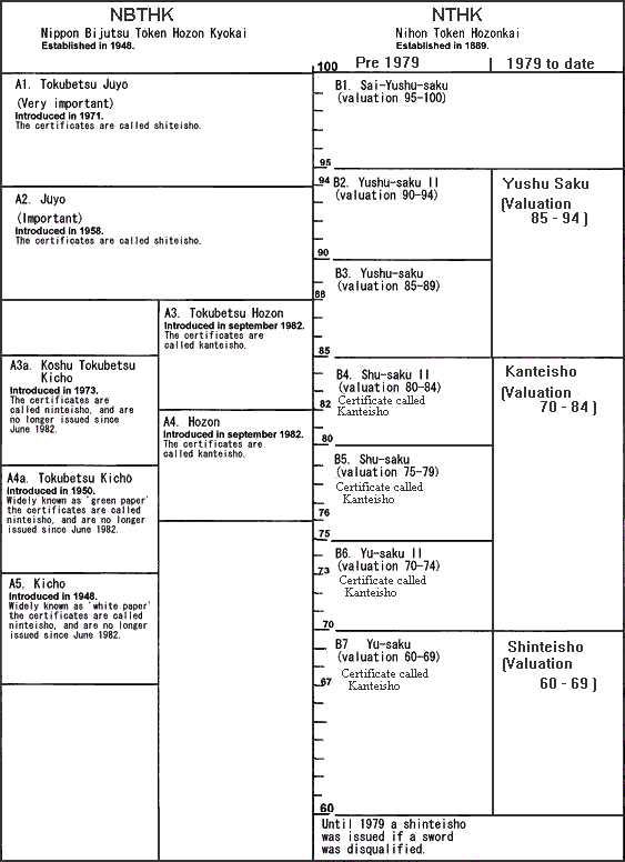

Not sure on pinks, but as I reported from Chicago last year, the other NTHK group didn't have much of an appreciation for gendai (including Meiji) work and all 6 blades I submitted received 70 points. The NPO this year gave the Tsukamoto Masakazu and the Yoshihara Kuniie (sosho mei) 76 points each and my Shigemasa tanto 77 (firmly in TH level comparatively to NBTHK).
My understanding was that NBTHK Tokubetsu hozon is in the 80's point wise, not 70's that's comparable with hozon.
Not quite accurate. See here for an explanation:
https://www.facebook.com/groups/1728933930663768/
Hello Chris,
I got this list from Jean. Besides from a collector standpoint NBTHK Tokubetsu hozon certificates are regarde higher than NTHK kanteisho, especially after the split. It's quite obvious that blades or fittings with TH command higher prices than NTHK kanteisho.
In my limited experience I have noticed that collectors and dealers equate the NTHK kanteisho with the NBTHK hozon level.

Personally I don't agree with them not being reliable, I have NTHK NPO certificates myself. I do consider them to be comparable to NBTHK Hozon level though.
If I'm misunderstanding something here, please explain so I can correct my view of the NTHK NBTHK levels. Thank you.
It is all opinion, and everyone is entitled to their opinion. One needs to keep in mind which market the organizations cater to primarily: NBTHK shinsa was set up to accommodate dealers, who are still their primary customer base. NTHK-NPO is geared more towards collectors. If you compare the information contained in their kantei-sho, I think that will be obvious.
Personally, I know the judges on the NTHK-NPO shinsa team, and I know their backgrounds and experience. I know their head judge has won more kantei contests than anyone alive and having known or met most of the top experts in Japan over the last 25 or so years, I can't name a single one who I think is clearly more knowledgeable in general than Miyano Sensei. Everyone though has their favorites, their own opinions.
As for the NBTHK, I can't name a single person on the NBTHK shinsa teams so I have no way to judge their backgrounds and experience and thus the current value of their opinions.  Brand names are very important in Japan, but reputations can and do come and go. A brand can only handle so many scandals; the NBTHK has lost members and its reputation has taken a hit among the collector community in Japan. Of course, Tsuruta and other dealers will and must support them for obvious reasons. Believe me, not everyone shares his opinions and their name/kantei-sho are not everyone's gold standard. Sometimes perceptions and reality can and do differ.
What I have told people in the past is this: if you buy swords for investment purposes, or are a dealer, go NBTHK. If you want to learn about your sword, go NTHK-NPO. Of course I reserve the right to change my opinion as future events unfold...
That is about as far into the NBTHK vs NTHK-NPO debate I will wade. I hope that at least provides you with another pespective.

I had a signed Wakizashi which passed NTHK NPO kanteisho, then I submitted it for NBTHK and it came back as gimei!?
I was surprised about that discrepance.
Don't be, it is quite common.  It happens with papers from all issuing organizations, opinions vary.  That is why those papers you have are not a guarantee !  They are a educated opinion.  These guys, be it Tanobe, Miyano or other's give you their opinion based on a lifetime of study.  They are the best opinions you can get, but they are opinions.
