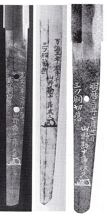

Forget the blade!  I need the translation for the Kakihan!!! Ha!  Just kidding (ok, maybe not!).  Classic Neil-style drop dead gorgeous!  Someone spent a pretty penny fitting this one out.
I got the date down: Manji 3, so 1660, Nov 10th.  Will need help with the rest though!
万治三年十一月十日
三ツ胴截断
山野勘十郎成久(花押)
The on in the middle has same Mei

41 minutes ago, BANGBANGSAN said:
万治三年十一月十日
三ツ胴截断
山野勘十郎成久(花押)

November 10, Manji 3rd year Mitsu body cut off Kanjuro Yamano Naruhisa (Kao)
per Google search

7 hours ago, Bruce Pennington said:
That’s honestly very kind of you Trystan, but I can’t read your Japanese print any better than I can read Japanese in the Nakago!
This sword passed 3 bodies through cutting test.
Yamano Kanjūrō Narihisa  performed  the cutting test.

6 hours ago, Bryce said:
G'day Neil,
Now that is a high class gunto! Who made the blade?
Cheers,
Bryce
I thought it was made Yamano Kanjūrō Narihisa 山野勘十郎成久. John corrected me, 山野勘十郎 is not a sword smith but a professional cutting tester and executioner.

27 minutes ago, PNSSHOGUN said:
That is the name of the Samurai who performed the cutting test.
John
Thanks for correcting. 山野勘十郎 is professional cutting tester and executioner.
「江戶初期,有名的試刀家是谷衛好、谷衛友父子。衛友的弟子中川重良兼任幕府的旗本(家臣),他的弟子山野加右衛門永久被認為是最早的專職試刀家,據說他試斬了6000多名罪人。永久之子,山野勘十郎久英,不但擔任幕府御用試斬官,也負責處決死刑犯。也就是說,先砍了頭,再把屍體搬來試斬,他一個人包了。但久英的後人沒有能夠掌握這項技術,之後山野家被解除了職務」。

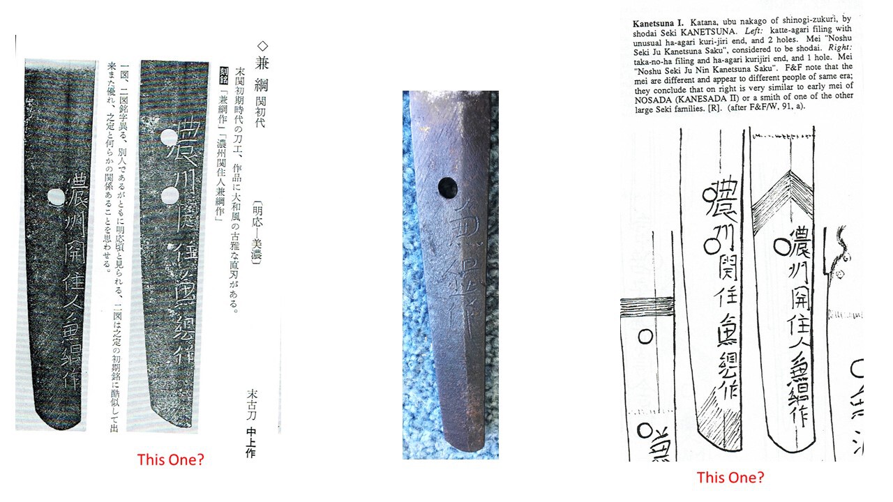

Another old blade, this one in KAI GUNTO Navy mounts, at 52 cm some would call this (wrongly) a submarine crew sword, due to its shorter length. The large ray skin "eyes" on the SAYA are quite unique.
I think it is made by KANETSUNA in the 1500's, but I am open to more knowledgeable translators.

That it a nice looking sword Neil . I have difficulty seeing Kanetsuna there and if I had to guess might say Kaneyoshi . Why don't you put it up on the translation page and see what others think .

Ian, thanks. The mei was translated from the FUJISHIRA book. The odd style KANJI is a type of the period, 1400-1500's, and no longer used.

A difficult mei.  The best we could do was  late Mino (Sue-Seki) Kanetsuna in Fujishiro (1991) Nihon Koto Jiten page 85 with trans by HA watson .
And also that strange mysterious book Mino-to (1993) by Malcolm Cox  page 213 end of Koto.
