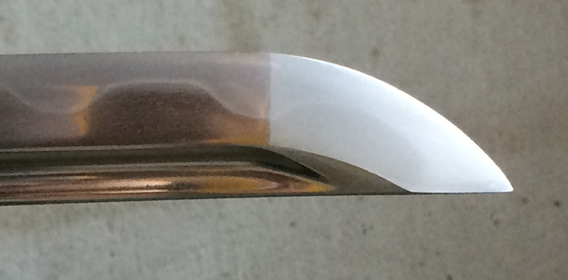

hi this is my first time here and am hoping I might be able to find help or advice about a Japanese sword I recently purchased. the sword is said to be made by a famous smith in Japan around 10 years ago but it wasn't up to the usual standard he produces so he didn't sign the blade and presented it as a gift to the person that sold it to me. I would love to find out who the mystery smith is if anyone has any ideas. I realize it may be a long shot but here are some pics incase somebody recognises the style of blade or anything else that might help me find out more. thank you

This sword doesn't look to me like it was made in Japan: crude koshirae, no hada, very tight nioiguchi, uninspired hamon. Sorry for being so blunt, but it looks like an early Chinese production sword à la Hanwei.

The way the handle is wrapped is wrong.
Sword is not from Japan.
Im sorry , hope You didnt give a fortune for it.

I would think the same as Guido. My guess would be a sword from companies using Fred Chen/Huanuo from the early 2000's. That was long ago when I was starting my collecting as young kid so I can't remember all the models from to of my head.
My guess is it might be Cicada Forge or DGuertin. Both made good quality reproductions but both companies went under over 10 years ago (at least that is how I remember it). You can search their sites through wayback machine (Internet archive), and old posts at SFI.

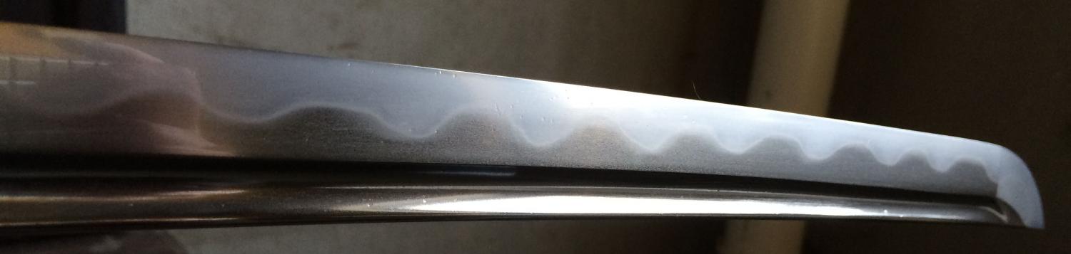

Thank you all for your input. The hada is konukahada with little itamehada but it might nog be easy to see in the pics I have. Will try get better pics up soon. The hamon is widely gunome. The koshirae is a bit crude but either way I'm just curious on people's thoughts as I really like this blade and feels great to use so want to keep it in my collection regardless of worth or lack of haha

Hope you didn't pay too much for it... I agree with the others in that it may not be a traditional shinsakuto

I think a few better pics of the hada is important before making a call.
Personally I think in this case this might be a legitimate Nihonto. . .
The Koshirae is definately lowest (bottom of the barrel) grade possible for chinese junk. . . although I think someone might have had a shot at the tsuka. But the blade is of too high a quality to have started life in this tacky outfit.
sooo judging the blade on its own merit, the polish is good, bohi is good and not representative of standard chinese production. This style of hada does not appear on production blades. The notare hamon can be found on chinese blades as can a tight noiguchi. . . but I have seen a couple of Yoshihara blades with a tight noiguchi.
Nakago could have some better pics but from what I can see it isnt unreasonable to consider it might be legit.
Conclusion. . . need better pics without pixlation.

The nakago patina looks like it was heated with a torch after yakire to soften it for drilling.
The hamon is so typical of a shopping mall knife store sword.
That being said better pics couldn't hurt.

I think it's a good sword. I still think that it's made by Cicada Forge. They used Fred Chen, and I tend to like some Fred Chen blades.
Now that I got home I can provide some reasoning why I think what I think. I guess Cicada Forge died in 2007 but I was able to find some pics through the Wayback Machine.
At Summerchild Polishing, look at the hamon: http://www.summerchild.com/itemcom1.htm
FS, at Myarmoury, look at the hamon + same F&K: http://www.myarmoury.com/talk/viewtopic.8943.html
Some old pics of Cicada Forge line up: http://web.archive.org/web/20050204221611/http://liveblade.com/cicadaforge/iaiyoavailable.html, http://web.archive.org/web/20060805132858/http://liveblade.com/cicadaforge/liveswords.html Cicada Forge offered custom swords, wo you could choose the parts.
Many Fred Chen swords back in c.2005 had similar hamon style. I think the F&K might be Fred Chen "exclusive" as it can be seen on several manufacturers who used Fred Chen for example DGuertin/Oni/Kensei.
I think it's monosteel, so no hada. I believe that the effect you see on the blade is created by skilled hybrid polishing. Those skilled in that art can make "hada-like" surface to the blade. I bought an used Paul Chen PPK for 150€'s that looks like it has tight hada. See the pic attached. That is achieved by skilled hybrid polishing on a monosteel blade which in reality does not have hada.
In general I think nihonto collectors give too little credit for these production blades, some of them are actually darn good for what they cost. I will say I have bias for them as I started with them as young kid.
Better pics will of course help, and I can and I will change my opinion if I'm proven wrong. :laughing:

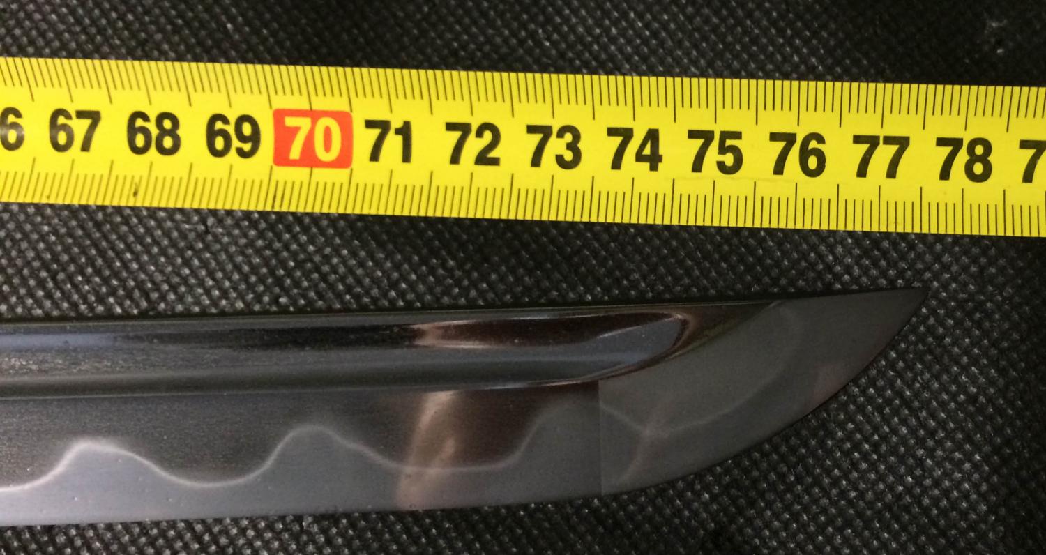

Ok Kam I'm doing my best to take some better pics. I've only got my phone camera and torch so it's challenging but will have some up today. Thank you

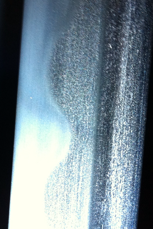

Ok this is the only pics that didn't blur as its done with an old iPhone. may try for more later.  Thanks

Hey Greg
Thanks for posting some more pics but I think I am less informed (if it is indeed possible to retro grade in information) of what this sword is.
I do think a few pics of the nakago would be helpful.
These pics imply a possible result of manufacture in which the large grinding marks are not fully removed as they skip from something like 80grit to 360 grit and then through each stone to the final 2000 grit (production pieces). On the other hand it may very well be hada that is visually distorted via the pics.
Kam

that hamon is deader then christopher reeve's, legs.
im with the other posters, im sorry but not Japanese IMHO

The hada reminds me of thermal alloy banding that can be produced by certain methods better left unsaid. I am not stating that it IS definitively, of course! :laughing:
