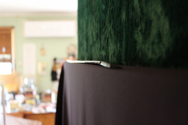

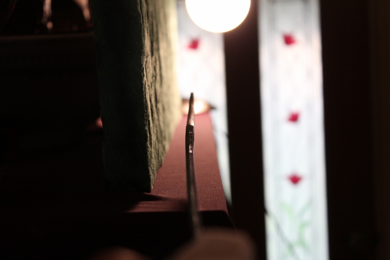

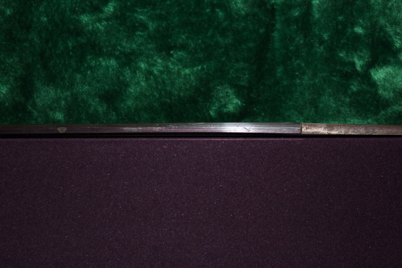

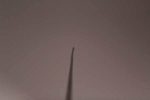

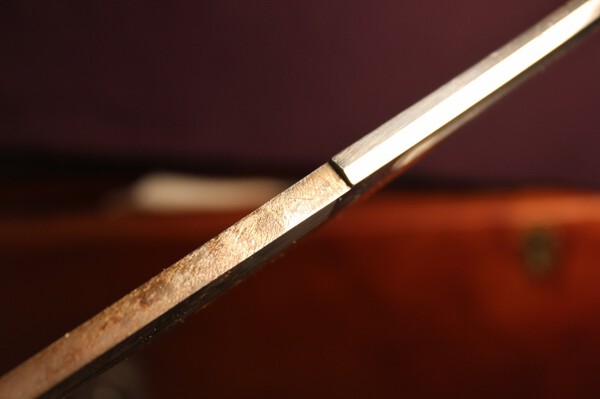

and it only gets worse, the was returned to day with no paperwork or fail card evan though I was told it would be sent back with the sword.  BBBBBUUUUUTTTTT it did return with a considerable bend, 1inche infront of the habaki moto area, WTF.
has any one ever heard of this??
and before any one asks, yes this sword already had a small deflection in the area just below the yakote line (2inches below) it was shown on the board when I posted it for sale hear.
but how the fu## did this happen?, the box is in the same condition when I sent if, all the fittings are good, so how the fu## did it occur

Sorry to see that its been damaged, it has to have happened outside of the saya so Japanese customs must be to blame.

I spoke to a trained togishi, and he was puzzled to how it could happen, as its the strongest portion of the blade.
good news as it will only be a small amount of money to repair. but im done with ebay and selling anything or sending it to Japan now.
