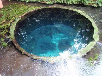

Now, I've heard the line about the water temperature being the same, and the color of the moon in autumn, and other romantic imagery… I don't know how common such concepts actually were among historical smiths, it seems to me that it gets repeated a lot more because of its dramatic power than because it accurately reflects the historical attitude. (EDIT: to be clear, I am not saying that these ideas are modern inventions; I am only arguing that they are repeated in modern sources disproportionate to how widespread they were historically. Also, smiths certainly did look upon forging blades as a somewhat mystical and spiritual practice, no question; I am only talking about the water temp. & moon color quotes specifically.)
Given that February is coming to the end of winter and August is the peak of summer, I don't believe the water temperature theory.
In February, the average temperature is between freezing and 11 degrees celsius. In August, it is between 23 and 32 degrees celsius.
Brian's theory makes much more sense to me.
Wakimizu 湧き水, spring water, doesn't change temperature all that much throughout the year.
So surely that means that the February/August temperature is not so important?
Besides that, isn't it the case that quench water is heated to the right temperature anyway to prevent shocking the blade during yakire?
So it would seem....smiths make blades now all year long, well, not so much in summer...
Never seen that done...I never stuck my hand in the trough though, not wanting to get it cut off... :lol:
