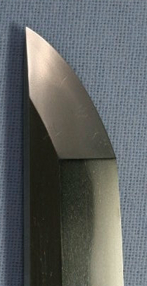

To comply with Jean's demands (haha):
Nagasa: 68.5 cm
Kissaki: 2.6 cm
Sori: 1.8 cm
Sakihaba: 1.7 cm
Motohaba: 2.7 cm
Nakago: 18.5 cm
Yasurime: kiri, sujikai on nakago mune, ha, and jiri
Nakago sori: 2-3 mm
Shinogi width at moto: 1.0 cm
Shinogi width at saki: 0.6 cm
Riddle me this one, wizards! No bias, not my sword.

Unfortunately, the only picture we have is very low resolution (rather blurred)
The Nakago seems only slightly shortened, the suguta and sori made me think of a Shinto +/- 1700 AD blade (post kanbun).
Let's see what other NMB members think.

Still late Shinto sugata? :-)
Late shinto sword I would expect:
- little taper
- more curvature than a Kanbun piece but not much curvature
- chu kissaki
- length is longer than Kanbun pieces in general, about 70cm
Typical measurements would be something like a 3.1 or 3.2 cm motohaba going down to a 2.2 or 2.3 sakihaba. This is 2.7 down to 1.7. A Chu kissaki is around 3.5 cm. This one is 2.6 cm, which is closer to a ko-kissaki than a chu-kissaki. The Sadazane on the left has an ikubi kissaki which is middle Kamakura style, it is about 2.1 cm. Overall the style of the Sadazane is early Kamakura.
I think this might be an early Kamakura blade cut down, which is why it has lost the former mekugiana and is only showing one.
I can only think of one reason why an entire nakago would be refinished like this and it would be to remove a gimei. This was done a long time ago though and I think back then they'd be promoting the gimei rather than removing it heh.
Anyway I'm basically looking at the taper, curve, and size of kissaki and thinking it is Kamakura, possibly early or late as the late blades took the example of the early ones. Think it was just long, was polished many times, then cut down relatively late.

Peter: late shinto? ;-). Sounds like a trick question now! I would think from the look of the sword it is a Muromachi uchigatana.
Can you give the rest of the measurements? Ko-kissaki should be 2 cm or less I think.
Sorry updated the measurements. It's a Jiro Taro Naokatsu :)
