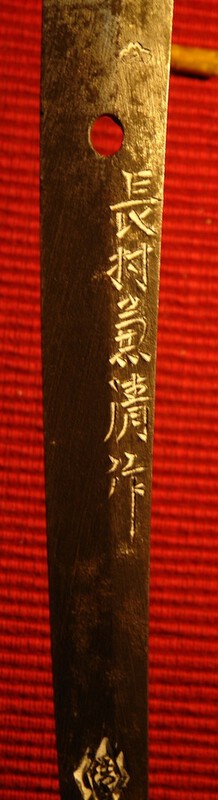

Thank you John and Chris.
It was only now, that I believed I had seen this, or its twin somewhere before? The The "Kiyo" stamp gave it away, its on the board in the thread Arsenal stamps.
