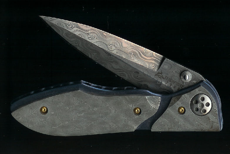

Nobody Posted June 28, 2007 Report Posted June 28, 2007 I am still unsure of the tanto. The shape and its nakago look OK to me. But the hada looks strange. The pattern looks regular Mokume rather than Ayasugi. I think that the bull's-eyes are too strong for Ayasugi-hada. That looks like a modern stainless damascus pattern (refer to the attached photo: sorry it is not a nihonto but my knife.). I knew the method to forge Ayasugi-hada as Guido explained. But I do not think that the bull's-eyes do appear with the method. Quote
