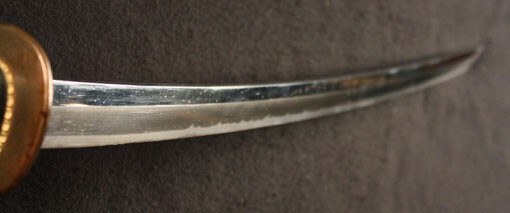

Darcy Posted November 7, 2013 Report Share Posted November 7, 2013 Deep curve in the area of a nakago does a few (objective) things and I think helps answer some questions. 1. in a tanto, a mete-zashi in this case, makes it easier to get at and draw the weapon. Form following function here it is clear they were thinking about the draw. 2. if you ever tried to draw a 90cm blade for inspection you encounter a math problem in regards to blade length vs arm length. There exists a certain straight blade of length X where a man with arm length Y cannot draw it and maintain an attachment to the saya. Arm is not long enough to get it out. (One solution is to drop the saya or leave it with a retainer, but I think this is a Nanbokucho period enhancement). 3. there exists then a borderline blade where one can just get it out, but in order to do this you need to maximize the distance from the mouth of the saya to your hand this necessitates breaking your grip with the lowest fingers of your hand (or your wrist joint), and the longest possible blade you can draw you would be holding between finger and thumb joint. If you curved the nakago though your lower fingers would still be grasping the tsuka. 4. now, perform this exercise. Place the first two fingers of your left hand like they are a nakago into the palm of your right hand, palms facing down. Extend both arms in front of you to maximum extension. This is about the length you'd be hitting of a max length blade to draw. Push them as far out as possible and release. Note the shape of your left arm (straight) and your wrist joint and fingers. You just traced out koshi zori. Especially while your fingers are being held by your right hand. Basically koshi zori allows you to maintain full control of the nakago of a longer blade than you can draw otherwise with a straight nakago from the edge down position. 5. thus, adding curvature to the nakago to an otherwise perfectly straight blade allows you to draw and use a longer blade. And we know they were thinking of draws with the mete-zashi tanto. So when we look at evolution of sori we (in my opinion) need to not start from the first curved blades but we need to look at the first straight blades and see where the areas of experiment were. In my opinion the curve begins arriving as a practical feature to assist the draw and thus allow the user to have a longer sword than the opponent, a longer sword being seen as an advantage where you can strike and not be hit at a certain distance. Another aspect of the curved nakago becomes evident in two areas: 1. an extended blade, a curved nakago braces against the lower forearm and wrist in a one handed position (horseback) which may be more secure for certain moves. 2. vs. a straight sword, the blade will be further away from the target in the same arm position. This means when rotating the arm through a strike, the sword with a curved nakago will strike later, giving the user more time to accelerate the blade, and this striking at a higher speed. Higher speed, more energy, more force, more damage. The more you curve that blade back the more stroke you will make in time for impact. If you are looking for impact only and not considering slicing (and straight european blades can easily hack off a limb without any curve at all), then a straightish monouchi is perfectly fine and in fact may convey more force at impact than a curved blade (which will slice more). So four distinct advantages arrived from a koshi zori blade with deep curvature at the nakago. In my opinion then this is why the curved blade arrives. 1. you can draw a longer blade 2. longer blade means you can cut and not be cut, and furthermore generates more energy at the impact point (one reason why tennis serve is 160mph and baseball pitch is 95mph) 2. you can brace it against your forearm for more control in some instances, as well as less tiring on the small muscles of your arm 3. arm rotates longer before impact given the same start position, which increases the energy that can be stored in the sword at the time of impact, for more impact force The rest of the story is one of refinement of the curve for various needs (on or off the horse, increased slicing vs. just impact, etc). Moving the curve up the blade from the nakago area increases the ability of the blade to cut vs. chop. Once the theory is introduced that some curve is beneficial, it's natural that through trial and error with a mindset to experimentation, the curve will migrate up the blade. As the need for the blade to become longer and shorter comes through time, it hits the reset button on the ideal position of the curve of the blade. Technique changes with the blade size changing and so the ideal position of the curve moves along with it to adapt to technique. You always have to book some time in there, decades, for things to evolve. So you will see conservative and liberal schools of thought which exist at the same time in competition for the future (always happens). Eventually the better design wins out which eventually becomes yesterday's design for whatever reason. Just my thoughts on it an analysis (kinda speculative). All criticism welcome. Don't have time to argue it out so will let your comments stand unchallenged. Link to comment Share on other sites More sharing options...
Ken-Hawaii Posted November 7, 2013 Author Report Share Posted November 7, 2013 Darcy, I'm really impressed by your analysis - thank you! I hadn't tried to visualize koshizori & its application in the way you describe, but it makes a lot of sense to me, both as an engineer & as a long-time sword swinger. And that also helps me to figure out how & why the migration to toriizori with the shorter katana was a natural evolution. Nice job! Ken Link to comment Share on other sites More sharing options...
