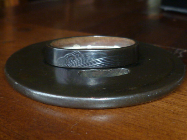

By no choice of your own, sometimes you have to mix the old with the new. I spent a year mithering the hell out of everyone (and i mean everyone) about an early yamagane fuchi for a tensho refit. Its a real pain in the ass sourcing period parts, kind of makes you feel like a bit of a nuisance :crazy:!. On a good note, i only needed a tsuba/fuchi. In the end i threw in the towel and decided to go with most folks advice and have a new fuchi made to match the patina of the muromachi tsuba. In the end, im more than happy with the fuchi, great to have something made by true artisan and it gives the koshirae a bit of a personal touch that was speaking of. As pointed out in the past, it is just an assembly, so no harm making it a bit of your own. I suppose that is why i have now become a bit of a fan of traditionally made modern parts. I may have a tsuba made in the future, but no rush. In the end, would i ever do another refit?, NO lol, fun and educational, but too much unnecessary stress, lifes hard enough :D.
Alex,
that fuchi turned out great! congrats, mate :clap: I am sure with a horn kashira and some good, restrained menuki your Tensho koshirae will look great! Can't wait to see the results, please don't forget to send pics to the former owner of your excellent old yamagane tsuba ;-)
Sorry for hijacking the thread a bit... But Alex's example should be encouraging for the OP.
BTW, a horn kashira is often a very good way to go, especially when you have a fuchi that you like and for which you will most likely never find a matching kashira...
A restrained koshirae (e.g. Tensho-style) does not need to cost a fortune, unless you insist on mounting an expensive tsuba. A plain iron sukashi tsuba (Owari/Higo/Akasaka inspired) or plain yamagane ko-kinko tsuba will do the job credibly.
