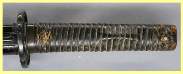

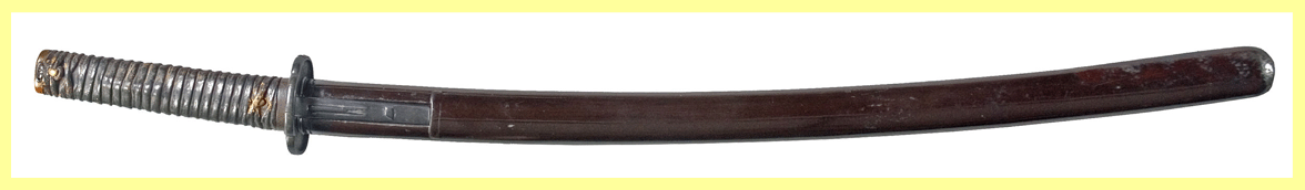

Below are some images of (I believe a Juyo) set of Muromachi period Koshirae that Fred Weissberg was kind enough to send me a while back. The lacquered leather and decorated tsuba pobably indicate it was carried by someone of a higher rank than a regular Ashigaru, but it does have similar spiral wrap and tuba with raised mimi.
Regards,
Lance

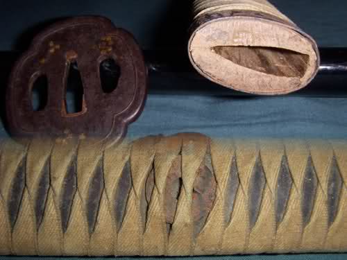

All, I think this image summarises the characteristics of these weapons (I hesitate to use the word sword). The tsuka made from a bit of old saya, mounts made up from sheet iron, the binding done with strips of coarse cloth folded to make a tape and any old bit of something, but usually washers, to act as menuki. Note how the 'fuchi' is just a strip of iron bent around and brazed shut. The one part that always seems to be a genuine sword fitting, as opposed to having been cheaply assembled from scrap, is the tsuba. Whilst typing this it occurred to me that the 'washers' might be old roves from dismantled boats - they generally have the area around the hole distorted as if they have been reclaimed from some other use. Were Japanese boats clinker built?
Ian Bottomley
