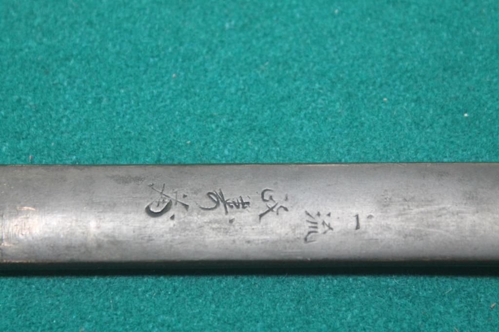

I've got a wakizashi that I believe was used in WW2 and is some what new. I posted a few pics of this sword last year for some help with the translation. I think it is signed by "SukeKuni". The blade appears to be oil quenched and is mounted in antique fittings. The saya looks like its wrapped in burlap and is painted (lacquered?) black. My photography skills are poor at best, so I apologize for the low quality photos. The gentleman that I purchased this from claimed that this wakizashi was indeed brought back from WW2. Just wish I could offer some better pictures.

I don't doubt that it was brought back from WWII as this is mounted for the war, but I highly doubt this is WWII age. I checked Sukekuni on nihontoclub.com and here is what I found - only two smiths using that "suke" kanji.
http://nihontoclub.com/smiths/SUK706
http://nihontoclub.com/smiths/SUK709
If I were guessing age, I'd guess shinshinto, so that would point me to the first listed, but given the second - from Kanbun - is of some repute, gimei is not out of the question. Also, the guess is just that, Kanbun is not completely out of the picture.
I'm sure someone more versed in Shinto/shinshinto could be of more assistance.
Edit: Also, I doubt oil quenched, but looks like its just out of polish - and may be a beauty when in polish.
