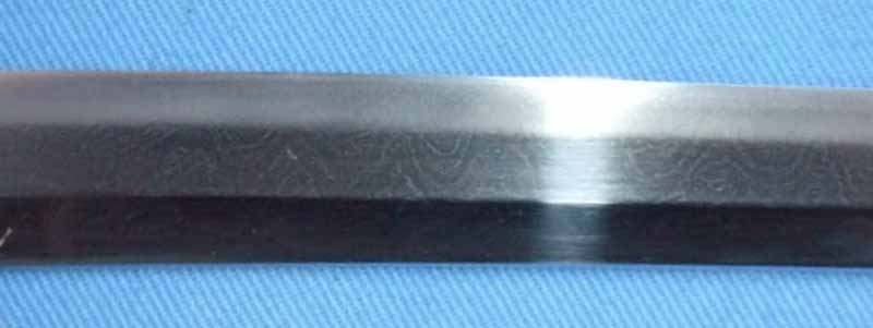

Attached is a photo which shows the shape. Unfortunately due to size restrictions I cannot upload the high-res version which shows the hada/hamon (it is 1.4MB). I am very happy with this sword, however I would just like to know approximate time period. The Gassan attribution was expected, however some people think this is koto while other people have said gendaito.

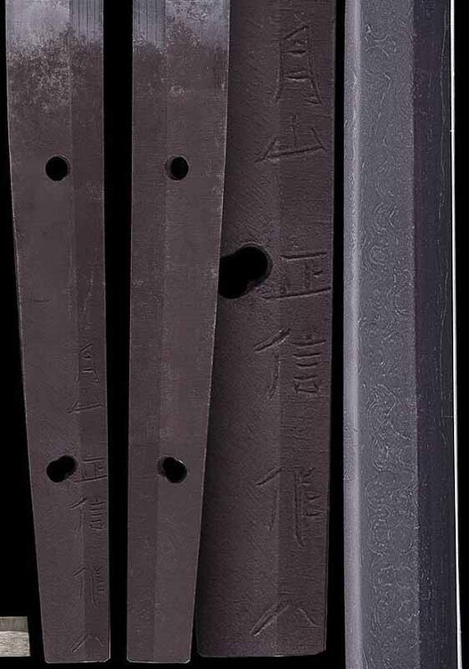

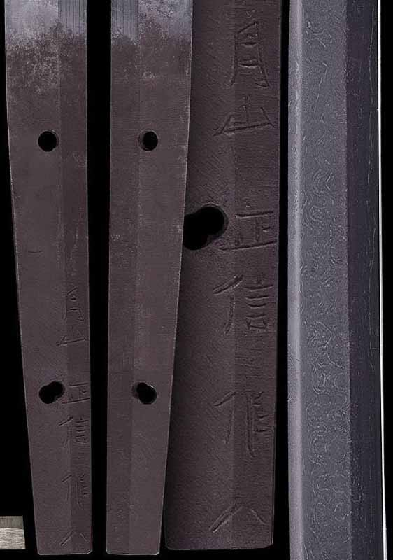

Gassan Masanobu - suriage - 65.1 cm - late Muromachi period, Eisho (1504)

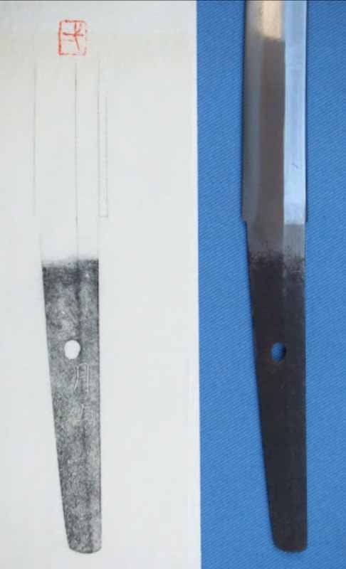

NBTHK origami Ko-Uda

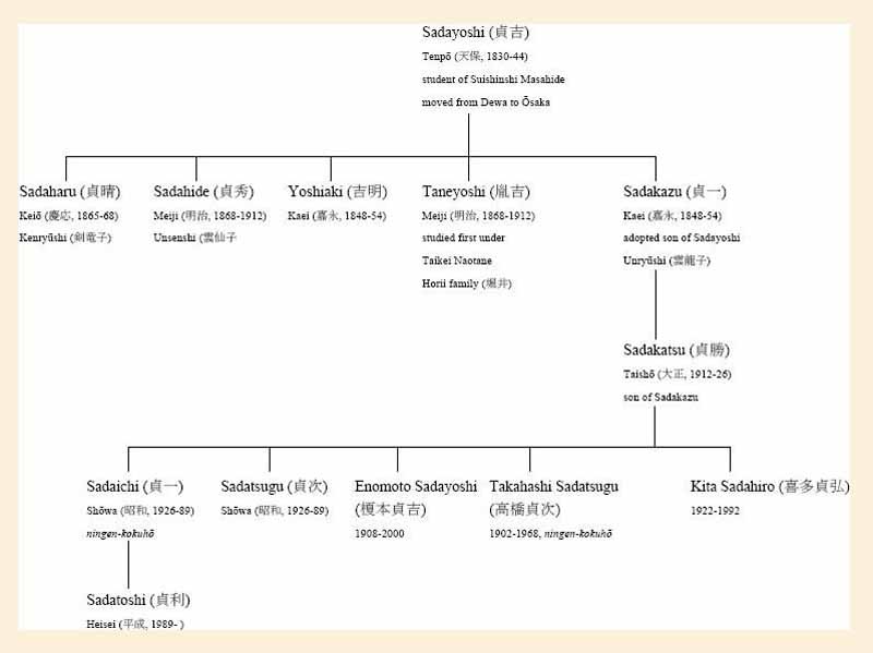

Osaka-Gassan lineage

The provided pic by Justin of the ayasugi hada is too dark so the details are not clearly discernible. I have improved this picture, the pattern is now clearly visible.
Do you still insist on your opinion the blade isn‘t Koto but instead of that Shinshinto or later?

It is difficult to see the hada in my low-res photos. As I mentioned the sword is in Japan so I can't take better photos. Although Eric has improved the images it is still difficult to get an appreciation of the ayasugi hada. It looks worn down, almost like there is shingane coming through in the peaks of the waves (although I have been told it is not core steel, but a characteristic of the hada).
