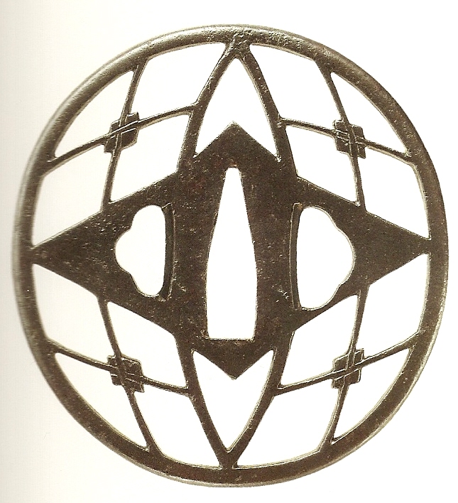

Does someone have a decent scan of the identical one in the Ito book, out of interest? Looking for a larger image of David's too...would like to compare size, features, flaws etc if possible.

The tsuba in the Ito book is not completely identical but very similar in terms of the design, technique, size, and thickness at rim. Once I get home from work I will post higher resolution of my photos. The tsuba has been shipped back to Grey for display at the San Fanrisco show next month.

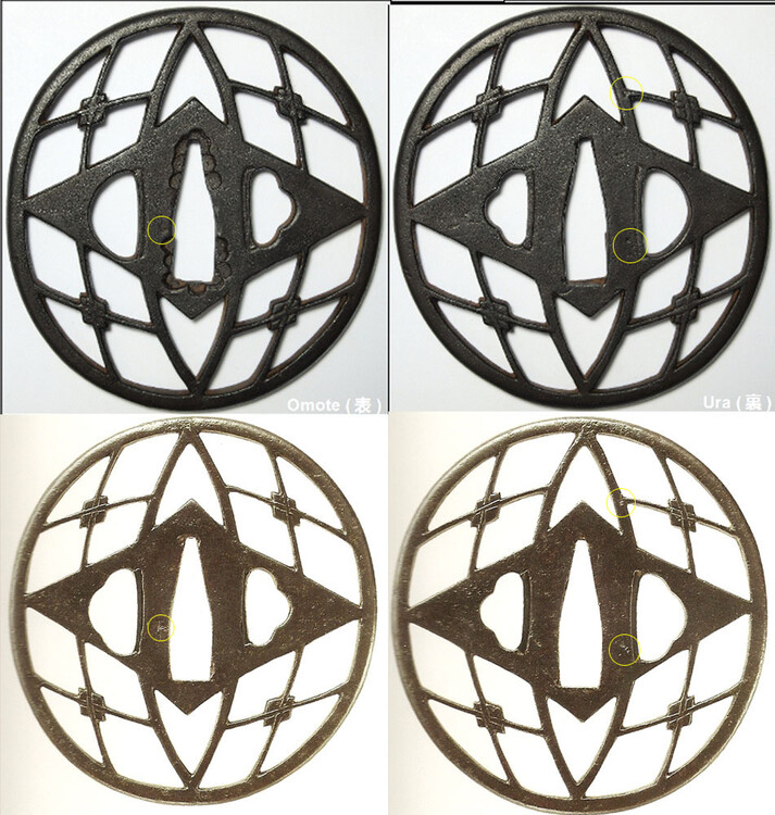

Not sure if this helps or clouds the issue, but here are the comparissons. There are a couple of remarkably similar imperfections or marks that match on both.
Would love to compare exact sizes, as when I overlayed one image on the other, and resized...they matched almost perfectly..particularly the "pillows"
The kogai bitsu on one side was enlarged obviously and the nakago ana had tagane added.
So that leaves a number of possibilities. Co-incidence, a copy of the original, or a casting of the original that duplicated everything including any forging openings on the original. :?:
Repatinated original piece, leaving traces of the solution in the sukashi walls....or cast and patinated leaving the same. I don't know, but those who will get to see it in hand will have a better idea and I hope will update us.
Brian
I would think that as it goes in and is not straight it is a folding flaw rather than anything to do with a casting.
I'm surrounded by hundreds of molds in my workplace. The scalpel cuts are frequently curved and quick consultation with our mold-maker confirmed that if the mold were misaligned during the wax injection a negative space could very well be introduced into the wax casting.

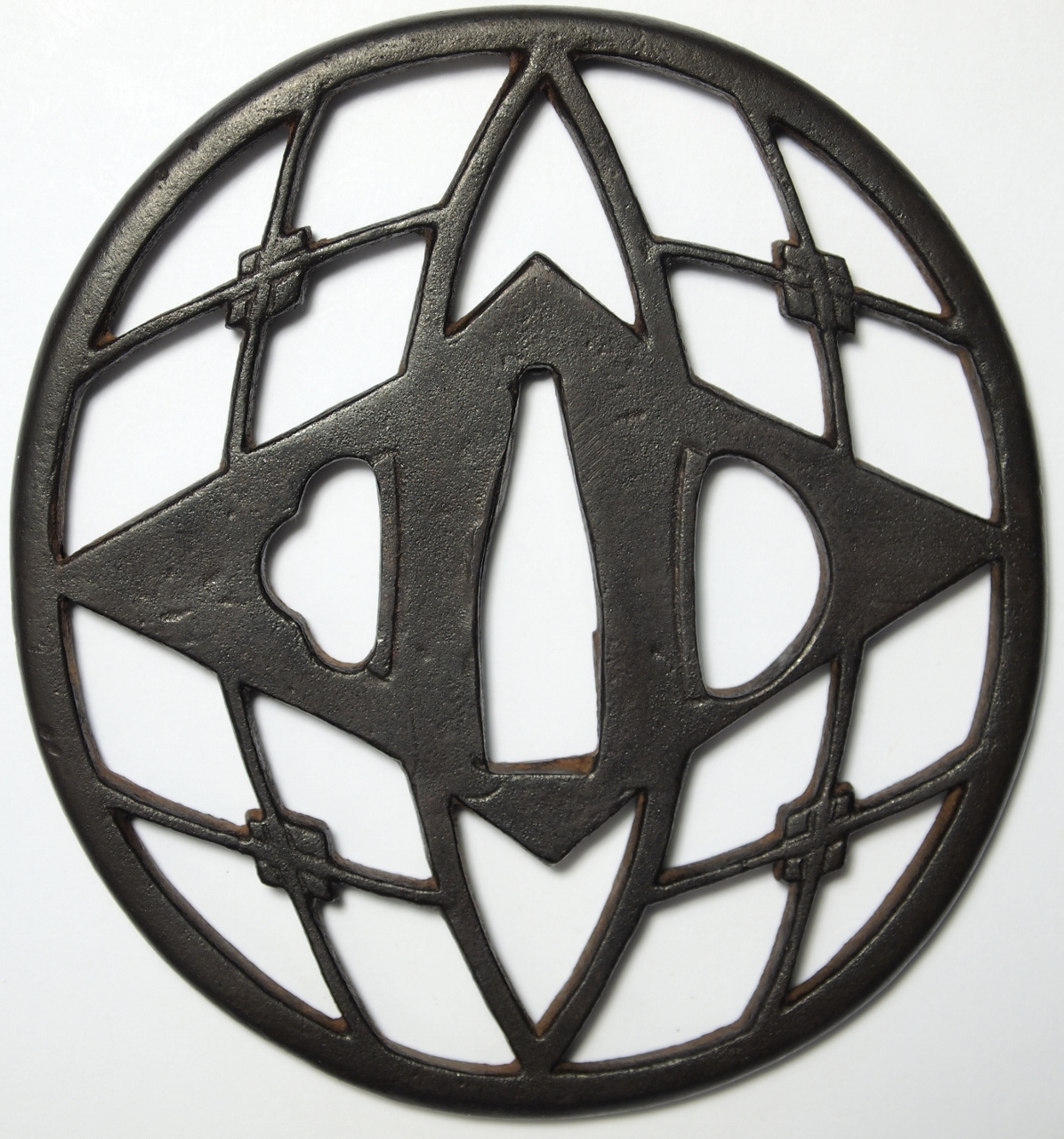

Hi Everyone,
As requested by Brian here are higher resolution images of the photographs I did of my tsuba. You will need to click the links to see each image as they are higher resolution then what I originally posted. I would like to get to the bottom of this question quickly as there are still many nice tsuba on Grey's website that I can exchange for this one if in fact it is a cast reproduction.

I can guarantee that this tsuba isn't a cast copy of the one in Ito's book. I laid the tsuba on the picture in the book to see how close they are. Close, but the angles and open spaces differ a bit, half a centimeter here and there. If it is a cast copy it will have to be of a different tsuba.

Just my humble opinion, Brian's observation and demonstration of the duplicated indentations/flaws is pretty convincing that the tsuba in question must be at least some generation of a cast knockoff of the one in the book. Logic must prevail. I hope Brian's observations are addressed in the final court's opinion.

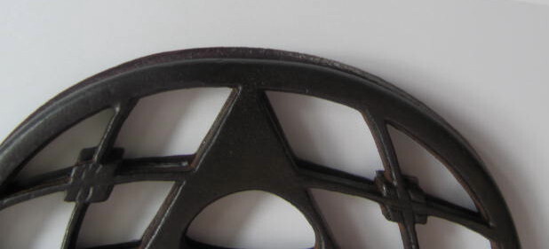

Hi All,
Sorry for coming to this a little late - if you look at the large side on view posted by Brian , looks to me that this piece is showing several signs of having been profile cut .
The apertures are showing witness of lines which are not quite vertical or straight - typical of the 'drag' effect when using a flame to cut metal . This compounded with a consistent band of colouration in the metal strongly suggests a one sided heat source . The opening in the material is also consistent with the effect that a high temperature has on laminated steel - it tends to de-laminate in precisely this way.
It would be a simple job to add the finishing touches to such a profiled piece.
The technology to produce precision profiled blanks has been around for many years , methods used include the traditional flame cutting , plasma ,laser , wire erosion and latterly ,high pressure water jet .The last two are unlikely to have been used with this piece as they would not leave evidence of heat having been used.

I have the tsuba back and can compare it with the one in Ito's book. I'm posting a picture of the tsuba laying on the picture in the book. With the tsuba perfectly centered on the picture there are subtle differences; if I align the edge of the tsuba with the edge of the pictured tsuba the differences are more pronounced. The picture below is with the tsuba centered.
Also, the tsuba in the book has 2 kogai shaped ana and my tsuba has 1 kogai and 1 kotsuka ana. There are subtle tekkotsu on the rim of this tsuba and it rings clear when tapped with a fingernail. Apart from the obvious difference of the punch marks on my nakago hitsu-ana that aren't in the book, the nakago hitsu-ana of the tsuba in the book is 2mm taller than the one on my tsuba.

I don't think we can work off a direct overlay on the one in the book, unless we know for a fact that the book image is perfectly 1:1 with the real one, and that is doubtful. Whover did the casting (if it turns out to be so) obviously had to disguise an obvious comparisson, hence the opening of the kozuka hitsu ana into that odd shape. However to me, this is one of the most telling indicators that this is a cast of the original. You can see how they were unable to get the line of the ana flowing, and it is awkward along the bottom edge. Look closely at the spacing at the top and bottom of both...exact.
The punchmarks were also an attempt at changing the overall look. But you can see the original shape was the same.
I dunno...look forward to hearing from those who examine it in hand. However with the quality of casting nowdays, and the fact that I hear there are professionals turning out high quality fakes like this nowdays purely to deceive..... :dunno:
Pity we don't have high quality scans of the original..would be good to be able to compare closer. But tiny little things that are compared seem to be identical. Spacings and the way things line up. I just can't discount them no matter how much I would like to.
Finally, those "pillows" are exact. Not close...but exact. Same angles, same shape, same position. That can have no other reason besides a casting. If they were cut in the style of...they wouldn't match exactly.

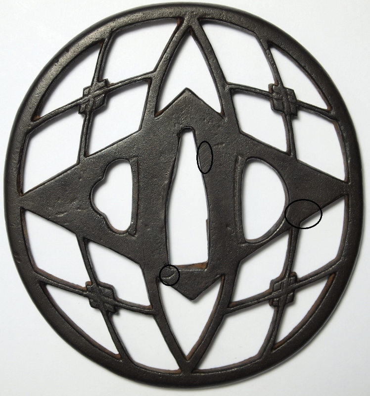

I also noticed some features in my tsuba that are not on the tsuba in the book. I upload a edited photo where the features are highlighted with black circles.

Even as a cast it makes sense to me that there would be some anomalous marks on the tsuba. After all, they needed to do some clean up work on it with files, add the punch marks around the nakago ana and cut and file the kozuka histu-ana (which as Brian says was done badly). Given that they would be trying to conceal the cast nature they would hardly take pains to avoid some mild wear and tear on the surface during these processes. Some of the marks may even have been left intentionally.
So as far as discerning if this is a cast of the one in the Ito book these marks are non-issues. I agree with Brian's analysis - the number of details that do match up exactly is pretty telling.
