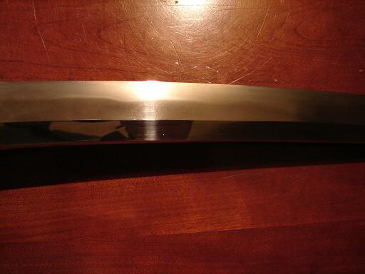

Signed Ujifusa Kai Gunto for viewing.
It was owned by a retired Marine Major that was in the pacific theatre, they said it has been wrapped up in old newspaper, and laying an old military footlocker wood chest since he brought it home, sat there, and was forgotten, I would say that is why the condition on it is so perfect.
The blade really is beautiful, I thought it was a complete polish, but no, all original.
I just wished it had the more traditional style wrapped Ito on it, besides that, it is perfect in every way.
I know I said no more buying until I do some good reading, but when I saw it, I could not pass it up, would you, once you saw the blade.

The "chippy" style mei almost always indicates Showato, but the hamon doesn't look as uniform as many Showato I have seen. Perhaps a higher grade of Showato or hopefully a Gendaito. Militaria collectors do pay a premium for good condition swords like this though. Enjoy.

The guy I bought it from, said it does have Hada on the blade, so hopefully it might be Gendaito, do you know if this swordsmith has made traditionally made blade, or not.
I paid 2350.00 for it, I think it was a steal, with the perfect blade and all, and it is signed, and the Ito is perfect on it, I cannot see any flaws on it, could you from the pics ?

Man, it's very nearly like you refuse to listen. This is another example of poorly made wartime showato. I've been trying my best to try to show you high quality blade but you defer to subpar pieces. Well, more power to you sir. Good luck.

Brian does this sword have an arsenal stamp on the tang? If so, it's probably 99.9% it's a showato. Even without the stamp, it's still probably a showato. Can you see the Hada yourself?
This sword is probably worth the money. The only thing is, if it's a showato, it is only really militaria. Another way to tell if it's a showato, is to check the Habuchi with a Jewelers glass. Water quenched blades have individual crystals, compared to oil tempered blades which appear homogenous.
No need to ask about the stamp on the nakago. This is clearly showato. I don't follow the logic of what you are trying to do and the comment on not buying a traditional blade until you learn is great but you still bring us these showato blades to look at and render our opinion over and over again. What are you looking for? Would you like us to tell you this is a phenomenal blade? It's not. It's a run of the mill showato piece that is valuable from the standpoint of militeria and that's it. If you are only interested in militaria, there may be other areas that would give you high praise for what you are building for a collection where as this board will just be very skeptical about your direction as you clearly don't care or are interested in traditionally made swords. I'll keep my mouth shut moving forward as my advise is just a waste of time and I'll not waste my time.

Brian, your newly acquired blade looks great to me but is it Showato, machine made, oil quenched versus true gendaito ??? How can you tell ?
"The "chippy" style mei almost always indicates Showato, but the hamon doesn't look as uniform as many Showato I have seen. Perhaps a higher grade of Showato or hopefully a Gendaito."
"does this sword have an arsenal stamp on the tang? If so, it's probably 99.9% it's a showato. Even without the stamp, it's still probably a showato. Can you see the Hada yourself?"
"Another way to tell if it's a showato, is to check the Habuchi with a Jewelers glass. Water quenched blades have individual crystals, compared to oil tempered blades which appear homogenous."

Brian, this is an extraordinarily well preserved showato, and as such is very very rare. People won't give these blades a proper polish since it just doesn't pay, so finding one in a mint polish puts it in rare company. It is worth the money that you paid I would say, but it is also true that most NMB members are not interested in collecting showato, as they have no association with the samurai, they are not hand forged and don't have the hamon and hada that collectors enjoy.
Having said all of this, I think the machine made blades have appreciated in price the most over the last decade or two for some reason. In the 80s, hand made katanas worthy of restoration could be had for $2 or $3K, and NCO swords were $100 bucks - as many as you could carry. You can still get katanas for that much, but the NCO swords have gone up to $600 and up - a six fold rise. I'm sure that you will make the transition to true samurai swords one day, and when you do you will be able to get your money out of this sword. Happy collecting.
