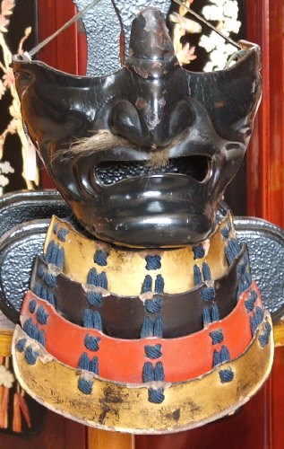

Here is one, now in Germany, that was the first Hide mask I had.

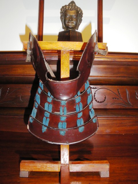

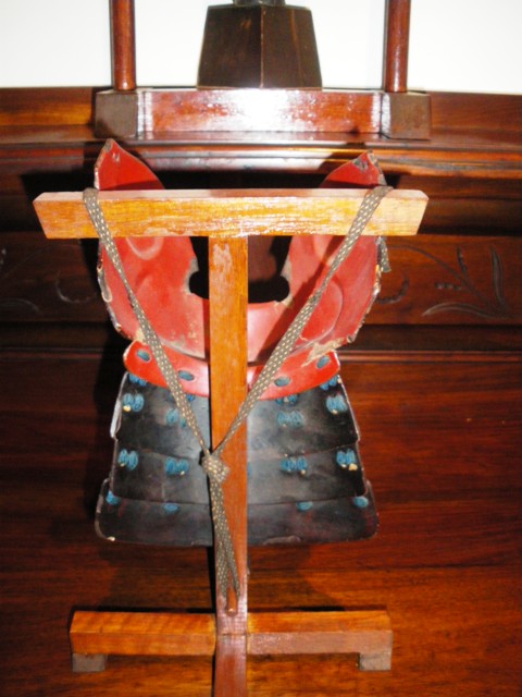

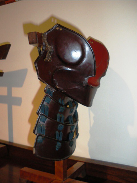

Jan and Roy, I promised to post images of the leather menpo belonging to the armour made of nerigawa. As I mentioned the whole thing needs quite a lot of TLC and I have starting with the menpo. The major problem is the lacing which looks too narrow for the spacing of the holes in the plates and is broken in places. In general it looks rather 'mean' as if it has been re-laced with some braid that was on hand but not quite right for the job. I have used 8mm stuff for the menpo and thinks it looks about right.

Nice looking "fix up" with the menpo, Ian.
With Your closeup I can def see some similarities in the matr with my menpo. And also the general look of it. As I said before this nerigawa has really opened up a new avenue of knowledge regarding armour of the samurai. I have acctually replaced my iron menpo on the fully dressed Takigawa-samurai with this nerigawa one. He deservs nothing but the best :D

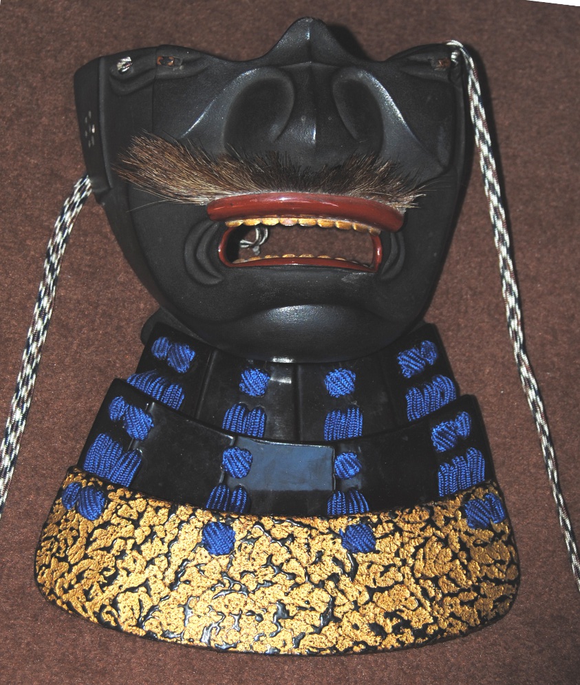

I think leather armours are being completely overlooked by collectors. As Ian said they were expensive back in the day.
Weight wise, well I have three Nerigawa Gusoku, one Kuroda Clan (Photo attached) is heavy, it's the heaviest armour I've ever handled and its 98% leather including the kabuto. The other is a Yukinoshita-Do, all leather, but about he same weight as my iron one. I did however replace the odoshi on a dou about 3wks ago, that was super light.
So my 2 cents is buy a good one with hardly any damaged if you can, and store it correctly. The main issue with leather is the de-lamination of the lacquered layers from the sub structure. Once an armour has got wet and the sabi urushi is damaged it's going to fall apart.
