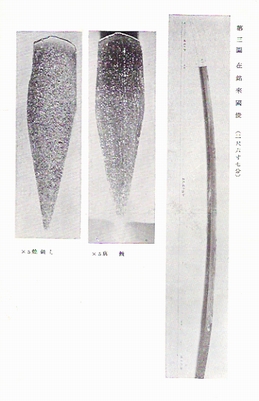

I refer you to the Nihonto Koza, "Nihon-to no Oku" (Secrets of the Japanese Sword) volume, written by Sato Tomitarou, published in Showa 9:
「日本刀講座、日本刀の秘奥、佐藤富太郎」
On page 122 he states that maru-gitae (one piece construction) was used by Ko-Bizen Ichimonji at the beginning, by Awataguchi, and by Rai school. He also related information from Taikei Naotane concerning the use of maru-gitae by shinto and shinshinto smiths (was reported to be used by quite a few smiths). He states that, using san mai gitae, it could take a smith 7 or 8 days to make a blade, but as many as 20 days to a month to make one with great care. Then, he mentions that in the old days (without machines or a lot of help), it could take as long as 2 or 3 months. Using maru-gitae allowed smiths to greatly increase their production. Records indicate that Tsuda Sukehiro, for example, made 1670 swords in his working lifetime of 23 years, which averages out to a steady 6 swords per month, every month, for 23 years. The inference being it would be impossible to make that many swords unless they were made by maru-gitae.
He included a sectioned micrograph from a blade by Rai Kunitoshi that shows it is made of one piece....I have reproduced this below...
If you have any references to indicate otherwise, I would be interested in seeing them....
This book is a treasure trove of info on the making of swords. The first section contains experiments conducted with Horii Toshihide and has many interesting pictures of Horii and their experiments....
