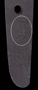

Hi all,
I have a sword that had a little active rust inside the signature deepening from the day I bought it.
It´s not very well visible in the pictures - you can see it mainly in the YOSHI Kanji.
I never paid much attention to it so far but is there any possible way to remove it?
I could try with antler or ivory splinter of course but some area are not very accessible. They need to be very very spiky and that makes them hard to handle :?
Or would it be best to leave it as it is?
Thanks for any helpful advice,
Martin
All I've ever heard is that you don't mess with the nakago, let alone the mei. If you fear the rust will grow and cause damage you might apply a tiny bit of clove (sword) oil to the affected spots, but that's as far as I'd go (if even there).
Grey
I often see choji oil refered to as clove oil...I as I understand it, choji oil is predominantly a very light mineral oil with a couple of percent clove oil, primarily to scent the mineral oil.
Clove oil from the local pharmacy, I feel, is not good for swords.
Clove oil may also damage any Koshirae that has been finished with contemporary lacquers. I say...BEWARE THE CLOVE OIL!
