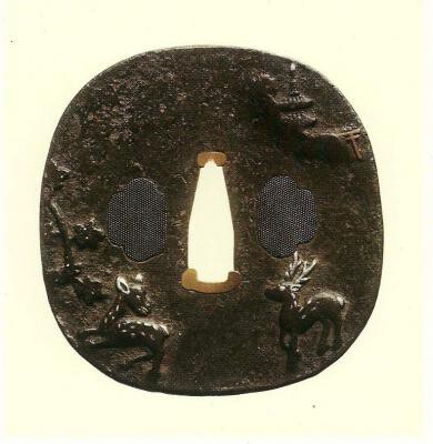

The following tsuba is a very famous iron tsuba by the 大初代金家 or in other words Kaneie I. It depicts deers in the ground of Kasugano Temple in Nara. I think a lot of scholars would probably hail this as the the best Kaneie tsuba and therefore arguable one of the best iron tsuba there is.
I personally think it is OK for either Kaneie as to me the deer look kind of Disney. Don't get me wrong. In my opinion it is good, in fact it is very very good and I love it and I am not saying anything other than I feel that there are other better Kaneie around, and think from what I have seen, Kaneie II is better and a lot more satisfying. I think the landscapes that Kaneie does is much superior to the figures.
So, what makes the Kasugano tsuba above so good? Why do scholars such as Haynes talk so highly of it? I have been puzzling over this for a while and would like any one's CONSTRUCTIVE comments that might guide me in fully appreciating this wonderful tsuba.

Dear Henry :) ,
perhaps it is "that" due the reason this very Tsuba was/is accessible to several of the older collectors who had the possibility so to study it in own hands?
I really do not know here-just an guess...
I fully do agree it is quite one of the best known examples in western hemisphere-due this,even known western authors(who eventually saw and studied it personally equally)could referee and focus especially on this one?(just an guess here)
Equally you do have to focus that most literature accessible,known and read-is comming/written by westerners-so equally here-much "knowledge" and ideas-are those by westeners...
The Japanese literature is due the fact it is written in an somehow unaccessible way(for most of us)rather difficult to understand and to obtain-this does answer equally...
In comparence to others in fact-me i especially love the three "Monkey reaching moon" Tsuba much more-i equally do wonder here an bit-as this "deer thematics" does seem to myself(as you did write here) an bit Disney,too...but well...individual tastes are for luck different...
I but think the answer(at least an possible answer)on your´s question-is an kind of way of study-and of course accessibility?
Don´t know-how do you others think?

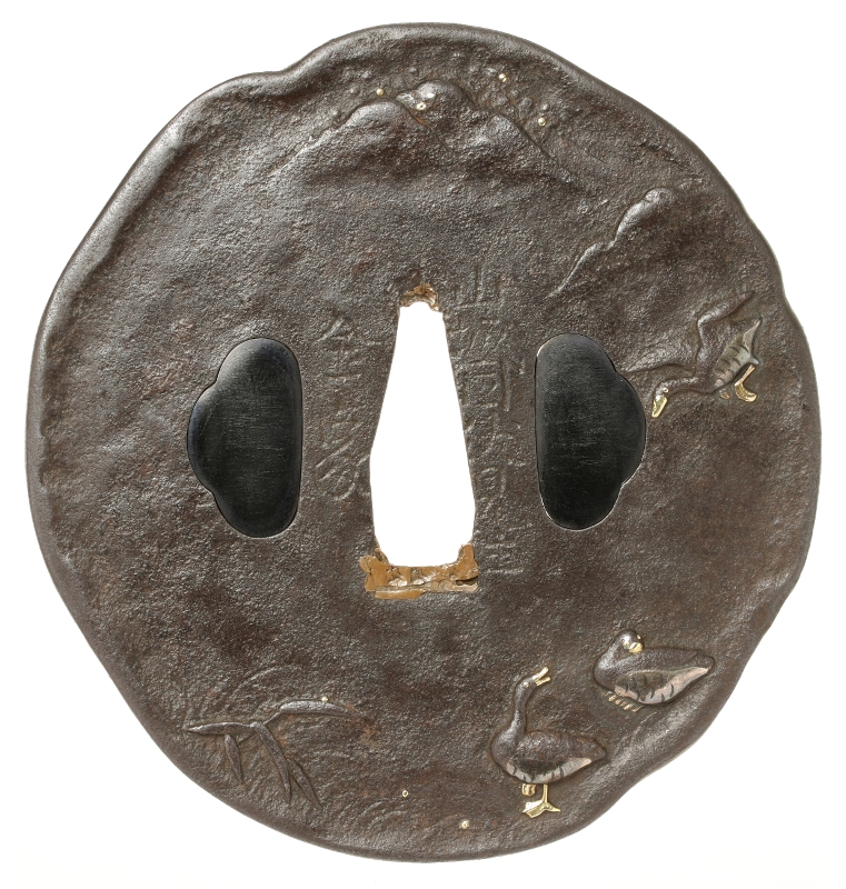

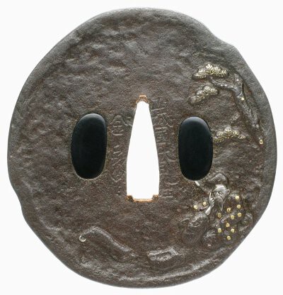

Well, as concerns this particular Kaneie tsuba, I think it is a lot of things, really, that contribute to its being such a widely recognized masterpiece. I had the opportunity to see this guard in person at the Hosokawa exhibit in San Francisco a couple of years ago, which, needless to say, was a real treat. And frankly, it was only there, being able to see it “live” from many angles, that I was able to fully appreciate its greatness.
As Brian notes, one starts with the metal, which appears very finely forged. To me, if we’re talking about iron tsuba, the plate is the plate is the plate. That is, if the plate is mediocre, the tsuba is mediocre, regardless of the rest of its features. The forging and working of the plate on this tsuba is masterful, from the fine hammer work to its relative (and pleasing) thinness. This brings me to the shape of the guard. In my sense of things, one could remove all of the “decorative” features of this tsuba---take away the deer and the maple and the background scenery---and it would still be a fantastic piece. Why? Well, besides the plate quality, the shape of the tsuba---and here I mean not only its basic gata, but also its three-dimensional sculpting---together with what I think are magnificently realized hitsu-ana, result in a wonderfully well-balanced composition. The tsuba has that fantastic Momoyama breadth that we don’t see much at all in other periods. Even the hitsu-ana shaping accentuates and visually extends the width of the guard, to superb effect. I really wonder why more tsuba artists didn’t create pieces that were as wide as or ever wider than they were long/tall...
So among the metal quality, the working of the plate, the guard’s shape (three-dimensionally), and the particular hitsu-ana used, it is already a masterpiece in my eyes. The weakest part of the tsuba, to me, is the decoration. Not that it’s weak; it just isn’t as brilliantly realized as the rest (again, IMHO only). Having said this, however, I think what makes the relatively crudely-executed deer work in this piece is that they provide a delightful counterplay not only to the more solemn associations we would have with shrines and temples, but also to the serious “visual weight” the tsuba’s plate and shape confer on the piece. That is, against a backdrop of solemnity, two deer appear in the foreground, carefree, perhaps, but in any case rather “lightly” rendered, charmingly sculpted and placed by the artist, looking almost more like toy representations of deer than as naturally- and realistically-depicted animals. This, to be sure, is as Kaneie intended. I would suggest his rendering of the maple branch reinforces this effect, as it, too, is relatively “crudely” depicted. With such “crudeness,” though, comes strength, a strength gained from expressing the subject in something of a more essential form than if it were represented in a more delicately realistic manifestation. The deer could certainly be taken as Disney-esque (I can see this, yes... ;o), but I believe it is their “lightness” counterposed against the deep solemnity of the rest of the guard that makes the way they’re done on this tsuba work so well.
One last point: the Momoyama Period is seen by many as being the apex of Japanese artistic mastery (I certainly would say this). Many of the art forms of this time managed to express/capture poignant aesthetic sensibilities, among these sabi, shibusa, wabi, yugen, and, perhaps most relevant to our discussion here, mono-no-aware---the “pathos of things.” This Kaneie tsuba masterfully evokes this feeling, I think. It works synergistically, holistically, to express this pathos. This isn’t to say other Kaneie don’t achieve this, too (many do, I would say). But few if any others express the degree of light playfulness that this guard does. Even the wonderful “monkey-moon” tsuba are too immediately associated with the proverbial lesson to be learned from the subject depicted to result in a prevailing mood of lightness or playfulness.
This, at any rate, is why I think this tsuba is so iconic in its status as one of the very best tsuba extant.

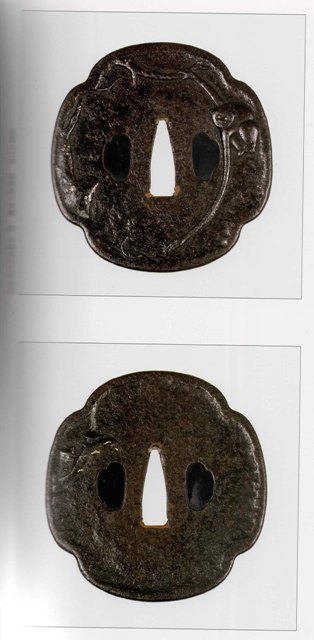

Dear Henry :D
those are great examples!
(however-here already you do see the differences in the iron...here on those pics not good to realise-but to be seen when you compare them in the Kaneie-books where the picture-quality is given much better)

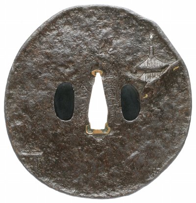

I but have an question here-
i made mine mind since longer time about this...
They all are "Plugged"-at least most we can see in literature or here on those pictures...
What may be the reson?
Weren´t they never mounted?
The Tsubashi himself did obviously intend so they should get mounted-but it seems-even if this was fact-those were not mounted for long...
It seems,that already in past-there was an very keen interest,so to collect them and fitt them with Hitsu-Ana-plugs?
In comparence to Nobuiye or YKB/Hoan-such Guards from hands of (the) Kaneie seem to be looked already,as the "Hailrooms" in those times...
So as Steven wrote in his very excellent reference here-even in latter times of Edo(as i would tend to say that those plugs nearly all date latter)those "apex in artistic mastery of Momoyama period" were still in the very highest esteem of those who did care about the artistic heritage(including the artists themself) of later times.
Why then-in conclusion-this special "artistic expression" did change?-and we do find the tendence of applying more and more thickness of the plate,declination of iron quality,soft-metal,carving...heading into that typical and classical Kinko...?
So this may be an answer what does make Kaneie Tsuba just Masterpieces.

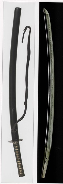

If you are like me and have ever wondered how a Kaneie tsuba would have been mounted, the following scans will be of interest.
The sword (a Mitsutada) and koshirae are on display at the Nezu Museum as part of the "MEIBUTSU Treasured Japanese Swords" exhibition. The display concentrates mostly on swords but the Kaneie included was a real treat.
Sorry about the lack of quality of the scans but I think you can get the idea from them.

You raise an interesting point above about the hitsua ana plugs. I do not know why they are plugged. My guess is that when the tsuba were mounted kogai / kozuka were not required probably because they would get in the way of such lovely tsuba. Just a guess.

Awesome pics! We are often told dimensions, but that profile pic really shows how thin and elegant the plate is more than anything I have read.
Quite remarkable.
On the plugs...I am not convinced it is purely because they weren't used. The fact that you weren't using a hole doesn't mean it had to be plugged. It was perfectly useable with the open ana in place. I wonder if there wasn't some other reason for this?
Brian
