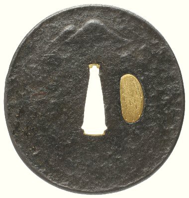

Hello,
I am thinking of buying this Tsuba and I really want to know if it will be appropriate to fit it to a sword I own. I want it to match the age and region (if possible) of the sword.
So, does anyone of you know anything about this? It looks pretty old when looking at design and oxidation. Also, it has an unusual shape which might help with identification of the actual school. It is not the run of the mill EDO style. My guess is 1350-1450's
Anything helps.
/Martin
Dear Martin,
this Tsuba is of course not as old as you eventually do expect.
It rather dates around mid,late Edo.
The Oxidation you do mention and personally estimate it´s age,does result from it´s conservation stage and used iron-not from age.
I would attribute it somehow in that direction of the Saga Kaneie´s smiths in it´s general stylism of "chinese wise picture and landscape"
Perhaps one of the Kinko-collectors here can identify it to the specific school and artist so to help you.
But for shure it does not date Nambokucho/Muromachi :)
Christian

Martin,
Probably as Christian said: signed Saga Kaneiye
If there be mountains (probably 3) in the background and they have pointed tops, it pretty much further supports Saga Kaneiye work before you even check the mei.
Would agree with Christian the tsuba is likely the work of the Saga Kaneie school. From looking at the low resolution photos I can make out a few parts of the mei. The Saga Kaneie school of the middle to late Edo Period (i.e 1700s and 1800s) always signed in the same manner as the second Kaneie master of the early Edo Period. A frequent subject was Chinese style landscapes with people. I hope you find the information helpful. I like the tsuba just wish you would post higher resolution photos. :)
Yours truly,
David Stiles

I did some research and thanks to you great input in the matter it I have come far.
The MEI is not very clear, but with good reference and knowledge it should be solved. The MEI might continue into one or two more Kanji, I am not sure, it makes sense if it does since it ends with "住" which should follow with a name.
金家 山城國伏見住? ?
Many thanks!
http://dl.dropbox.com/u/37236755/TSUBA3.jpg
EDIT - The MEI of the tsuba is: 山城國伏見住 金家
I wasn't really sure about the way it was signed. Done some more research now. It looks real and perhaps it goes back to early Kaneie (Shodai) pre Saga Kaneie. If that is the right way to say it.
/Martin
After reviewing your research and looking in my library I would like to say congratulations as I think with out a doubt that you have found a Shodai Kanaei. I would estimate that it is worth probably about 3,000,000 yen at least and that it would probably go for more if you so wished. :evil:

Martin, I think I am safe in saying that this is Saga Kaneie. NOT shodai and not any national treasure. Sorry, but still a pleasant tsuba.
You realize that if it was a Shodai, it would be like finding an unknown Da Vinci painting?

I would still say it is NIDAI (99% sure). Do you have anything to back up your theory? Any digital items in the library that can be shared or internet info?

Also sorry Martin too as if were a Shodai I think that 5,000,000 yen would be more realisitic. 8) It is not a Nidai either or by anyway made by any of the Kaneie masters of the Muromachi / Momoyama period.
If you want to see work by the real Kaneie, have a look for the following books:
24255 Kaneie Tsuba S. Ikeda
14944 Kaneie Tsuba Kanbetsu Hikke M. Matsuzawa
24256 Kaneie no Kami-waza K. Yoneno
33045 Kaneie no Kenkyu T. Uemori

Maybe I have missed it, but not once have I seen mention of the dimensions of this tsuba ? These are important markers for identifying many tsuba and should always be added when asking for help. Height and width, as well and mimi and centre thickness. Anyway, for those of us who keenly observe Kaneie tsuba, we know that genuine Kaneie guards are thin, very thin. The mimi may reach 3 - 4 mm and are usually a little undulating, but at the seppa dai, the iron is mostly hovers about 2mm, give or take. And they do go under. Tsuba of 3mm thickness and up are not genuine Kaneie. We know that there were only 2 generations who are well documented.
Besides Saga Kaneie, there are also many gimei pieces that are or should I say were made by Aizu Shoami artists and the likes. That is not to say they signed these pieces Kaneie, anyone could have done that at any time, it's just that the work looks for all the world like it was made by a Shoami artist. One tell tale sign for a false signature is the top (roof if you like) section of the Kan kanji of Kaneie. On genuine mei it is rounded and flows smoothly in a continuous arc. Many of the fakes have this stroke cut in 2 parts, and have a sharp bend or corner at the apex. This appears to be the case with this tsuba.
Martin, who confirmed this tsuba you posted ? I have never seen this type of surface treatment on any Kaneie tsuba before. I would hesitate a guess it is a much later addition, based on the tiny pic it is hard to tell anything of course.
Just a note on prices, 5 million yen would get you a small Kaneie. A proper sized large kaneie, I shudder to think but I know of one in Japan that was bought for over 25 mill yen some years back. It is housed in a Maki presentation box and was a gift from the 2nd Tokugawa to a person I forget for the moment. If you own the books that Henry has mentioned, this first thing apparent is that there are not many Kaneie tsuba regards as genuine by either of the only two Kaneie artists in existence. It is one of the reasons they are so revered, they are just so rare, and precious.
Yet they keep turning up on Ebay and on these forums.
Amazing lol.
Cheers
Rich
The rim shape is called kobushi gata or "fist shape". Because of its originality at the time it came represent Kaneie so the shape is quite usual for Saga Kaneie school. Honestly the one that you originally posted is definitely not the Dai Shodai or Meijin Shodai. From the pictures, it is definitely Tetsunin AKA Saga.
If you are really interested, Kaneie is great to study so I recommend buying some books on him as well as "Tsuba. An Aesthetic study" which gives a good summary on him / them.
Owning a peice by the first two Kaneie is most probably out of the question as they are near impossible to buy. However I think that these days with the economy the way that it is they are becoming available. There was a wakizashi size one last year for about 5,000,000 yen in Tokyo last year which was the first I ever saw on a dealer's table.

hi Martin, how are you ? yes. I'd be more than confident in saying not one of those is a genuine Kaneie tsuba. The one Boris listed is the best and closest of the lot though the iron lacks true Kaneie characteristics. and seriously mate, do you think that if any of these dealers had a genuine Kaneie they'd list them for $750 roflmao........
At best, they are mostly Saga work. There maybe some late Aizu Shouami in there as well. That first one with the NTK paper does not even look like Kaneie work. Maybe Testunin at a stretch. it's a dog lol.
None of these are genuine, yet they have
the mei of the first or second Kaneie masters. Ergo - GIMEI.

In my opinion the Saga did good "imitations" of Kaneie but compared to the real thing there is no comparison in the following:
metal quality, hammer work, inlay, carving, overall composition....
I really like the 鐔鑑賞記 by Zenzai blog. The examples provided are just wonderful for study. It really does not matter that much that the blog is in Japanese. Being a person who likes the Saga Kaneie school and collections pieces from that school looking at the 鐔鑑賞記 blog with the real Kaneie there really isn't any comparison. This is clear looking at the quality photos I can imagine having a really Kaneie tsuba in hand for comparison.
