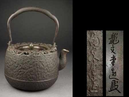

Casting in Japan in the pre-modern period was very much an art. Many beautiful tea kettles, some national treasures, survive today....I wouldn't call their surfaces devoid of detail or lifeless....Their wabi-sabi has long been appreciated by tea people and other aesthetes for hundreds of years....I find the stone like ground very beautiful in a well done work....While I am not saying tsuba were cast in the Edo period, I have little doubt that if one was done by a craftsman skilled in the art it would be quite nice to look at.....
The problem with bringing cast iron kettles into the discussion is that kettles were (virtually) always cast; there is no vastly superior forged metal to compare (what would have to be) the inferior cast version to. Kettles, in other words, are "supposed" to be cast. The art form that is the kettle is not degraded by its having been cast. Additionally, the far greater expanse of material inherent in a kettle (when compared to a tsuba) allows for some subtleties to be explored and expressed. This is not the case for tsuba, needless to say. Whatever artistry we might find in kettles despite their having been cast, we do not find in tsuba. Finally, it must be said that however excellent the effects realized in the casting of kettles, these will never compete with those achieved in superbly-forged iron tsuba. They are clumsy by comparison. This is not to disparage kettles---they are indeed beautiful objects, and the expressive quality they are able to achieve via the casting method is remarkable and worthy of appreciation. This cannot be said for cast iron tsuba. I seriously doubt this last statement even needs to be qualified.

No... not devoid of detail nor of art, neither is their making devoid of great skill. The material however is dead or rather it lacks in my estimation, a certain vitality. Only my humble opinion of course. :D Its a little strange to compare cooking utensils with tosogu, rather like comparing a woodsman's axe with a fine tachi blade, but I take your point. Casting certainly has its place (cooking utensils and statuary spring to mind), and there is definately an art in casting.

I would suggest that to the connoisseur the cast iron kettle is rich with qualities that are completely comparable and on a par with those that are valued in worked steel. Had Japanese tsuba artists felt that cast iron was suitable and legitimate material for tsuba they would have used it. But we can be pretty certain they would have developed a completely new range of aesthetic qualities (contrasting those of worked steel for example) in this new medium.

Probably best going forward if you and I PM one another on this, Chris, lest things get too toxic...
"There was little aesthetic consideration when originally made, that came later. Much like common, every day rice bowls from Korea came to be worshiped as art in Japan later on.... What started as practical, utilitarian became appreciated as something else...."
Can't prove a negative... We don't know for sure that there was little aesthetic consideration when any of these objects was originally made.
We know these wares were used in every day life in Korea by the archeological record. We also know they were treasured in Japan by the fact that some are now recognized as National Treasures.
Given the fact that tsuba could have been cast but weren't, we are left to postulate why. Given the extra time, labor, and materials involved with casting, as well as the technical difficulties and the existence of a suitable substitute, I think the reasons are rather obvious and point in a different direction than simple aesthetics....
I am happy to be so enlightened by your explanation. However, since I am now enlightened, it shows that it isn't strictly necessary to have worked with these craftsmen: I have learned from a text.
I am glad I have been helpful and increased your knowledge of traditional iron casting in some small way. If this one small fact has enlightened you, I suppose it would be easy then to imagine how much more you might learn from actual experience...
Not much more to add to a discussion that has beached itself in the quicksands of "can't prove a negative" and "Experience?? I can read" territory.....but that is ok, we are all entitled to our opinions....
All -
I have always heard that Namban Tsuba were cast and having seen a few have always believed this. While some are copper there are many that are iron. In "The Namban Group of Japanese Sword Guards" by Dr John Lissenden he talks about his survey of museums and his own collection and concludes that most are in fact cast. If we accept his conclusions, most Namban tsuba were cast, most were produced between the 18th and 19th centuries and were indeed worn by members of all classes of Japanese society.
I did not find the smoking gun however, a tsuba which was agreed by all to be cast and which was signed and dated and collected prior to the 19th century. It seems that such a tsuba must be out there, or we are faced with the conclusion that all or nearly all Namban tsuba were cast strictly for the export market and all those castings are in Europe or America. Dr Lissenden, FWIW, does seem to appreciate this class of tsuba on its own merits and provides some fine examples to illustrate.
My references for kodogu are limited and I didn't find much else on cast tsuba in English or Japanese. An online search for Imono as suggested by Piers truns up a few examples of tsuba for sale, and some blogs concerned with similar questions we are wrestling with here. Still did not find any good articles on the subject, nor did I find that signed and dated work, that last word...
-t
