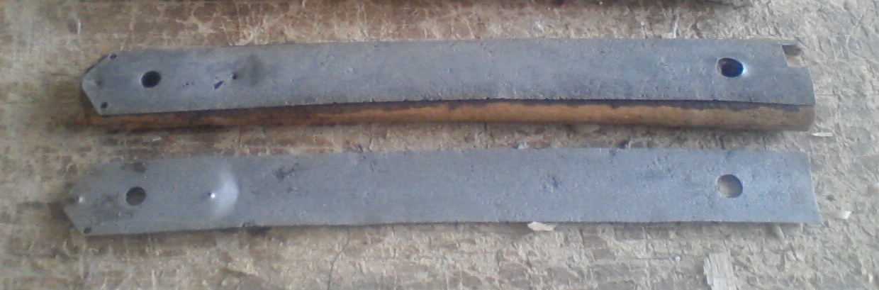

 I came across this old post while looking something up, and here's my "two pennyworth". A wrecked and stripped gunto tsuka, with the two iron/steel reinforcements mentioned above....

#12 obiwanknabbe
obiwanknabbe
    Jo Jo Saku
  • Members
  • 381 posts
  • LocationFort Worth, TX
Posted 05 July 2017 - 10:23 PM
My Mantetsu has metal reinforcements in the tsuka.. Discovered them when I had the handle re-wrapped.

#14 Dave R
Dave R
    Jo Jo Saku
  • Members
  • 461 posts
Posted 06 July 2017 - 02:45 PM
Makes you wonder what kind of officer needed metal reinforcements due to using his sword that much.
I know in Manchuria it was common practice for many officers to kill Chinese prisoners regularly with their swords.
More likely an officer who expected to use his sword in combat! The team that went out to China repairing swords there found that it was Saya and Tsuka that most often needed repair. Face it, having this happen in the field would mean "game over"!

#15 Dave R
Dave R
    Jo Jo Saku
  • Members
  • 461 posts
Posted 06 July 2017 - 02:53 PM
Were these under the Same or on top of it and under the Ito?
I have also seen references (might even be on this forum) to these re-enforces  turning up as retrofits to an old sword gone to war. Fragility does seem to have been a problem with them.
