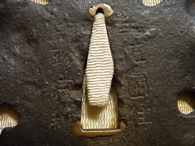

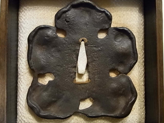

Can anyone tell me anything about this tsuba or the creator?
9 cm high x 8cm across, it looks to me like  the Kanji for Dai. The Mimi is quite a bit thicker than the seppa area. Actually it does not seem to have a seppa-dai per se. (Maybe a faint outline on the reverse?)

As Thierry described above, cast iron plate made by a tetsubin-shi - caster of iron tea kettles.
"It has an inscription: Tosa Kuni Ju Myochin Munetoshi, and was taken from his original work."
"Unfortunately the example by Munetoshi has not been recorded so far."
Apparently casting was very expensive due to the amount of charcoal needed.
It goes on to say, "Not enough attention has been paid to cast iron fittings. This is one of the best examples found so far."

I would be grateful if someone here could elaborate on this highly interesting cast iron tsuba.
Mr. Haynes is an authority one cannot ignore, and the popular opinion is that cast iron tsuba were made as Meiji tourist items.
So this tsuba brings up an opportunity for an interesting discussion - have cast iron tsuba been produced before Meiji? Have they been designed as a fully functional sword guards? Are there any other examples of such tsuba?

In the meantime I have read and reread this thread, but I am not yet 100% sure what was given to me the other day.
One person here became quite angry when I suggested it might be cast 鋳物 (imono). Perhaps he thought I was being ungrateful(?)... when I am solely interested in the story behind it.
It seems there was a mid-Edo worker in Kyoto (Yamashiro, Yoshihisa) who made cast Tsuba:
http://www.tsubanomiyako.jp/SHOP/T-056.html
PS A tsuba collector friend has just seen it. Tapping tells him what the material is. Yes, there were definitely cast iron tsuba in the Edo Period, he kept repeating. Just as there were cast Koshirae parts. Although the Sekigane suggests someone fitted it to a sword, he says it will look better as a single display item. Lack of a mold line suggests use of a single cast that was broken up to reveal the tsuba.
"Tapping tells him what the material is" :rotfl: he he...a friend of Uri Geller, no doubt ;)
"Lack of a mold line suggests use of a single cast that was broken up to reveal the tsuba."
or; any seam line left by a two part mould was subsequently filed off, an easy enough process. If the tsuba was cast from a wax model, which itself was created from a mould taken of the original, someone needs to explain how this was done using pre-modern technologies like rubber moulds and injection waxes.
btw; most casting in the jewellery trade and bronze sculpture trade today is cast into moulds that are destroyed to release the model. The model would have been created in wax, either as a handmade one off or from a rubber mould which will have seam lines visible. These seam lines are then to be seen even where the mould was one piece.
My problem is that I was presented with this Tsuba with great and solemn ceremony. My subsequent suggestion that it might be cast iron was met with derision and anger by someone I otherwise respect. He seemed to think that I was being ungrateful to the original giver, looking a gift-horse in the mouth? I quickly shut my mouth. :lipssealed:
So, what can I do with it? I can display it, or hide it, or perhaps give it to someone, but not much else. It is surely a good example of something, though! 8)
