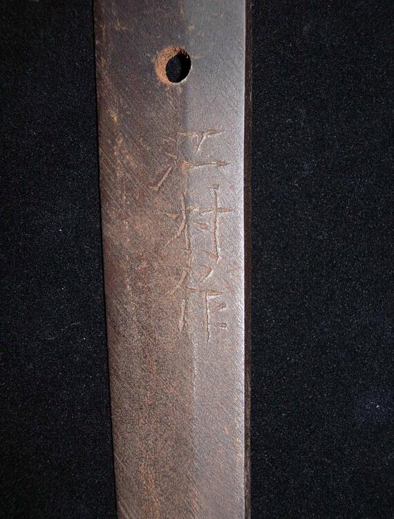

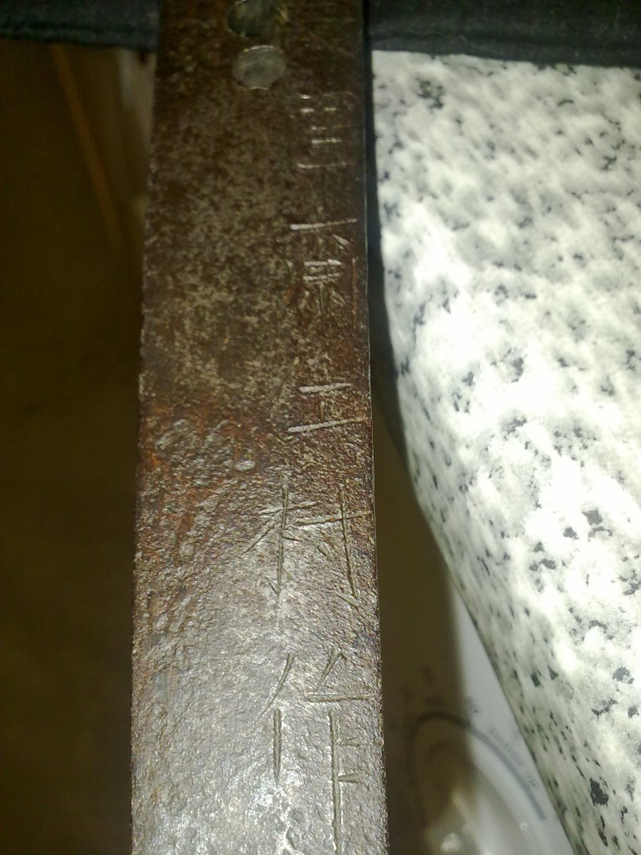

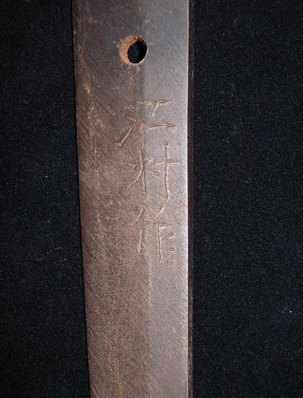

Looking especially at the kanji for saku, the "known" Chounsai Emura mei always have the long down stroke...as in the bottom pic (see links above - Japanese sword index - Chounsai Emura). The only variation I have seen is when Saku is in sosho script. I have not seen this mei before.
George.

I compared this Mei of course with severals others from Emura in advance (e.g. you can find a lot of signatures form Emura on R. Stein´s HP :) ) and Your comments confirms my doubts.

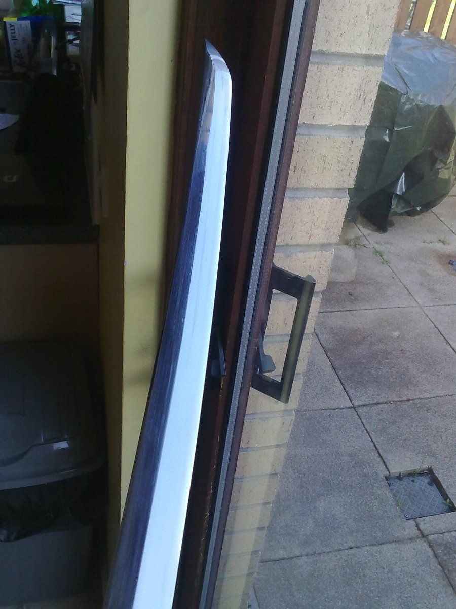

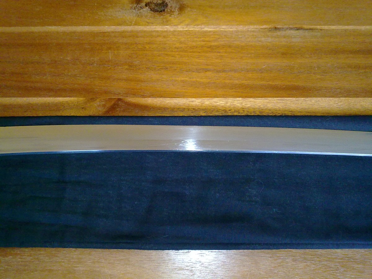

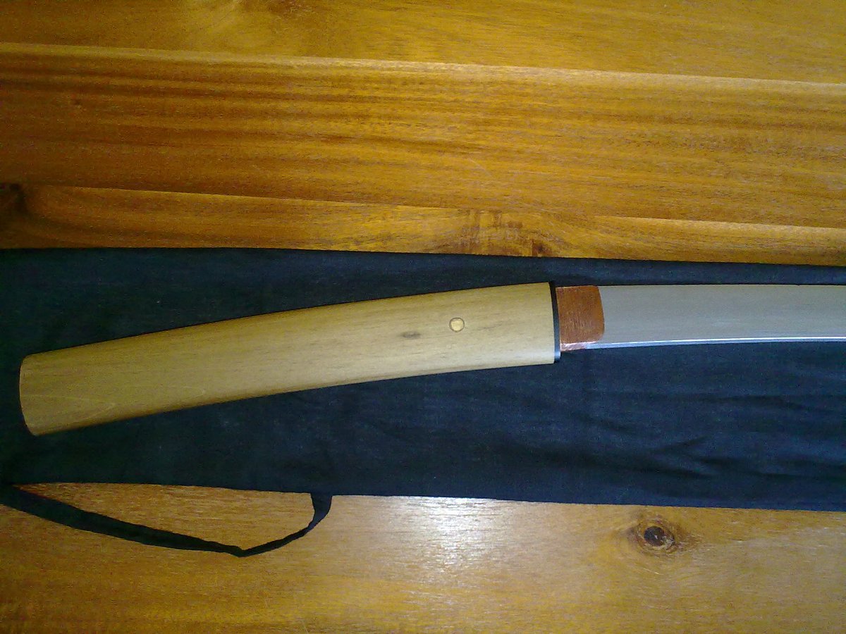

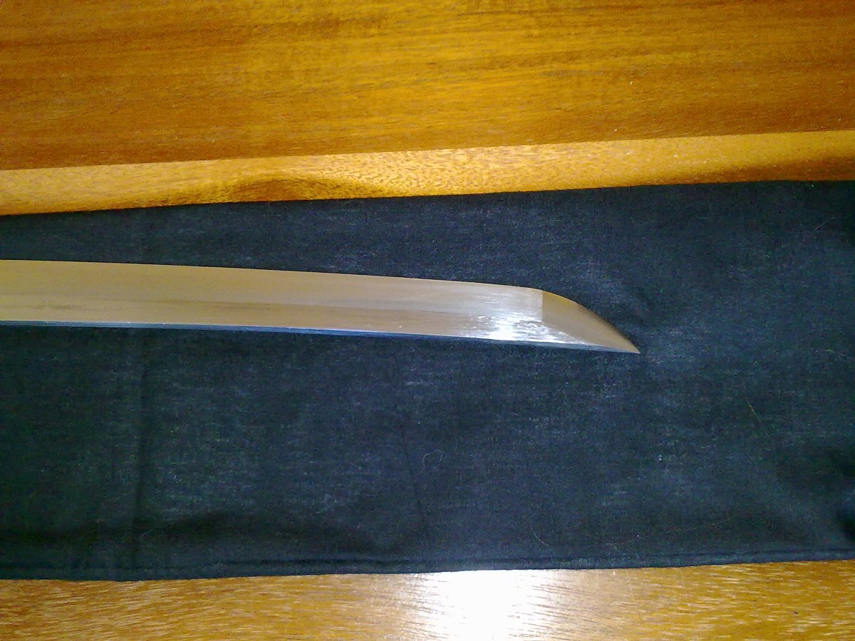

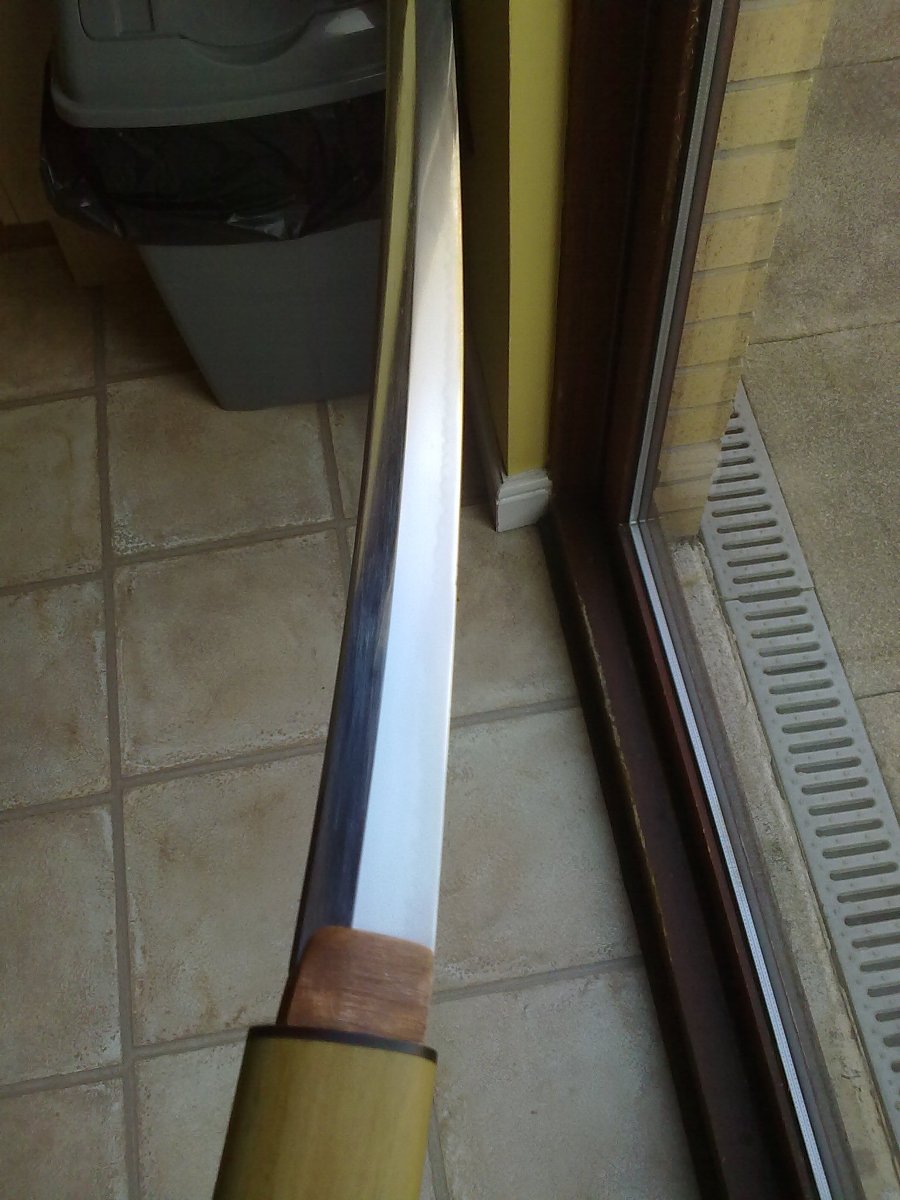

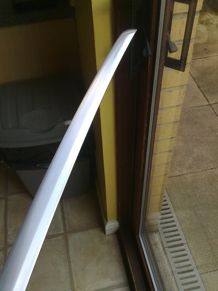

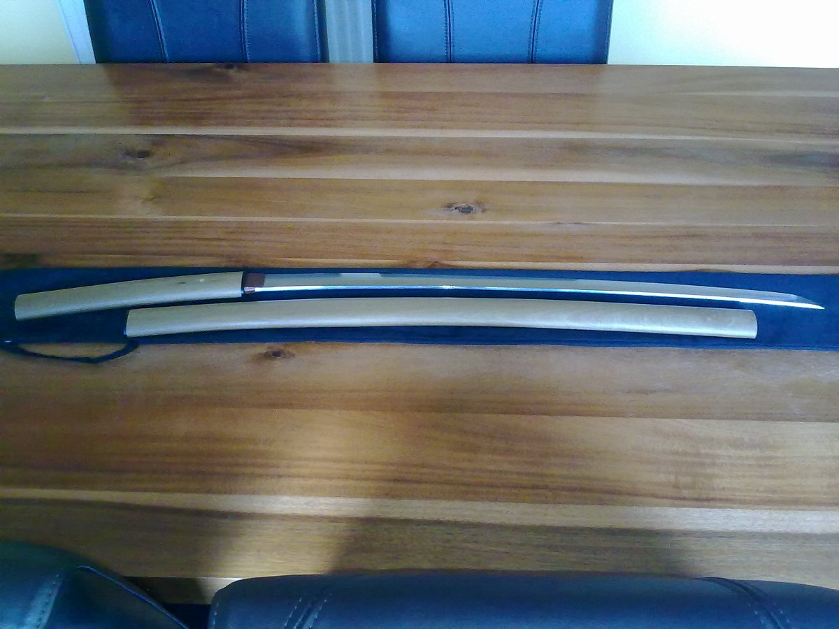

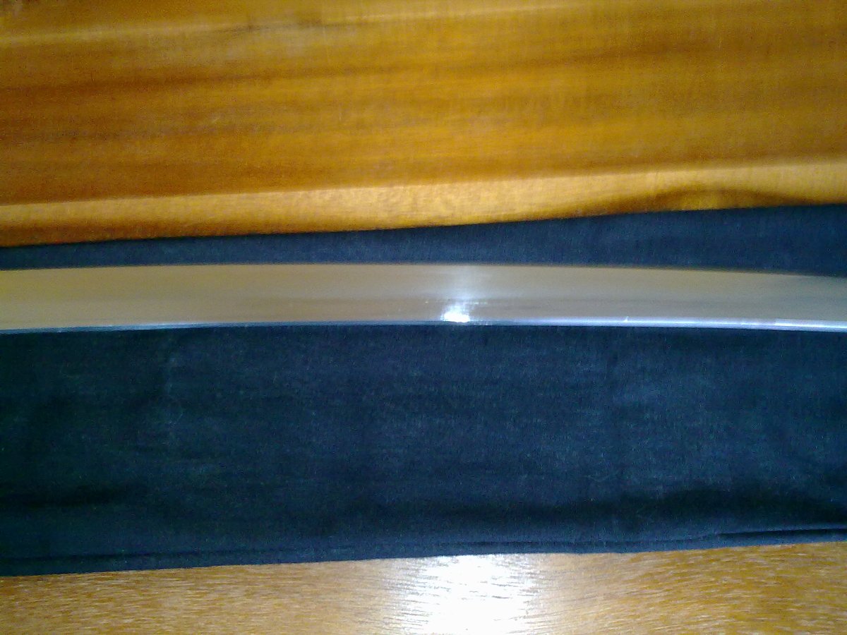

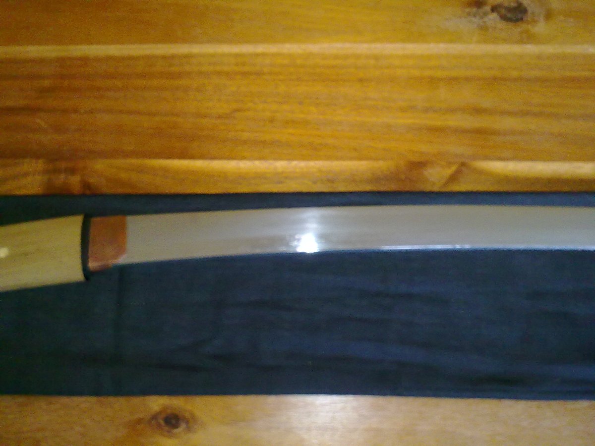

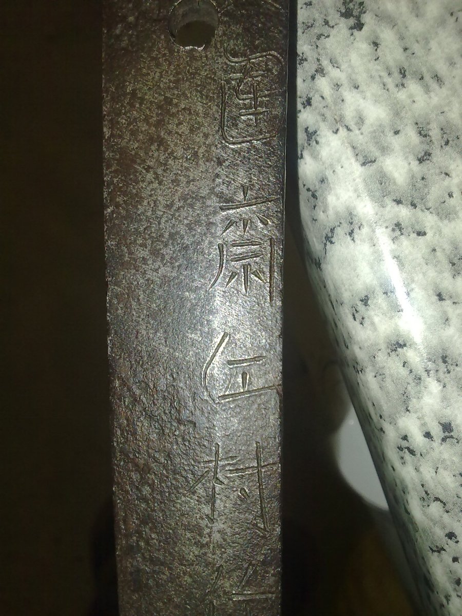

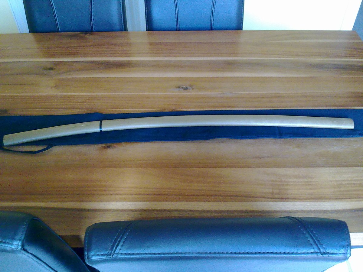

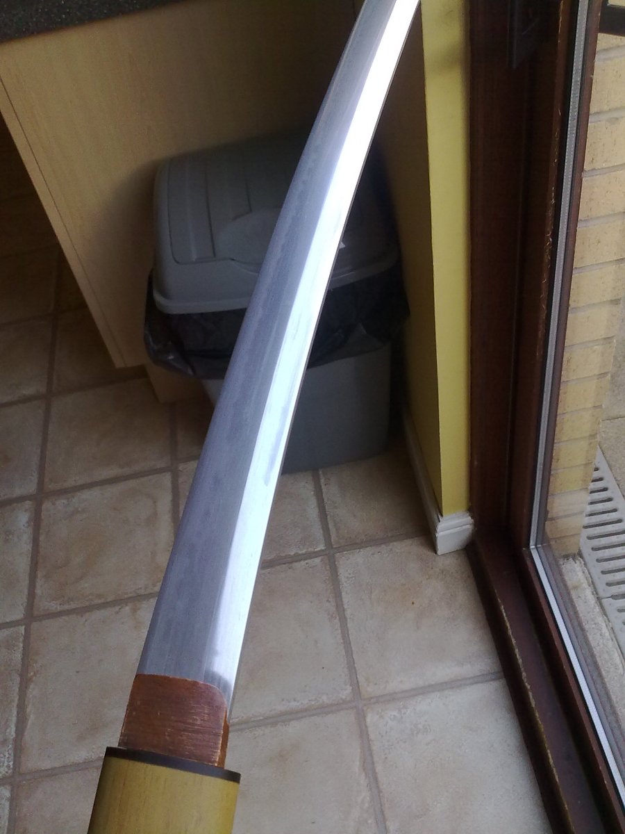

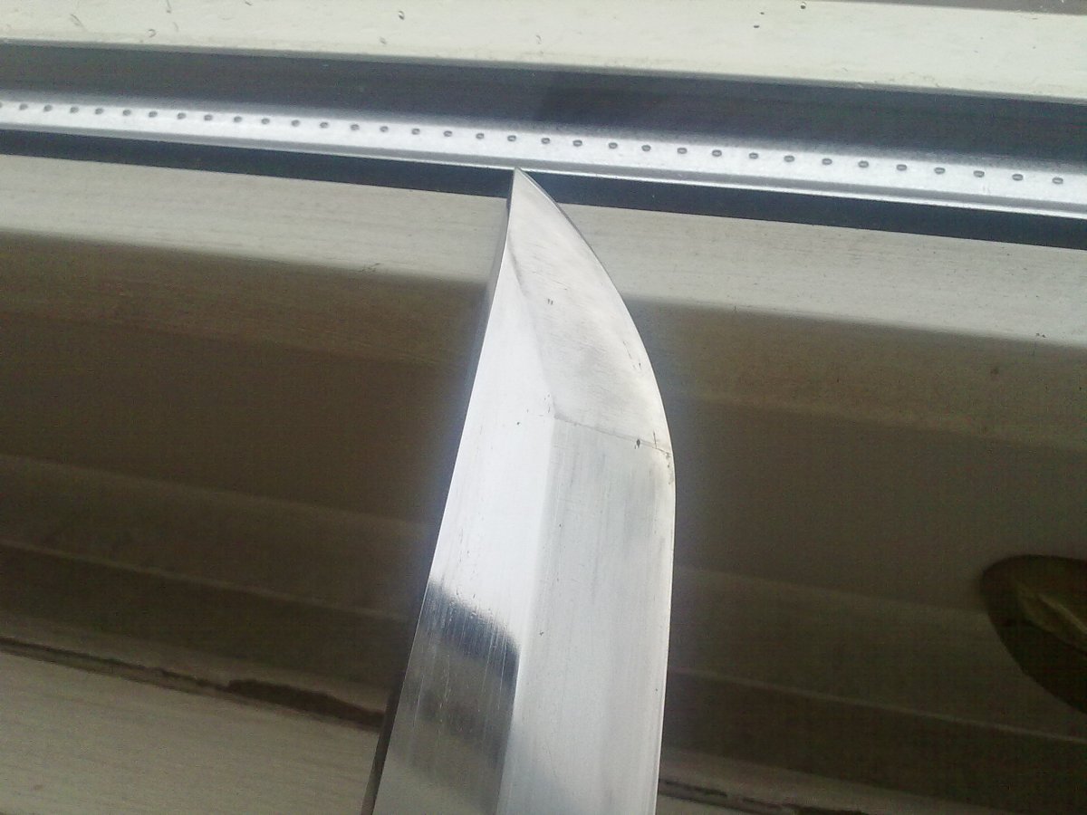

Thanks for all the informtion, especially the pictures. I've posted a few pictures of the sword below. As it's in the shirasaya, I haven't taken it apart, mostly because I don't honestly know if I could put it back to gether again!

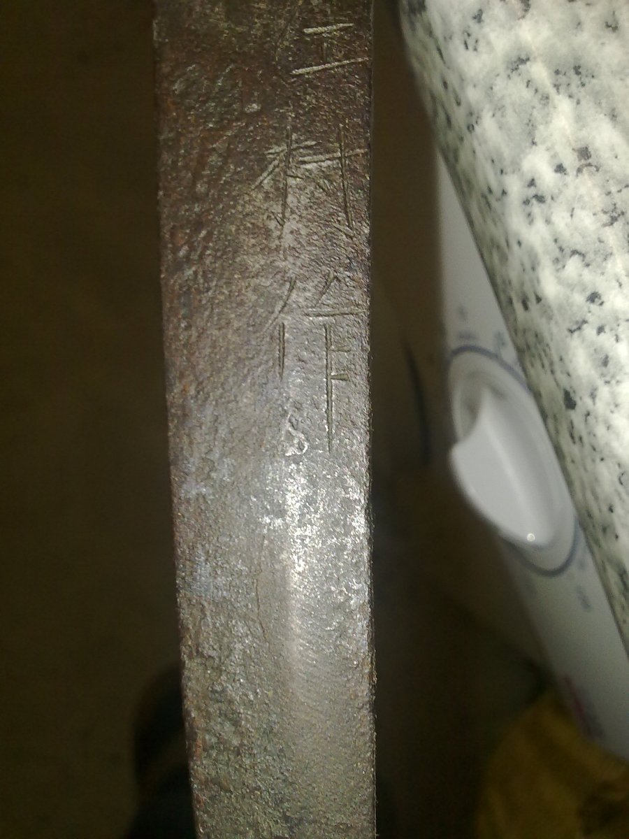

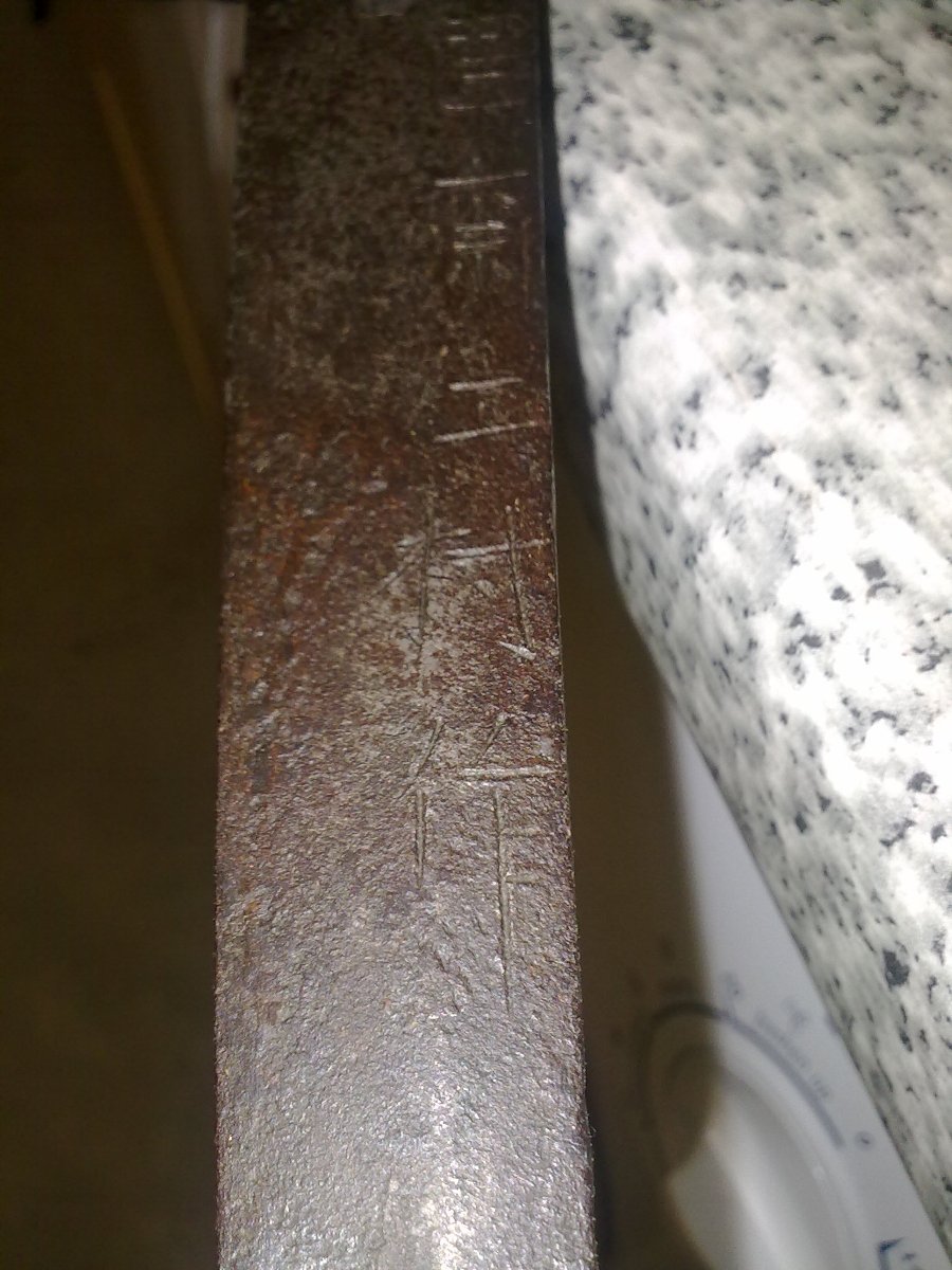

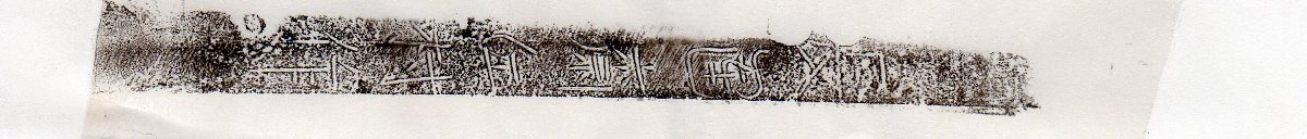

When I sent it away for restoration, I took a rubbing of the tang. The signature is similar to the second picture above, but it's got more characters on it.
Please forgive the quality of the pictures. My camera is pretty basic. I tried to use the highest settings, so you could probably save them and zoom in. I tried to get a picture of the hamon, but I'm not sure how it'll turn out.
Meant to mention in the first post. The restorer said that there's a couple of holes in the tang. This is supposed to mean that it's been remounted more than once.
Many thanks again. Hopefully these pictures will help get more information.
Francis.
The mei is a bit of a mystery...as the sword was "lying on a building site" and was abused and deteriorated, it seems that it has been around since the war. It is not likely to be a gimei (deliberately false signature) as it would have had to be done either at the time when Emura was working or sometime in the last 15-20 years when he has become "known" again...and the condition seems to rule against this. As he was just one of many competent gendai tosho it does not seem that there would be any money to be made from "forging" his signature, either then or now...so it is probably, as has been said above, one of his sakite who signed it. He is known to have had his mei done by his apprentices/students (all convicts at Okayama? prison forge I think). I would consider this a workshop variation, unless it is proven to be a later forgery.
Regards,
George.

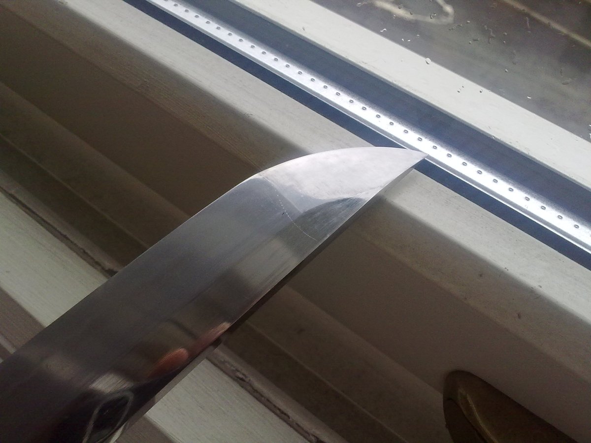

Francis

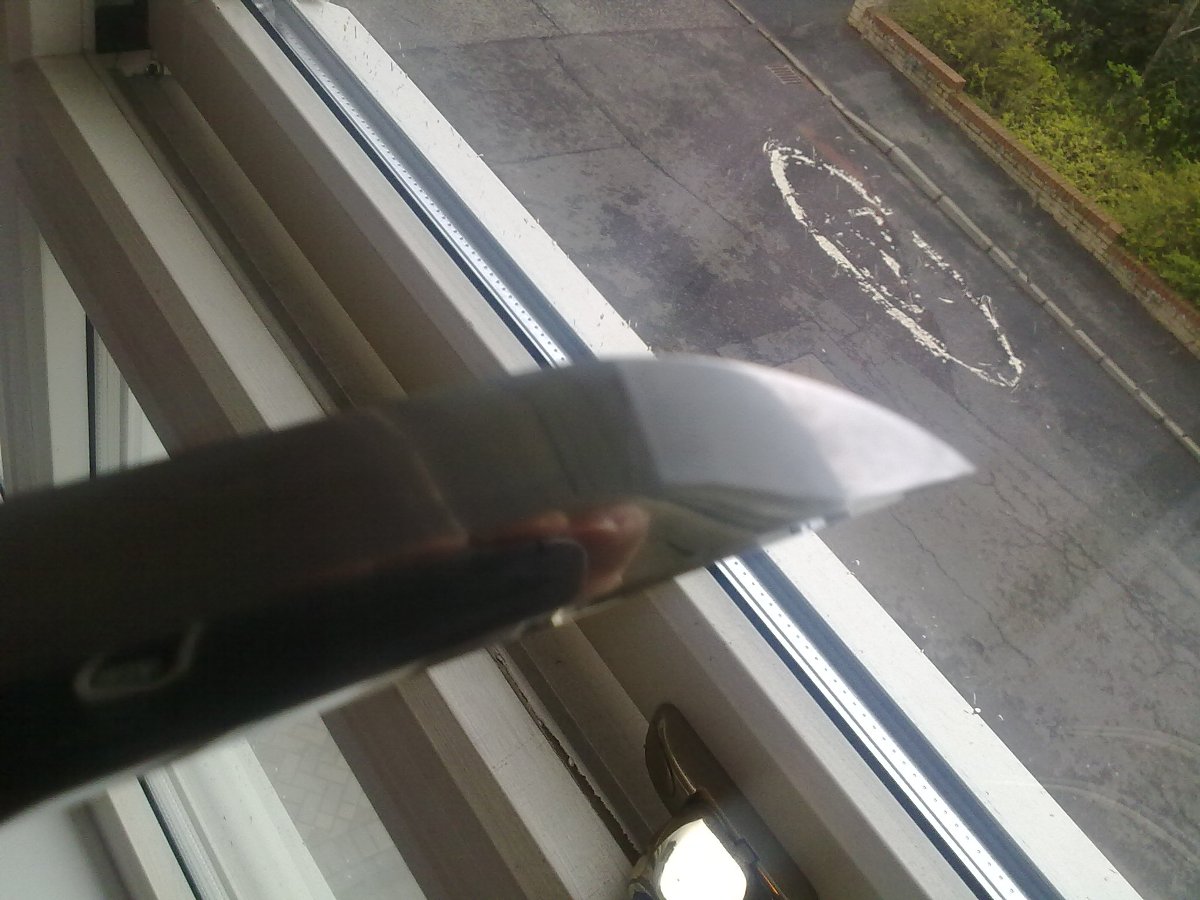

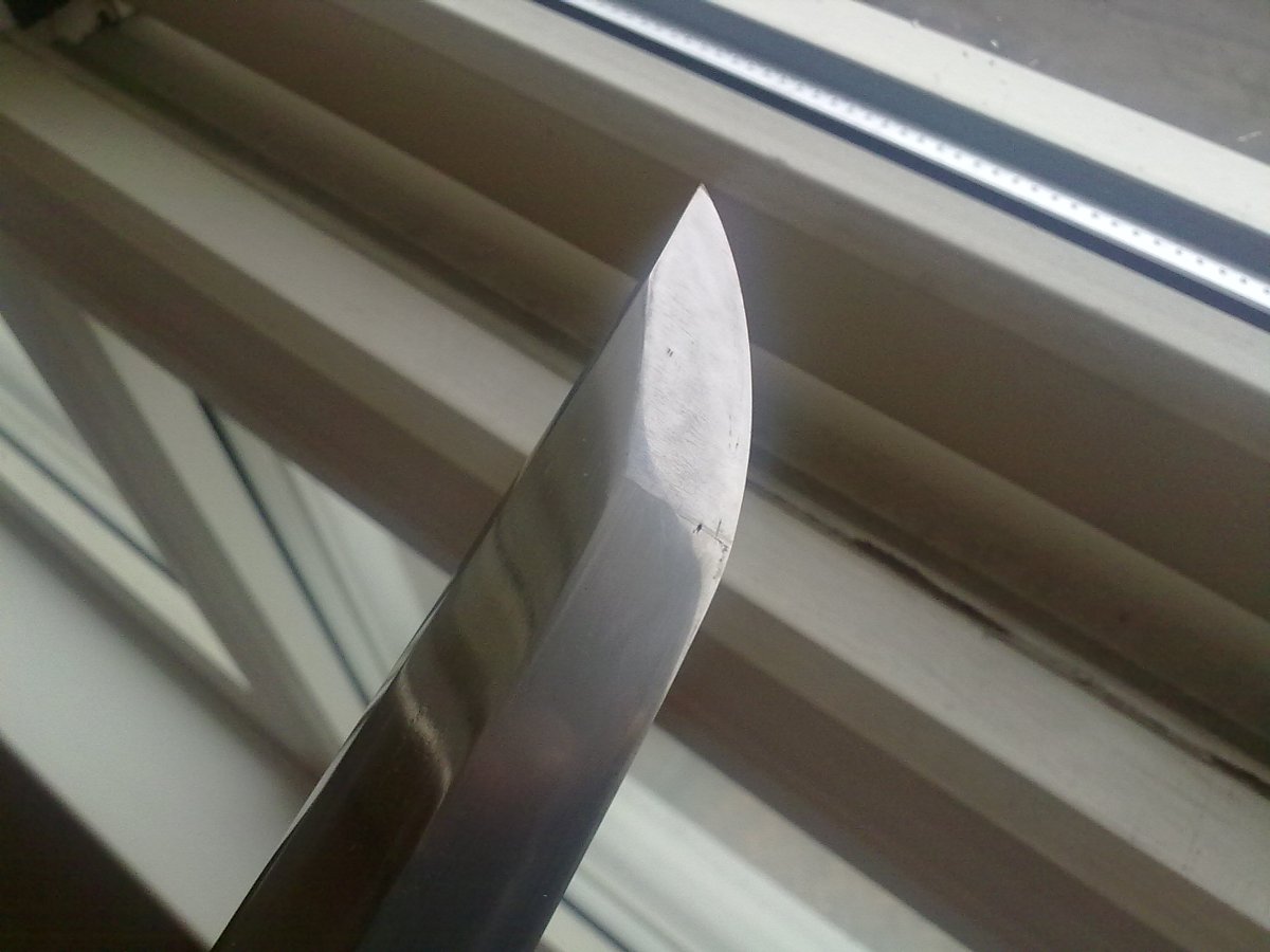

Could you take some close up shots of the kissaki and blade. This might give a better indication to it being a workshop blade signed and perhaps forged by an inmate.Regarding the removal of the wooden handle it is a simple process,read sword care and handling top of page.

Dang...I think I've confused the mei on the original "Chounsai Emura" sword query by FrancisP (mei not shown yet...found on building site) with the "Emura Saku" mei posted by Cisco-san (brown "awkward" mei). Sooo...please disregard my answer as it relates to neither sword/circumstance.
Geo.

Well, Francis, I don't think there is any mystery here, your mei looks like a close match with Mei A and D on Rich Stein's "Chounsai Emura" discussion paper...see it through the link to Japanese sword index above.
Probably a good place for Cisco-san to check his mei also.
Regards,
George.
I'm really surprised you had what must have been a very expensive polish if it was done traditionally and resting saya made for an emura blade! Since it is an emura and doesn't look particularly unique, would I be correct in guessing this wasn't done by a formally trained polisher? (I would also be very surprise if one accepted it) Also, the pics are pretty blurry, so while the saya looks very decent, I honestly think the pics make it look like the polish is very rough with lots of scratches....

It wasn't all that expensive to have the polishing and saya done, the pain in the bum was having to wait nearly five years to get it back.
Not being an expert in swords, I wanted to see what the blade was supposed to look like and I reckoned that it was a fair gamble to fork out what was required to get it looking something like normal.
The pictures don't really do it any justice. I've only got a 2Mp camera on my 'phone and they don't give a lot of detail of the hamon and the hada seems alnmost non-existant.
I only really wanted to own a real Japanese sword in reasonable condition, so making money wasn't part of the plan, that's why I wasn't bothered about the outlay.
First off, I enjoy collecting gendaito blades and I give you credit for taking on the cost and the 5 year wait time (which I believe is extreme for this type of blade, or most any normal blade TBH). That being said, I think it only honest to say that your time and funds might have been better spent elsewhere? Emura blades aren't exactly "real Japanese swords", unless possibly forged by Mr. Emura himself. They're more gunto than gendaito. I'm was really surprised when I heard you went through the whole polishing/saya making process because of the cost and this fact. You possilbly would have been able to pick up a decent "real Japanese sword" for the price. Did some one advise you to do this with the emura blade?
I've been told one reason to stay away from ww2 blades is because one needs to view quality blades to get an eye for quality work, and ww2 blades normally don't fall into that category. To this end I do stick with collecting yasukunito/mina-to, but have been tempted to collect other forms of "gunto" for the history aspect. The history/era/use of ww2 swords is important to myself, since I am not yet an art conissour of nihonto. Through study, I hope to be able to develop my eye for nihoto and begin collecting "nicer" and older blades.
The emura blade appears to have been a great learning experience for you. B/c it doesn't quite fall into true "nihonto", you may want to see if you can exchange it for something more worthy of study if possible. Again, I would be really shocked to hear if anyone here advised you to go this route. But since you appear to really appreciate nihonto, the best thing would be to get something better to study.
