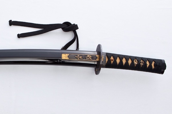

Hi all, I am looking at a wakazashi by Harima Daijyo Fujiwara Tadakuni with a cutting test. It has a Suguha hamon but on one side the hamon looks strange. The photos are from the Auction house its on March 22nd. Has someone seen a Tadakuni with a change like that on one side at the machi ? also it looks like Orikaeshi-mei from the photo ? thanks Jim
Hi Clive,Barry, Sorry Clive looking again its not orikaishi-mei (should use my glasses :roll: ) but have not seen a Tadakuni with a hamon like that. Barry is your Tadakuni Suguha ? also what do think is on the blade some coating maybe ?
Jim

Here's the full description :
A Japanese wakizashi by Harima Daijyo Fujiwara Tadakuni, Hizen school circa 1664.
The blade (511mm) with ko niedeki suguha midare hamon. The tang with single hole and engraved signature
Kawachi Kami Fujiwara. Additionally engraved to the opposite side of the tang
and inlaid with gold is a Kinzogan mei (cutting test) performed by
Yamano Kauemon Nagahisa, the official tester for the shogun Tokugawa Ieyasu.
The test was performed on 11 june Kanbun year. In black lacquer saya. The hilt, silk
bound rayskin covered, with Mogarashi school shakudo/gold menuki of samurai on horseback and in a boat.
The fuchi carved as woven basket work overlaid with gold and silver blossom.... Overall in saya 710mm.
Estimated price : $22,000 NZD so about 11000€ (so for people with reasonably deep pockets)
Hi Clive, This is a interesting blade, the only thing is its hard with so so photos.and no closeup of the strange end to the hamon.and the patches.and no Paper, but looks good,its something to think about :? I also have a Katana by hizen Jyu Harima Kami Fujiwara Tadakuni AD1663 it has a Tight ko-tame-hada,and ji-nie in Gunome-choji (It seems that Tadakuni had many influences and a great talent, and studied in several places.) yes :!: he has made me a convert, :D but I am seeing a lot more Suguha blades ?did he do others types than the large gunome,and Gunome-choji ? (and studied in several places) I remember one what was the other? thanks

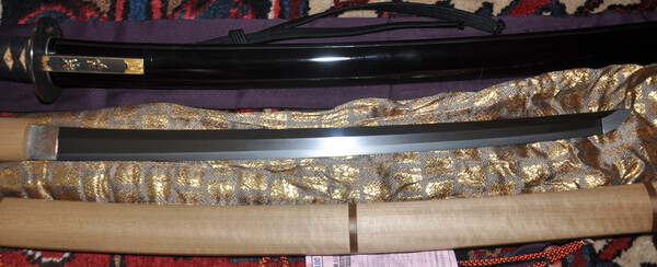

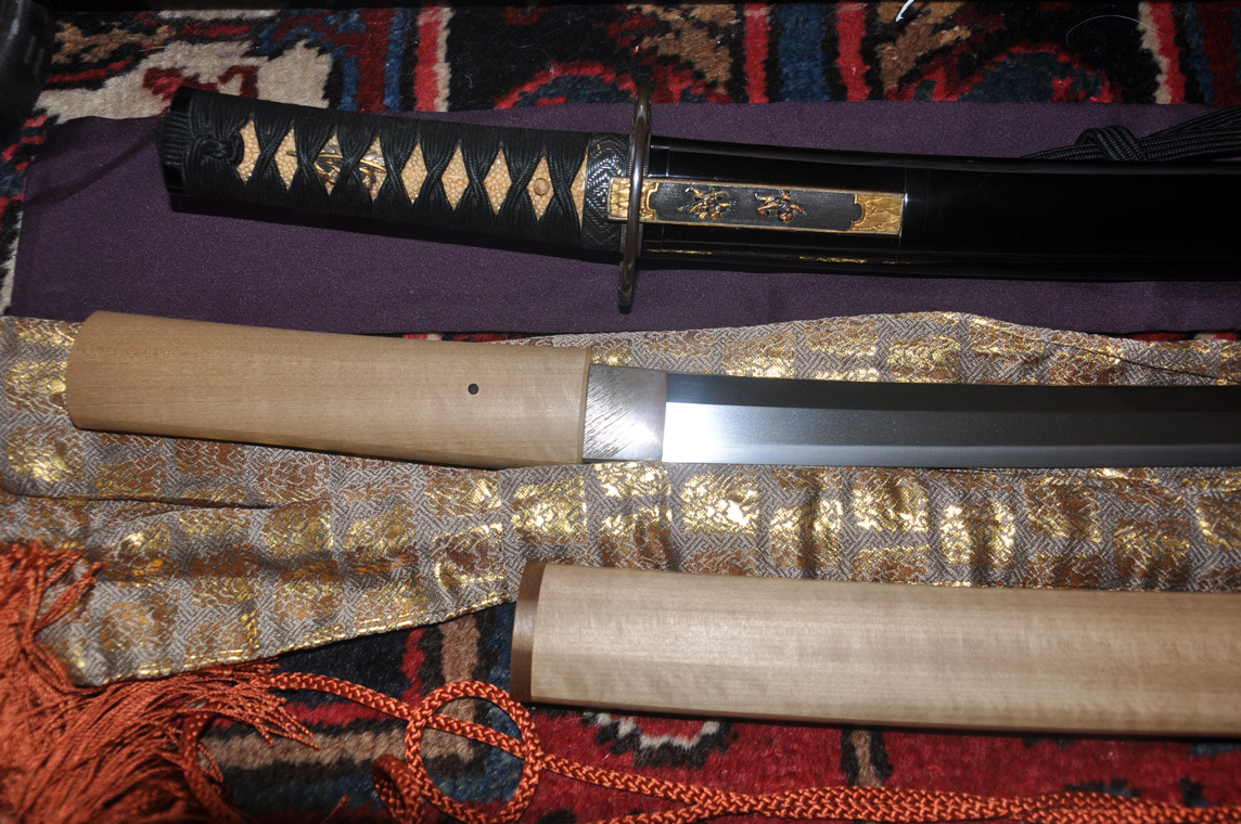

Hi This wak was sent to Japan for polish and papers. The sword papered shodai Tadakuni Tokubetsu and the fittings Edo era Hozon. The hamon looks perfectly normal on both sides in polish.The sword beat the papers back to the USA, I will try to post the papers when they arrive. I tried to post pics but the images to big, to many pixels. My camera was set at lowest detail. The forging looks awesome........looks like Masahiro or a Tadahiro. text book Hizen hada and hamon. If anyone wants pics I would be glad to foward any requests. Just email me at binheadkiller@aol.com .......Mike. Thanks have a great holiday.
Thanks Jim, I sent you all the pics. Also for you that are Facebook members I have some Tadakuni wak pictures posted there.....search for Mike Canaday in Ohio, look under swords in my albums. Hopefully Jim will be able to post some here for us.
